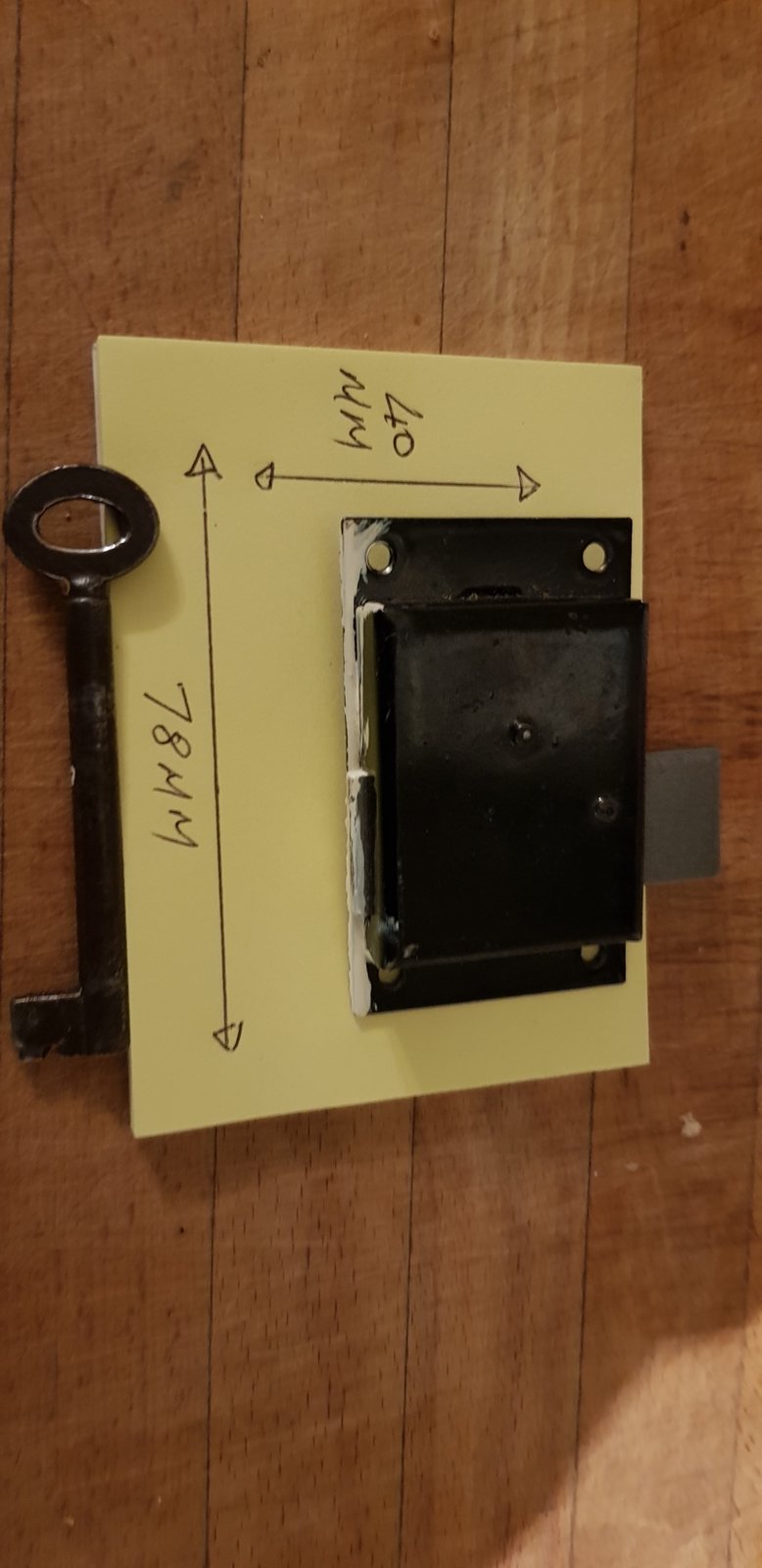

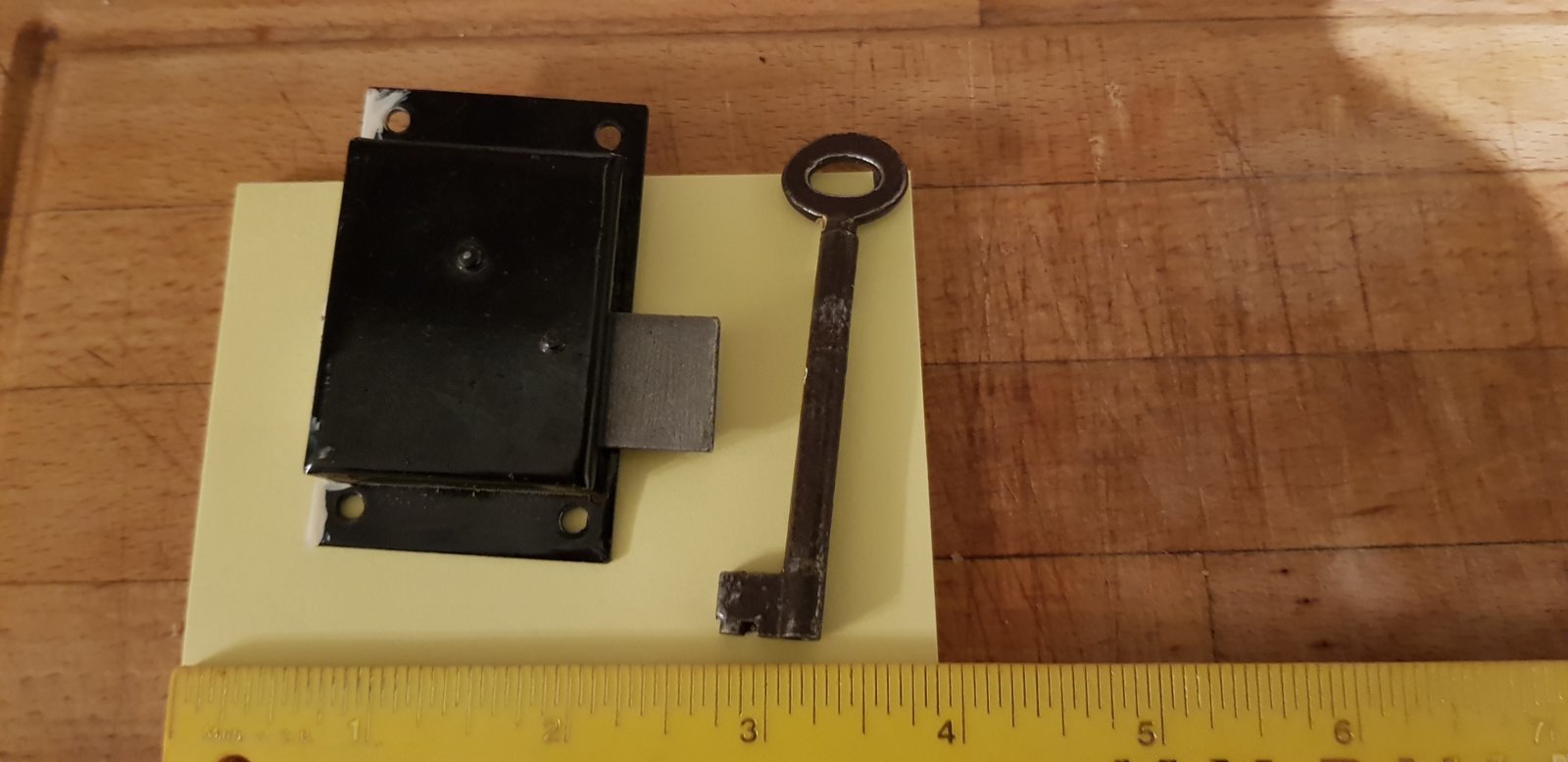

Does anyone know what this type of lock is called?
They are from cupboards, circa 1950

It looks like a straight cupboard rimlock
(not a cut cupboard lock, which is fitted into a recess in the back of the door.)
Looking at the key yours is probably a warded tumbler lock (no levers) and is not remotely secure.
The pressed steel ones are usually very cheap and poor quality. The brass ones are usually a bit better.
If buying them for existing furniture, the most important measurement for you is the backset (distance from centre of keyhole to edge of door). The height and width of the case don't really matter.
https://www.locksonline.co.uk/Cabinet-Locks/Cupboard-Door-Lock.html
You might find some New Old Stock "Union" ones on ebay, they used to make a wide range of decent little locks, including a 4-lever range that were very good.
https://www.uniononline.co.uk/en/si...cks/cabinet-locks/4146---lever-cupboard-lock/
