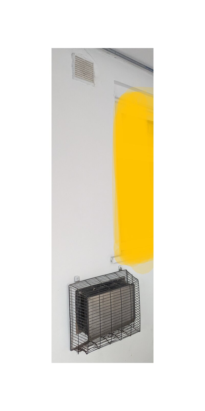

What is this?
23 Oct 2023
2

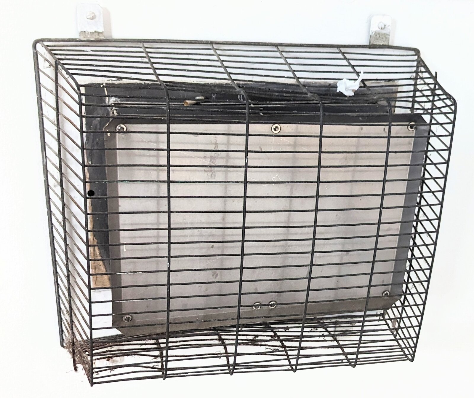

Does anyone know what this is and can it be removed? Thanks
It looks like a balanced flue to me, but you provide no dimensions, do not say where it is, and do not show what's around it.
Perhaps there used to be a gas heater or boiler nearby. Or an extractor fan.
Thank you for your replies and sorry for the lack of information, the dimensions are approx L45cm x W15cm x H35cm.
It's located no where near my boiler but on the external bathroom wall. Extractor fan is higher up.
Also adding that my neighbours are using it as an ashtray! Ideally I would like it completely removed
It's an old boiler flue. If there is no boiler on the end of it, it's redundant and can be removed and the wall made good.
