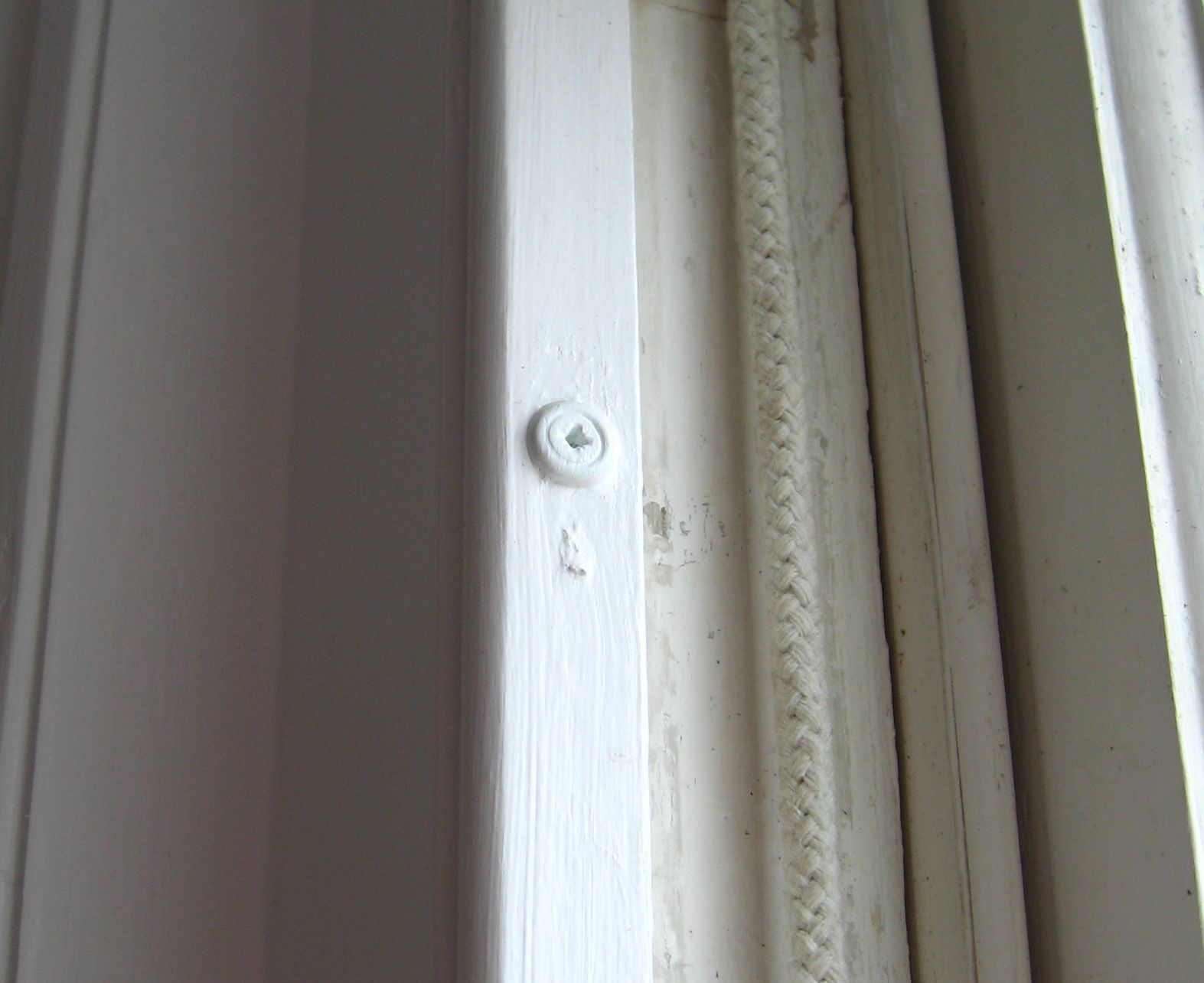

Does anyone know what the rings are called that screws are put through so that they can be removed ??
Picture attached.
Cheers
Cup washers. Cheap ones are a flat piece of metal, pressed into shape, so the underside is hollow...
Decent ones are solid...
Depends what you need them for really.
Thanks !!!
The idea (as I was told) was that the beads on the side of the sash window could be removed in the future more easily for maintenance of the sash weights, hence he put in those things. Not sure if there are better removable fixings.
I suppose a cup washer on top of a painted wooden frame means you could remove it without damaging the paint, but they've been painted over now, so that no longer applies.
If they're just sash box beads, they don't need any significant strength. You'll need to take them off when the cord breaks.

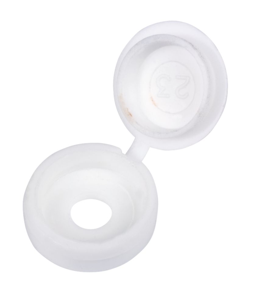

IMO the plastic covers would look neat enough with white paint, as long as the domes don't fall off. a pack of a hundred or so is very cheap.
