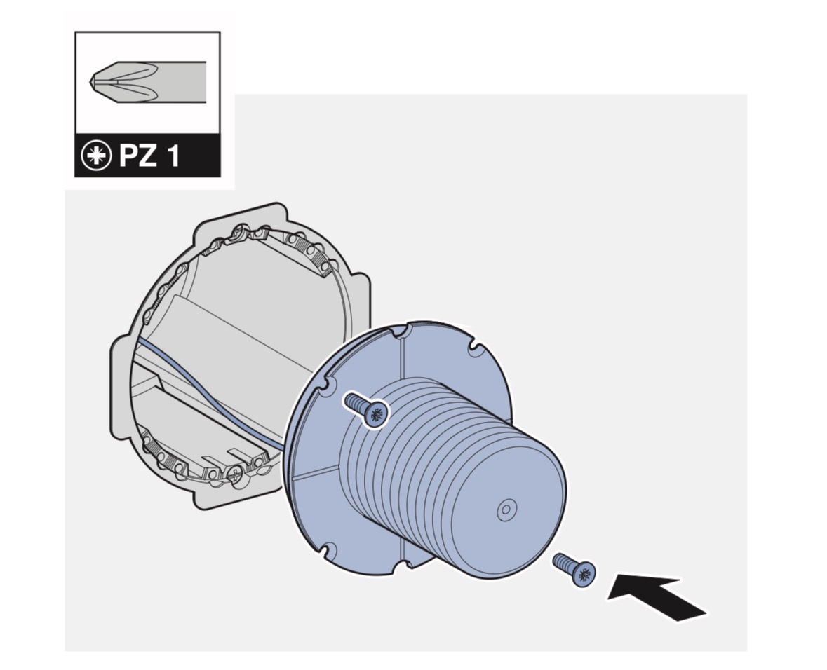

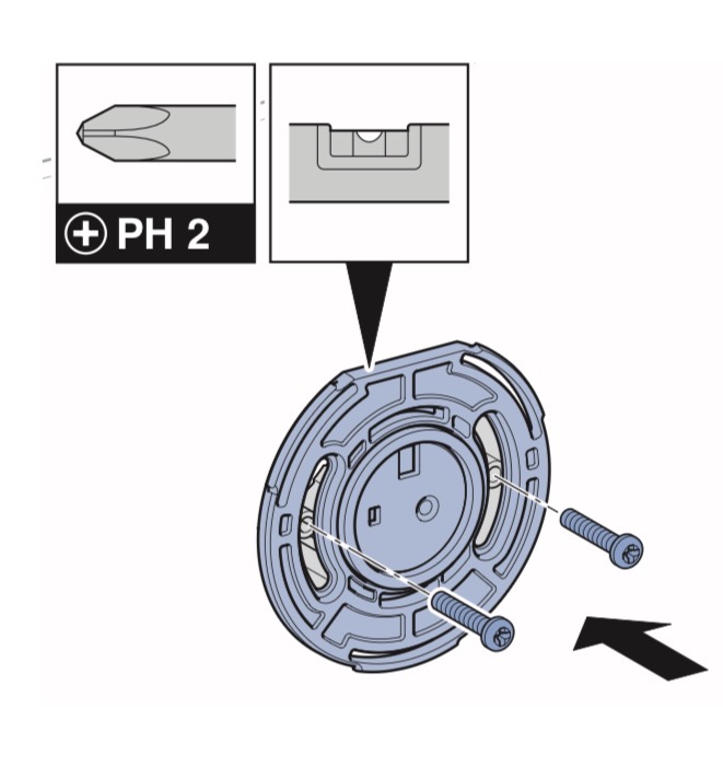

I have the following two screws pictured below and the instructions say to put the PZ1 screws in one section and the PH 2 screw in another. I can’t tell which screw is what. I tried putting a pz1 bit on both screws and the pz1 head sits firmly on both so I’m even more confused. Can anyone help identify what screw is PZ and which is PH? Left to right ?
They both look like PZ screws.
That’s even more confusing. It’s a Geberit Infrared touchless flush sensor back box system that I need to install and it comes with 4 screws. Two short ones and two long ones and the instructions are illustrations only and I’ve attached the two reference it makes to the screws.
I’m assuming I need to go based on length maybe but it’s hard to tell which screws in the pic are longer lol
One is shown as pan head and one countersunk in the illustrations. Go with that, it is what you have in your hand.

If you look at the 2 diagrams the driver heads are actually drawn different!
The first pic to my eye shows the shorter one and the countersunkhead. You should see a countersunk hole in 1 location which would provide another tell.

I always thought pozi screws had the little line between the head slots for the driver. So thise both look the same i.e. pozi
You are correct.
