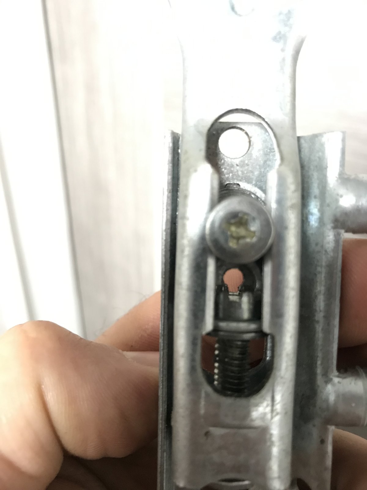

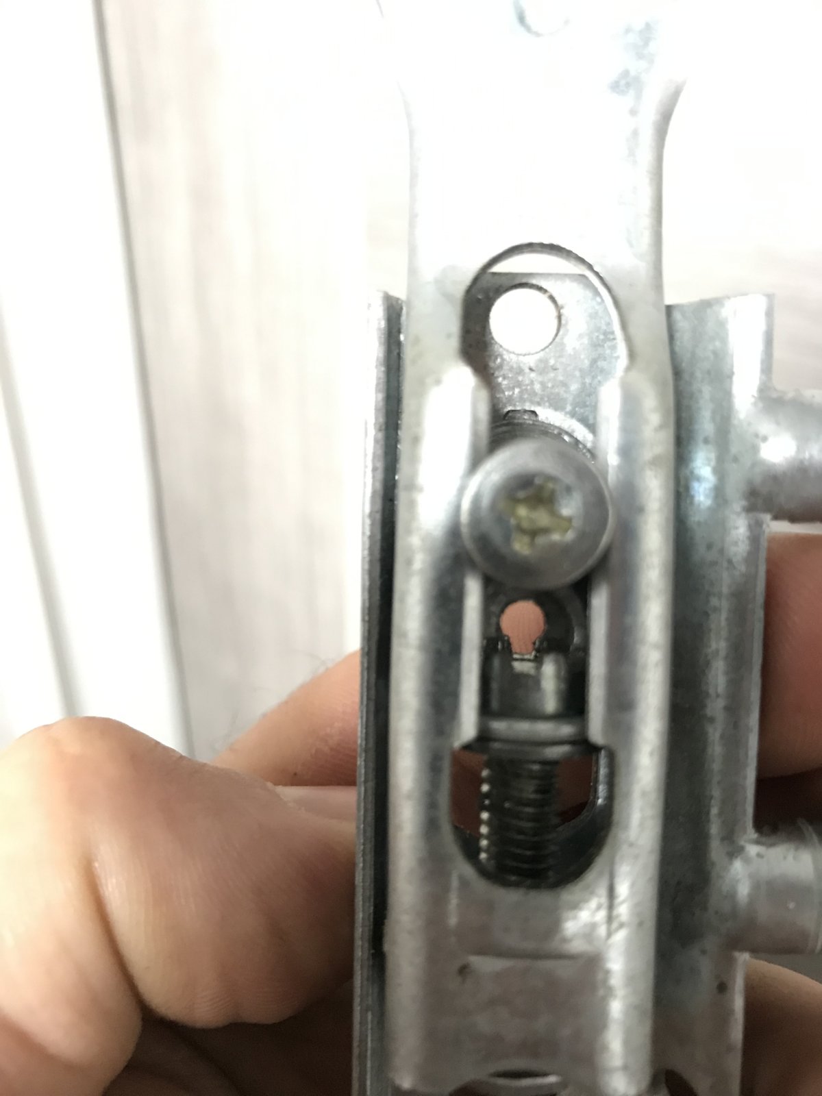

I'm slightly going mad trying to operate the vertical adjustment for my DIY Kitchens wall cabinets. They look to be fairly standard, so wondering if I'm just totally overlooking something obvious.
I think the hardware on the back of the cabinet is a "Traser Rapid 6" - if not, then it is very similar in appearance. Video of how it supposedly works here:
As you can see, once hung on the wall, you can access the hardware from inside the cabinet to adjust the tightness of the cabinet against the wall; and adjust the height of the cabinet on the wall. Tightness to the wall is via a normal cross-head screw. This I can do fine. Height however is adjusted by inserting a screwdriver into a hole which leads to non-standard screw, positioned at 90 degrees with little teeth on top. I presume the idea is that the screwdriver edges catch the teeth and result in the screw turning.

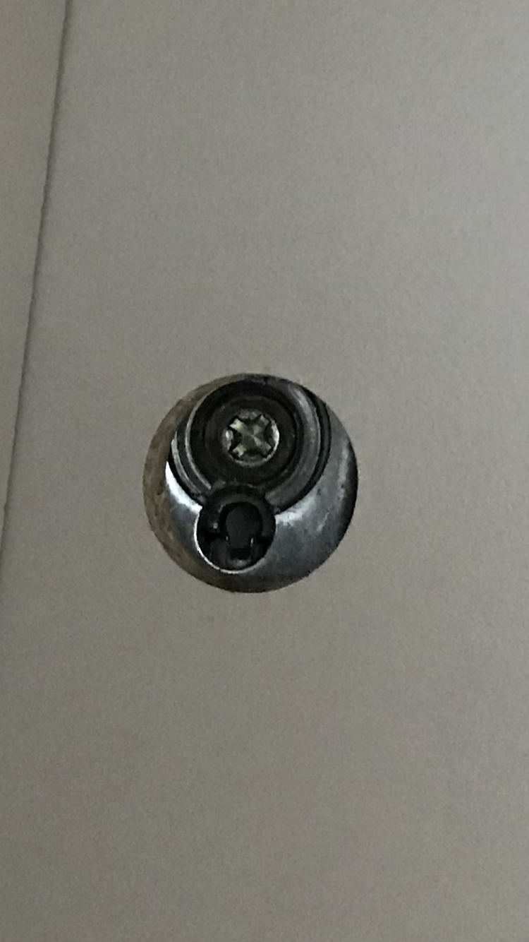

Take a picture of the actual screw head?
The PH2 or PZ2 should work looking at the pictures on the pdf... Can you take the weight off the cabinet whilst you adjust it? Does it work with the cabinet off the wall?
I would try it with a bog standard PH2 driver - Those wera drivers sometimes have funny gripper bits on them
It is a ph2 or px2 but the bit on the unit is more like the top of a castle wall than a normal X.

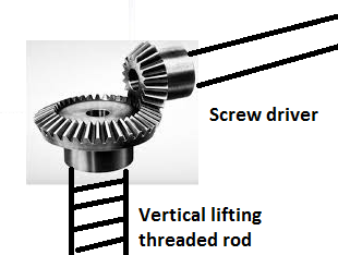

The vertical adjustment works like this
except that the "gear wheels" in the bracket only have 4 teeth so very hit and miss whether the "teeth" on the screw driver engage properly with the "teeth on the vertical rod.
As SpecialK said take the weight off the supports when adjusting the height so that there is no load for the " gear wheels" to have to lift when turning..

That's pretty stupid of them, Phillips and Pozidriv are not the same and not compatible with each other. You are liable to bugger the screw head, and then you really won't be able to turn them. Because the adjustment screws are right in the corner/edge, it is much easier to use an extra long screwdriver, so that the handle is outside the cabinet, I bought some 450mm screwdrivers for exactly that purpose. Therefore you're keeping the screwdriver shaft nice and perpendicular to the screw head. Going 'off angle' also buggers screw heads.
Show us a piccy, that PDF you linked to shows a Pozidriv head BTW.
I'm not sure what "Ø6" means
The diameter of the shaft of a number 2 screwdriver(either Phillips or Pozi) is 6 millimetres. They have just used the wrong, but very similar character for diameter.
Looks large enough to need a phillips no3 to turn.?
No, that’s it from the back, it’s deffo a No.2 but not a great fit. It would probably be better with the first few mm grinded off.
Thanks, I managed to do this finally with a PH2. In fairness it turned relatively easily, I must have not had it properly aligned when I tried previously. All up and levelled now :) Thanks for the help.
