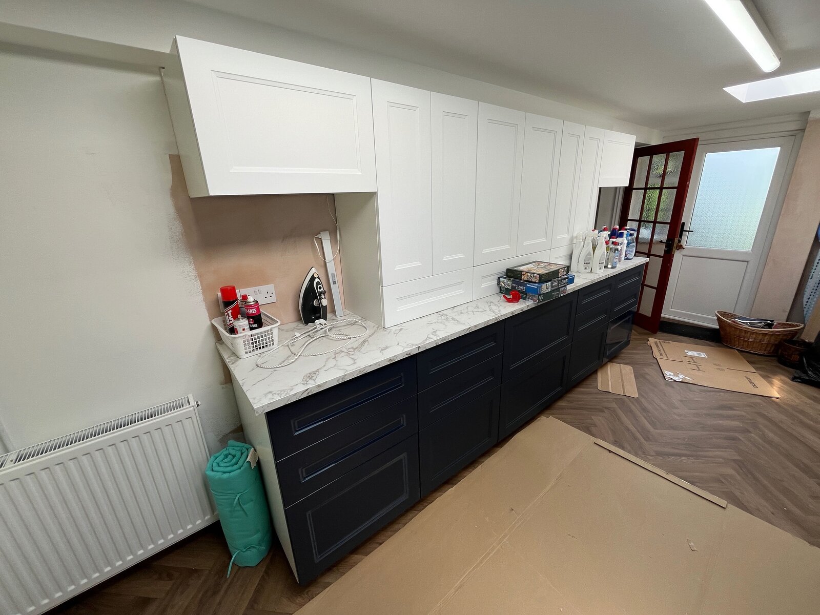

we have just fitted 3 IKEA 1m high wall cabinets - sitting on a worktop
the 60cm wide cabinet with 2 30cm doors - 1 door is quite higher 0 I have tried to move the hinges down - BUT there does not seem to be any adjustment or movement
anyone had this experiance and how resolved
as its just a utility room, we are not that bothered - BUT i do want to fit the knobs and then i will have to put it on lower on the door - so the knobs are all in a line

If one door is higher, why not return it? Or have I miss read your post?
misread the post - it was the adjustment - I thought it was the mounting screws had to be removed and the hinge moved - like lots of other hinges i have used
BUT there is a middle screw which adjust the door height - SO all fixed now
