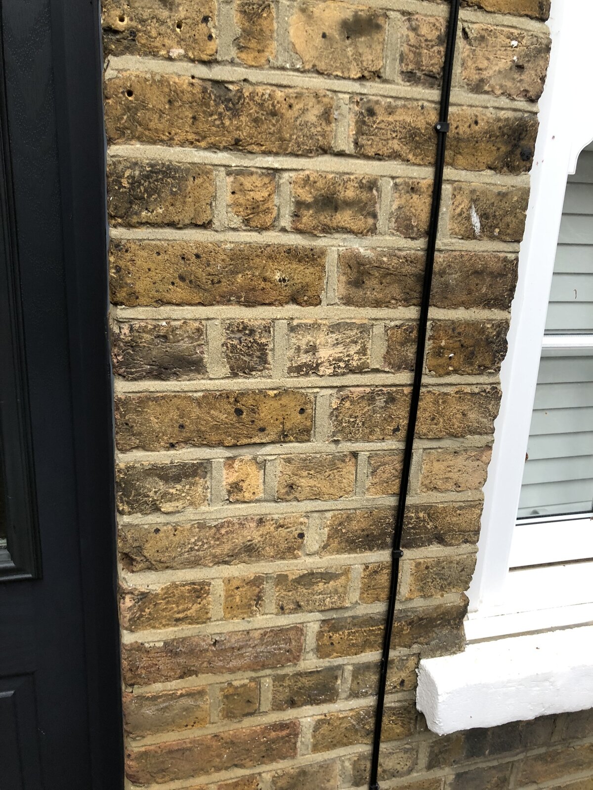

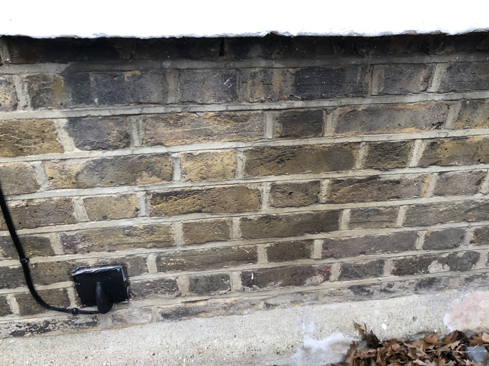

Hi all, I need to repair/repoint some mortar around a hole where I drilled for ethernet cabling that has since been moved, and I want to ensure I match the mortar colour.
The property is ~1900 terraced. Would I be looking at just regular cement mortar, lime mortar, or do I need a specific colour to match?
Additionally, if anyone has any insight into what type of brick/colour these are, I am trying to get some dust to cover a separate hole in the brick from a wall plug?
Thanks!

Sand/cement (re-pointing) using a light coloured or rinsed sand.

The bricks have the appearance of yellow London stocks
(Sourced from Thames mud, I believe)
Which are fairly soft. Very common around the age of your house in parts of London and nearby. 10 Downing Street is built with yellow bricks but they have been painted black to reproduce the appearance of an old building stained with soot and pollution. The mortar is painted white.
There are plenty of old ones available from demolitions. They are often pockmarked with little blow holes so modern bricks would not match (also size is different).
I think your house was probably built with lime mortar but it looks like it has been neatly pointed with cement and fine building sand, so using the same will blend in
Perfect - that figures too since I am in SW London right by the Thames! A brief look on FB marketplace shows some promising matches for reclaimed bricks from which I could get the dust. Cheers.
