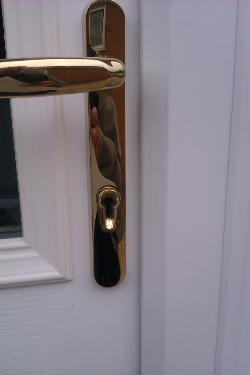

I have recently seen a few of these locks in doors, but never been able to find a supplier or even a description of exactly what they are. Any clues world be helpful.
Looks like a standard euro cylinder. There should be a screw visible on the closing face of the door that secures the cylinder.
Maybe its a poor photo. The external shape looks to be euro, but the key hole looks very different. It's recessed into the outer shell and appears to have rubber shields so I could not see the actual key hole. A normal euro style key looked too big.
I could not check as I do not know the people who lived in the house.I saw a few of these locks when delivering leaflets recently.
Its a newish product some lock manufacturers are making, the one that springs to my mind is the ERA Vectis...
http://www.era-vectis.co.uk/index.html
Click on downloads and it'll show you the set up
You see it a lot on composite doors like the one you took a picture of, eurocell offers this on their doors as i'm sure others do as well
