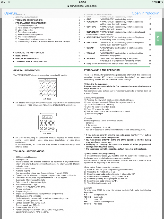

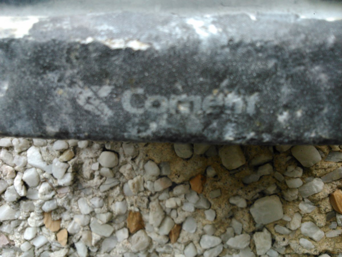

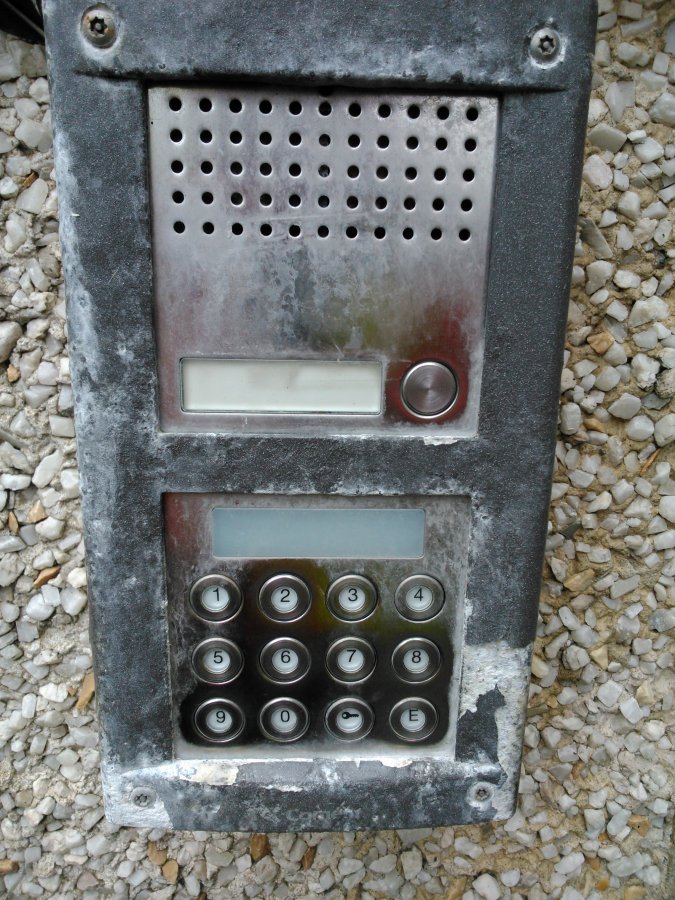

what make/model is this door intercom?
5 Mar 2008
201
Antrim
Hi guys,
I need to change the access pin number on this door intercom but I don't know what make it is and I don't know how to change the pin.
any ideas?
thanks

Anyone got a spare panel security screw key kicking around?
Just discovered the screws aren't ordinary security torx screws :confused:
Might not get them out anyway die-cast panel fairly corroded?
Those are no good sparkymarka, I have a set and tried them, the comelit screws are a unique fitment.
Comelit gave me a part number and I've emailed a few comelit suppliers, so far I've had no success.
part number is: 2C61000010
I'll keep trying.
No they are not , standard torx with security pin took one apart the other week to change the code , but I've got to say I've got a larger set with more bits
