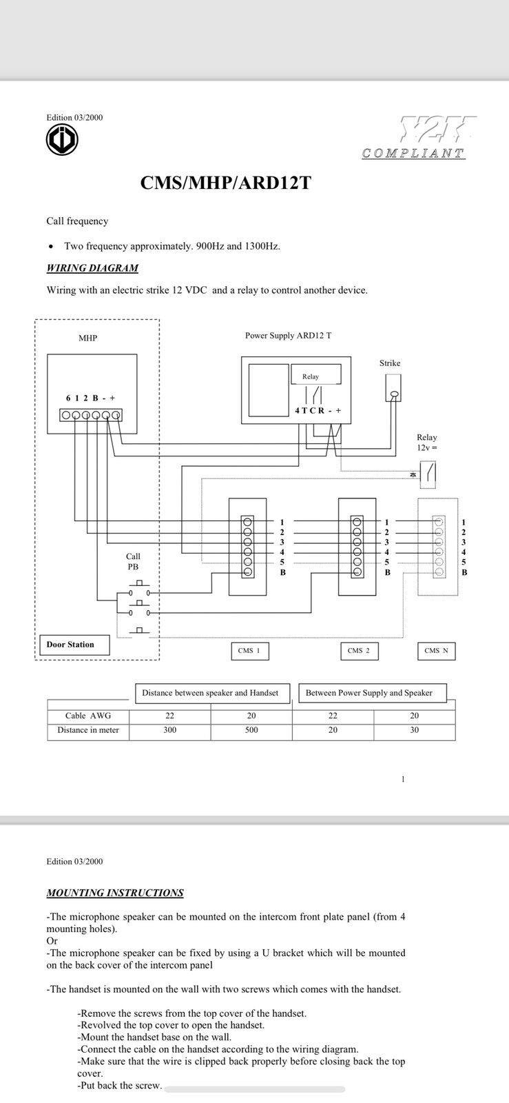

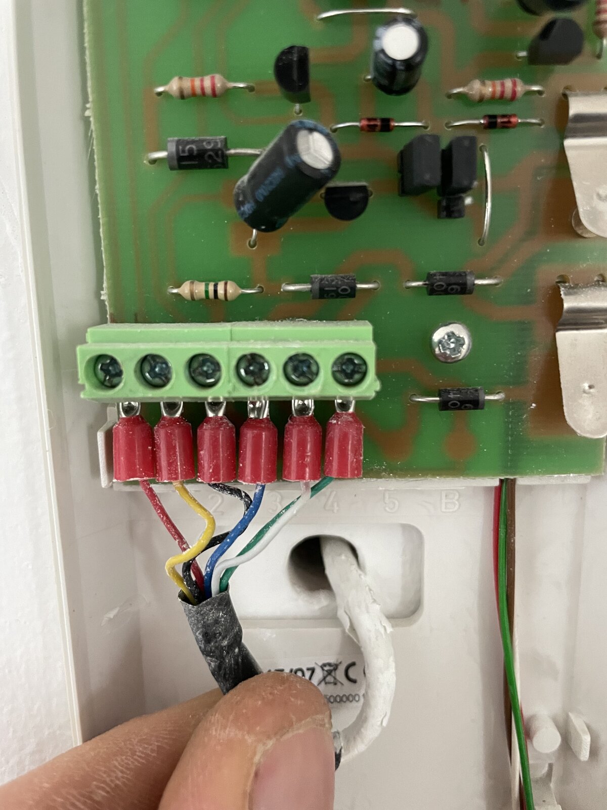

I’m doing some work on flat and the existing handset for the intercom and door has been thrown away accidentally.

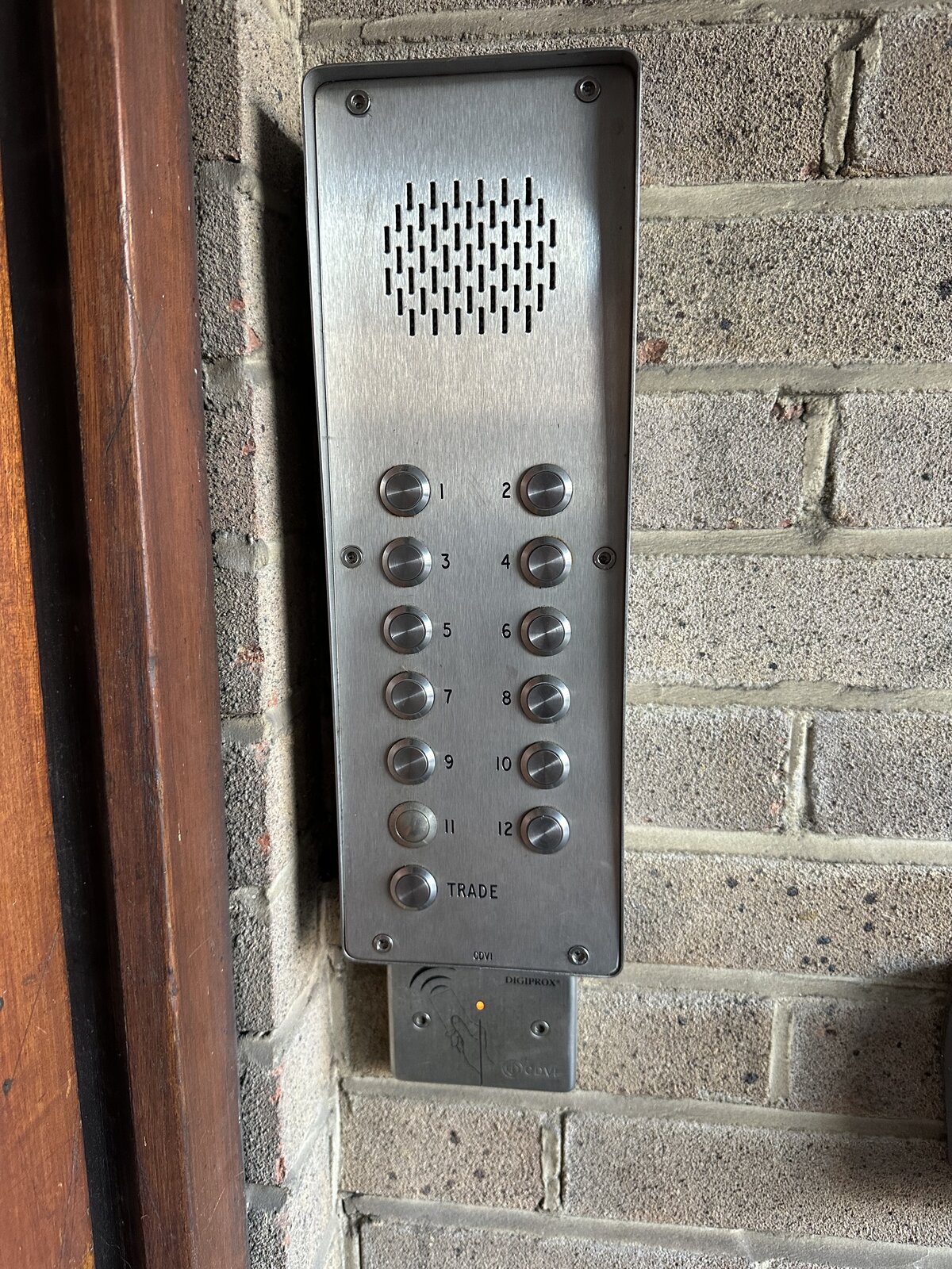

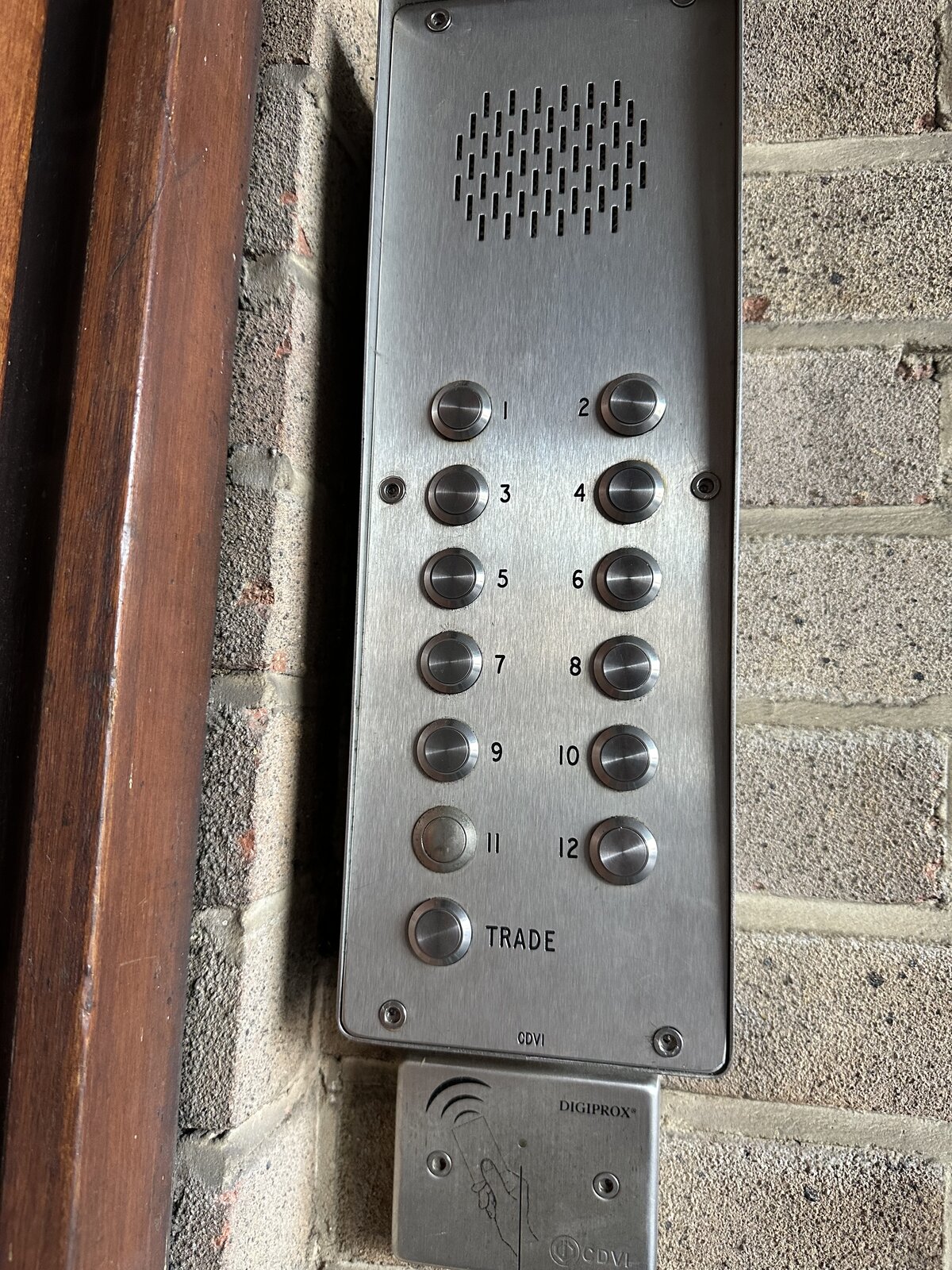

I need to replace it but can remember the brand or model number. I have some photos of the inside of the handset and the intercom by the entrance door which is CDVI- do you have any idea which product would be compatible?
The part code for the phone is CMS/U made by CDVI
Many Thanks

Post picture of ….handset fully ….and speech unit of the inside of the door entry panel …
I will get a photo of speech unit of the inside of the door entry panel

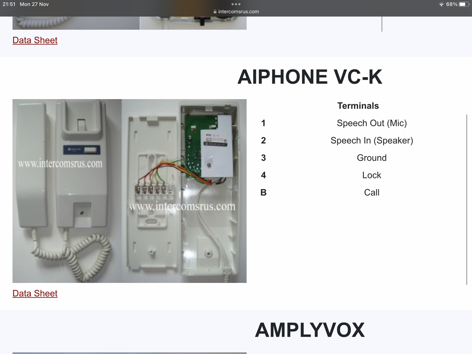

I could be wrong on this ….but I seem to remember CDVI using AIphone VCK handsets at one time in their own systems , when you look at the numbering for a VCK it seems to match up …see below
