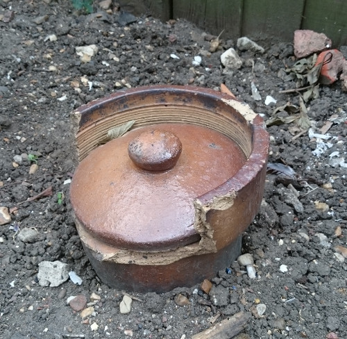

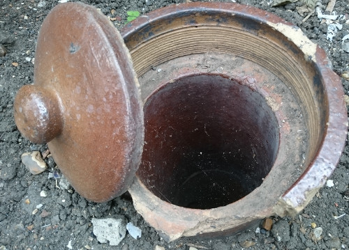

Can anyone explain what this ceramic inlet/outlet is?
Top is about 9" in diameter and leads to series of vertical ceramic pipes. It is located about 11 feet from the pavement appears to be connected to the waste water (when I empty the bath you can hear rushing water and faintly see rippling water at the bottom. Haven't measured the depth of pipe but I would say around 12-18 feet. Property is late Victorian.
So can anyone tell me what this is called and what it's used for? (n)
Its a plunge point for a water trap that's beneath it.......a sort of an interceptor trap design.
Google interceptor traps and you'll see what I mean.
John :)
Thanks for the quick responses (y)
Wikipedia (so it must be true(!)) suggests that interceptor traps, disconnecting traps and Buchan traps are alternative names for the same thing.
https://en.wikipedia.org/wiki/Buchan_trap
Apparently the Victorians thought cholera was an airborne - not waterborne - disease, so these traps were designed to prevent sewer air entering the house via the waste water pipe.
In my specific case I think it's a stand alone interceptor trap "commonly found before the drainage system crosses a boundary line". Apparently we are lucky the plunge shaft is still accessible:
"i have optimistically shown the plunge shaft rising up to surface level though in reality this is seldom the case with gardeners, landscapers and drive layers burying or concealing the access shaft."​
