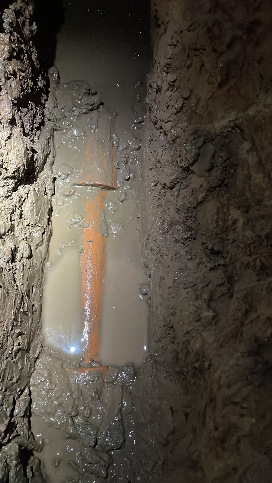

Today we went under the floor again, this time with the idea to put a hole-y bucket into the hole with a submersible pump to pull the water out more easily. We needed to dig the hole a bit deeper to get the bin in and when we started digging we got down about 2 1/2 feet and suddenly hit a clay pipe!
Now this clay pipe is much smaller than a waste clay pipe, probably 25mm diameter. And weirdly it seems have 40mm lengths and then a collar, but the collar is not tightly fitted. In fact you can spin the pipe around in the collar and move it about. It like it’s not meant to be sealed. Now bear in mind this pipe has nothing to do with our water works (water in or waste out). I’m now totally confused and wondering if this pipe has something to do with the dampness inflow. Possibly as well as the soil pipe issue we have now fixed. It also seems crazy that there is a random clay pipe so far beneath the soil.

This is the pipe we found at the bottom of our hole

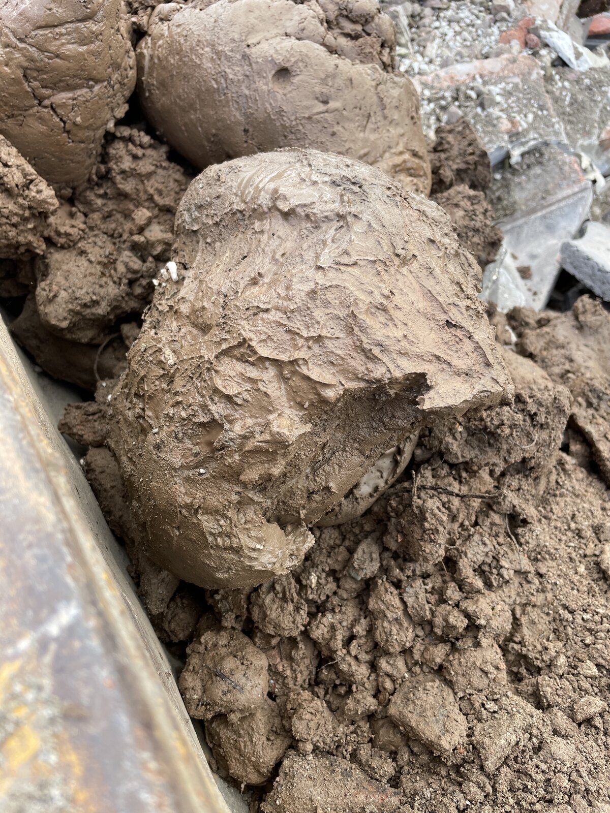

This is the clay soil once dug out. You can see how wet it is.

2. The recently discovered clay pipes could be drainage tiles for draining ground water - they were laid loose fitting in short lengths. But who laid them, when?
3. Drainage tiles end by discharging into a sump or a ditch or a stream, and occasionally (& very illegally) into a manhole.

5. It might be expensive but tracer cable can be inserted into the tile . The tracer will show where the pipes come from and go to.

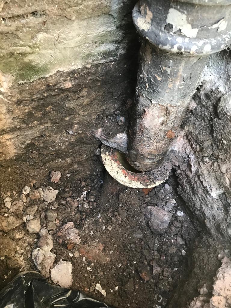

This is a photo of the old transition before it was fixed. The clay in this section has now been replaced with plastic and we’ve tested to ensure it’s no longer leaking. The site of the puddling is about 6metres from here under the house.

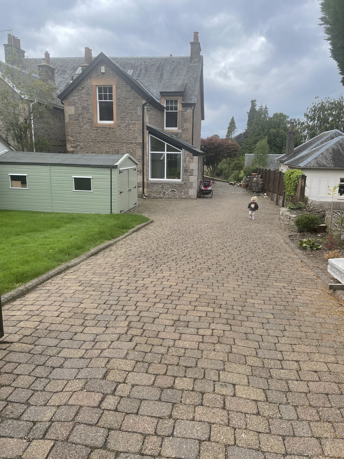

Yes it’s on a slope, not massive but from the driveway it runs downhill towards the house

The downhill position of the house suggests that you will always have excessive ground water, & that the drain tiles were laid to relieve the excess.
A long term observation is needed but it could be that you will have to channel the sub-area soil to a pumped sump?
I dont see any air bricks in the pic.
You have a number of gullies - where are they draining to, and where are they tying in needs a drainage map.
