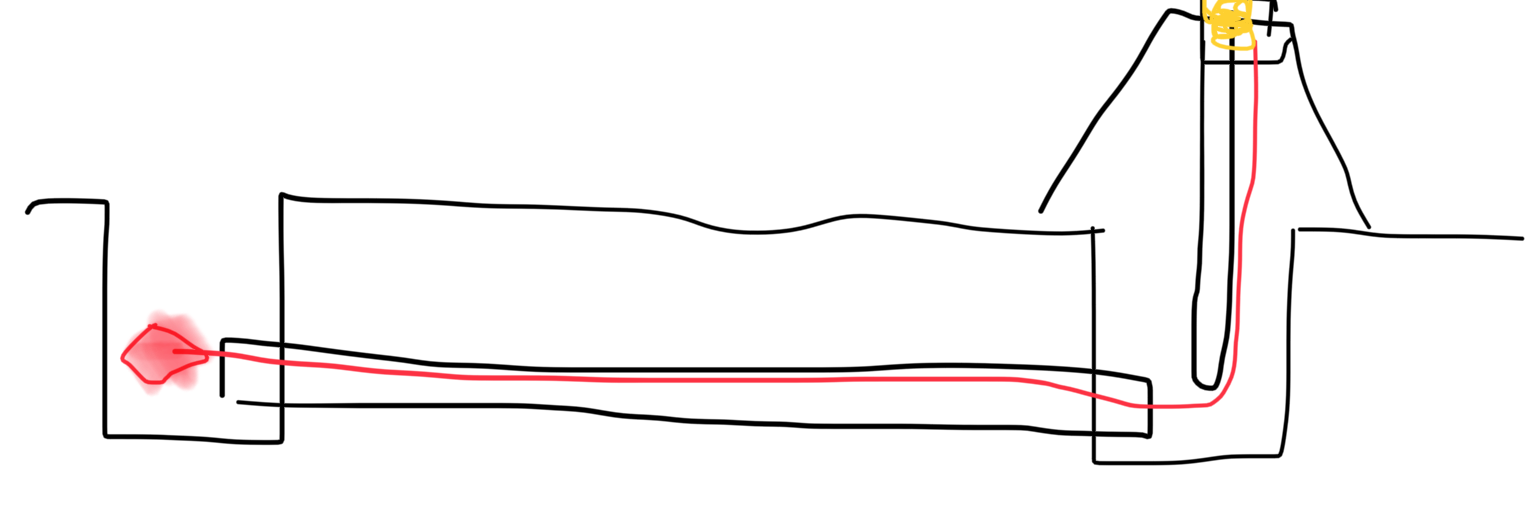

If we ever line pitch fibre (I haven’t done that for a while). We do the same as above but first pull a series of metal ‘bombs’ through to make it round again.
We need access both sides then set up a frame with winch over a manhole, an arm hangs down off that into the channel and then we rope the winch cable through to the next manhole or dug hole.
The bombs get wound back through in size order until the pitch fibre will fit the liner, then we line it as above. The longest i’ve done is 25mtrs and i’ve only ever seen pitch fibre in 4”.
Like this where yellow is the winch and red is the cable and bomb:

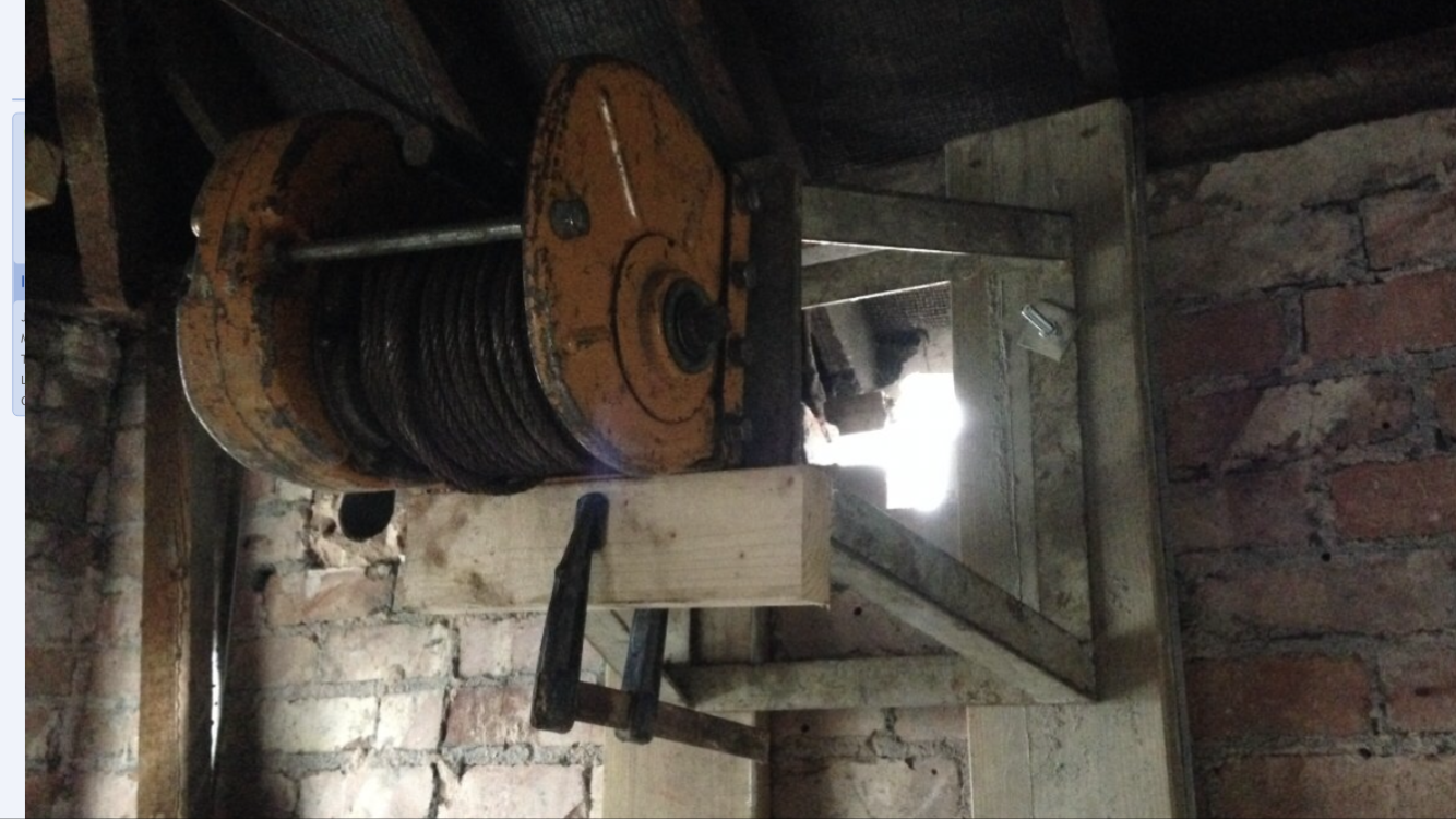

This is the winch and top section of the frame being used to pull an RSJ onto my roof:
