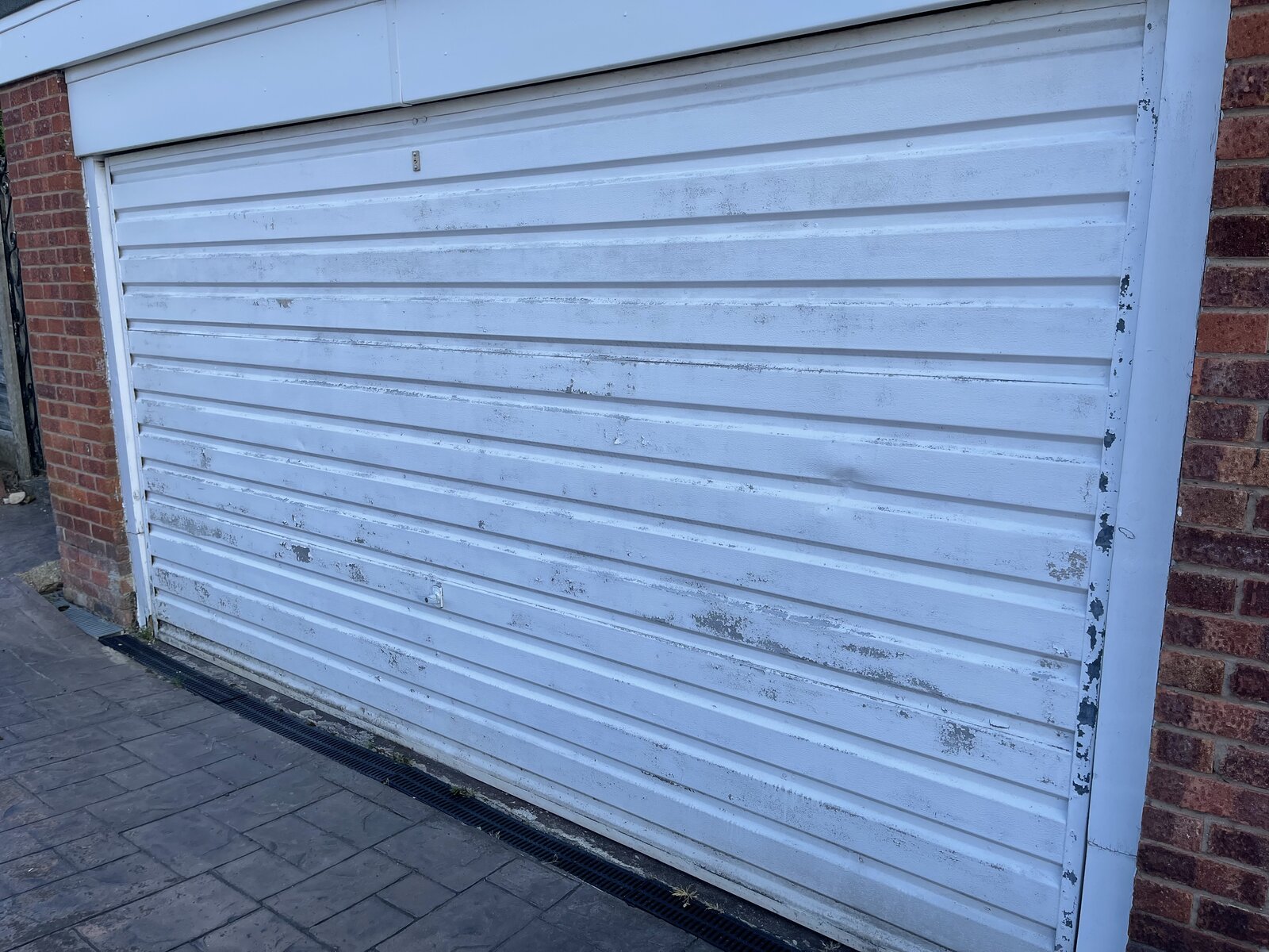

I new to tackle our garage door this summer, what paint do I need?
it’s a Henderson double up and over. A fair few years old
can I jet wash, clean and paint over?
You need to scrape all the loose paint off, and sand the surface ALL OVER.
If you don't sand all over, the new paint may peel off - and you do not want that.
All bare metal should be primed with the appropriate metal primer.
