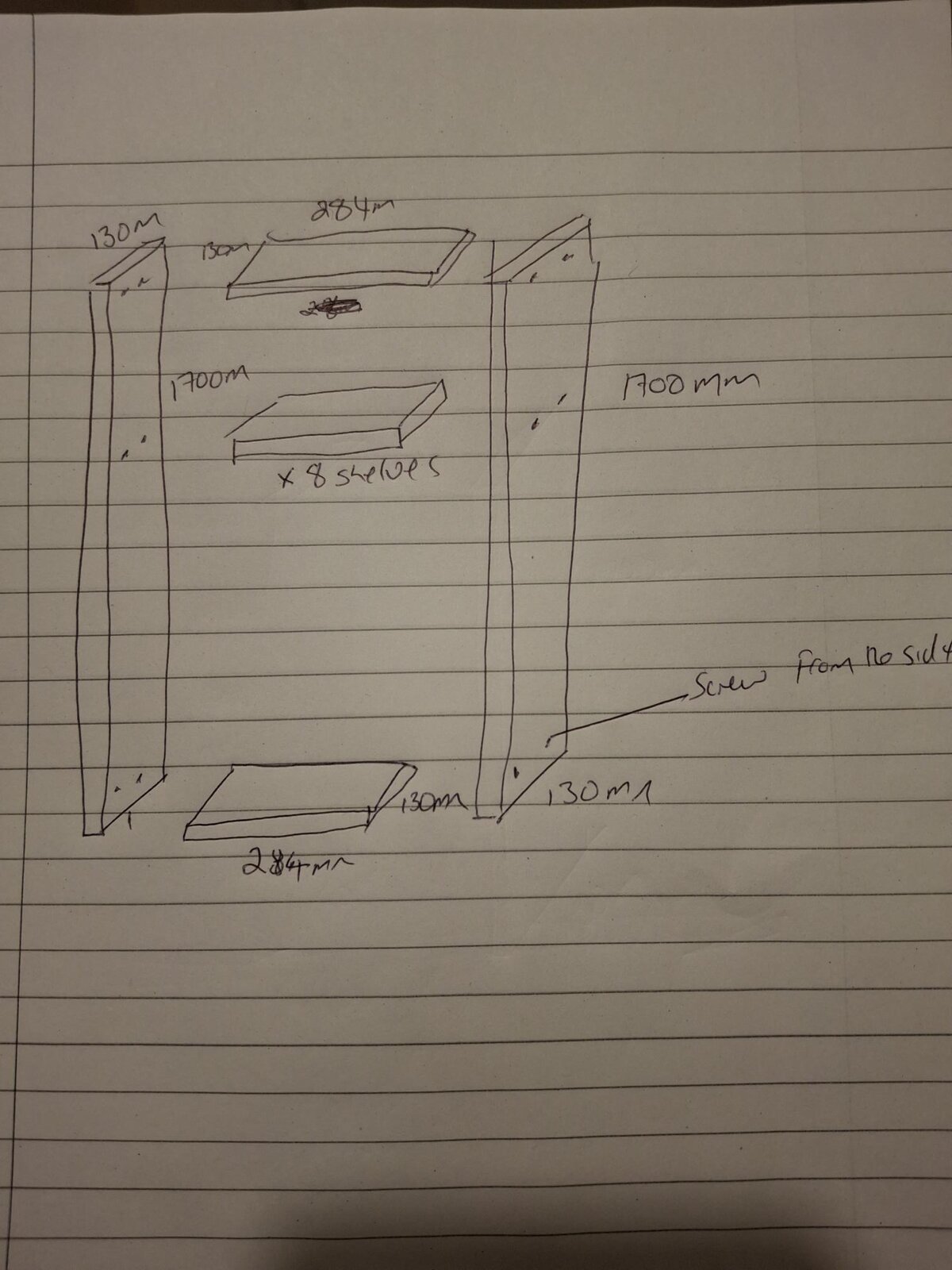

Just making a small shelving unit out of MFC. It is 18mm thick with chipboard. Having google it, are confirmat screws the best to use for an amateur with limited tools. The screws will not be seen on the outside and its only for a understairs cupboard. About 2 metre high, 30cm wide and just 13cm depth (to fit in a small gap), and will have about 8 shelves to hold some spices and a few tins.
Would be useful to know what size length, diameter screws to use. Any help is very much appreciated.

Apologies for the poor drawing. It is fitting in a vert narrow alcove in the under the stairs cupboard so the sides will be not visible. Just a view from the front

I would recommend confirmat screws, but they need correctly piloting (Trend Snappy RTA or eBay copy) or a fairly steady hand.
Otherwise long thin woodscrews (or plasterboard screws are good being generally thin in gauge). There is very little pull resistance in the end of chipboard so the longer the better (I use 75mm but I do use an impact driver to pull them in). Pilot hole essential or it will burst the chipboard. You can buy cheap drilling jigs.
4mm x 50mm decent csk wood screws with thin threads like Timco screws would be fine
Drill a 4mm shank hole through the sides + do countersink then a 3mm pilot hole into the ends.
For shelves, screws in to the edge of chip are not a great solution. They do have a habit of blowing the board, and in any case you only have half the thickness of the board supporting whatever is on them.. You can use them with care, but there are other solutions.
If the heads are not going to be seen, I would take one, maybe two shelves and fix them with a couple of screws PLUS drill through from outside once the shelf is attached with screws and tap in some (6mm) dowels as well. The screwed shelves give the structure stability. For the rest of the shelves you are probably better off using shelf supports e.g. https://www.ironmongerydirect.co.uk...PkzGuuKuZjV1JVYSpBP0qF-aQ-zuyLA8aAvR2EALw_wcB
Confirmat Screws M7 x 50mm ( Screwfix ) are ideal must have pilot hole.
These are an alternative and can be used with timber screws .
Or can be used in combination to help simplify construction .
Dowel screws screws for the top and bottom shelf. The other shelves could sit on shelf supports giving flexibility if you wanted to adjust the positioning later.
