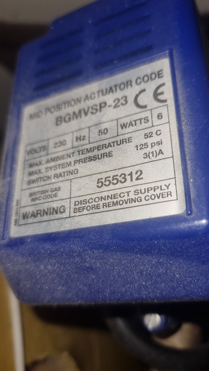

Have had an issue where the heating comes on when it should, but gets stuck on when the timer and thermostat turns off.
Boosting the hot water and then turning it off again always fixes the issue.
Found out today that the actuator sends a signal to the boiler and pump to turn on, and this is what wasn't turning off. The valve is free moving (can move it with my fingers), the actuator is also able to turn it, but sometimes sticks on heating
I need to replace the Drayton, head that the Draytons aren't that good, what should I replace it with?

you can normally only change actuators with like for like, if you want a different brand you will need to change the whole valve
Thanks. I decided to just replace the entire valve and actuator so I've ordered both.

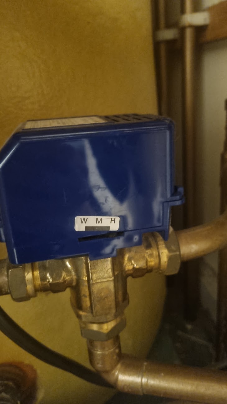

Realised a few days ago that by manually moving the lever to heating mode on the actuator will trigger the boiler and pump (despite timer and thermostat not calling for heat /hw, so looked up the wiring diagram to see how it is all connected and confirmed it does this by design (signal to boiler / pump when call for heat comes from the actuator). Then realised that every time the heating was stuck, the actuator was stuck in the heating position when it should move back to HW position when it's not energised.
This is why I came to the conclusion that it is either valve or actuator. I got it working for a week when I loosened up the valve, but even when it was loose, the actuator would get stuck, although the valve is stiff again, may as well replace both.

I'm not sure what you mean, I have a "W M H" indicator, it either opens the valve to flow through to the cylinder, both or the heating loop. Mine does turn the boiler and pump on, I can manually move the lever and turn on the boiler and pump when there isn't a call for HW or heating.
Manually boosting the hot water for a second and then turning it off is enough to move the actuator to M or W, stopping the signal to the boiler / pump.

I did just swap over the actuator on my lunch break. The new one also gets stuck in the H position, I realised it's moving all the way over to H and then the manual lever locks in this position until there's a call for hot water at which point it unlocks and goes to W or H.
I took the old one apart to see how it works, and the mechanical behaviour of the new and old are the same. Could be the contacts as you've said.
