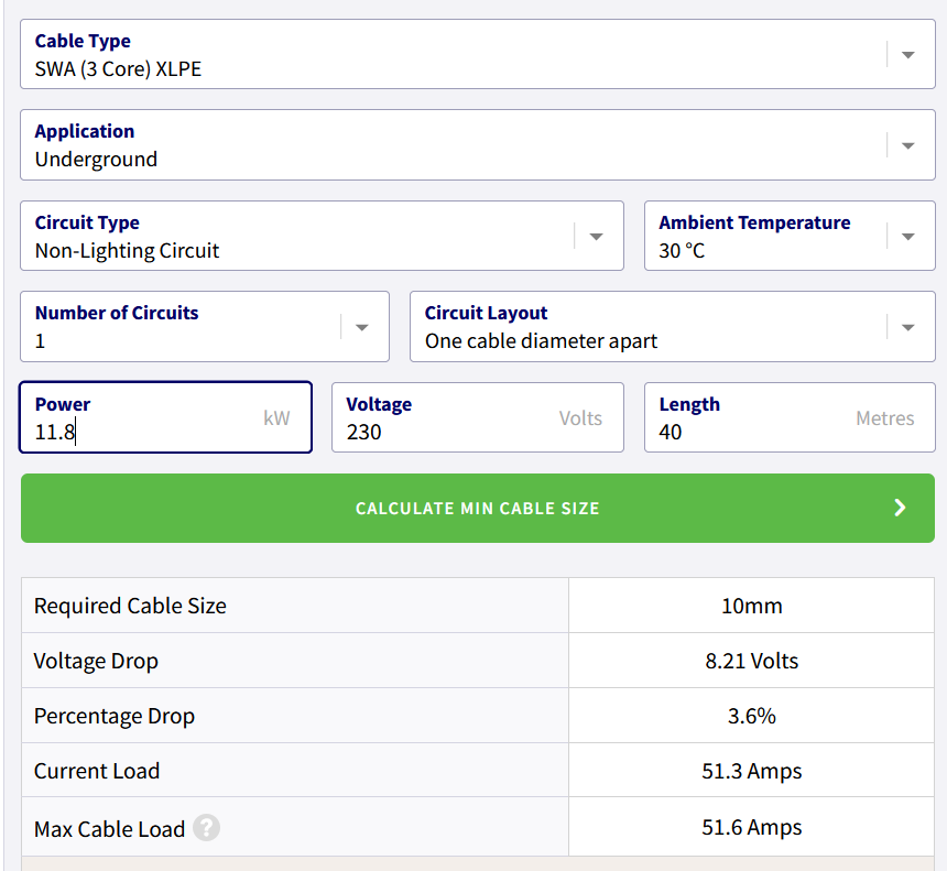

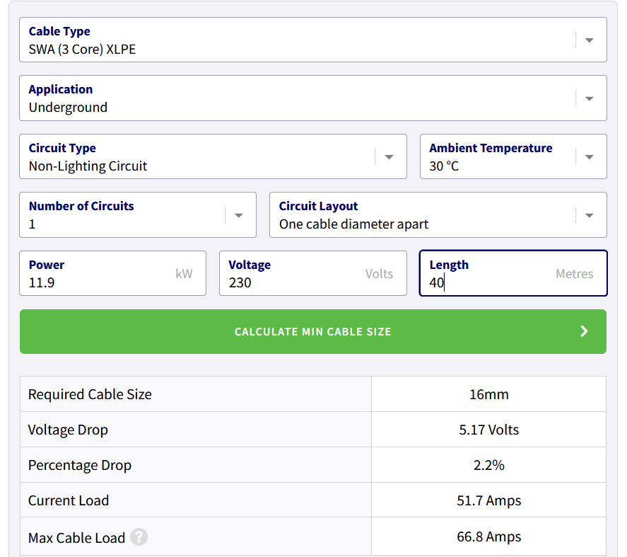

In the meantime I have only worked on one sauna heater which I knew the power of and it was 13KW - I have no idea how representative this is but TLC cable calculator shows the demarcation between 10mm² and 16mm² at 11.9KW, same results at 35m too
