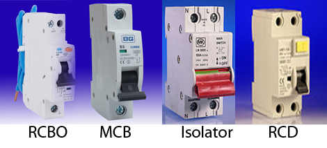

Today we want RCD protection, either using a stand alone RCD or a RCBO which is a RCD and MCB combined, using the RCD method it is common to have many MCB's from one RCD, if this is already the case in your house, then adding further RCD's or RCBO's is a bit pointless, OK with a 10 mA RCD fed from a 30 mA RCD in theory the 10 mA should trip first, but often simply pressing the test button will trip both, so start point is what have you already got in the house?
RCD's as seen here have test buttons.

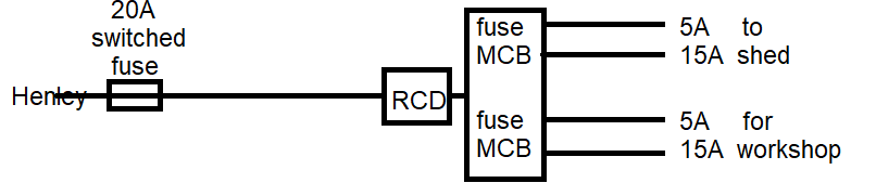

Such as a friends property, some 20+ years ago he cut the cable on his Flymo and started making a repair assuming the fuse had blown... However the fuse only blew when he touched the wires together while making the repair.
The circuit consisted of 20A fused switch of the Henley block, app 20m 2.5 T&E (7/0.029) feeding 4W Wylex in workshop with all fuses 5A lighting and 15A sockets in workshop and same again for shed. After the incident I added an RCD in an enclosure and 15/16A plug in MCB's for the power circuits

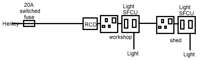

Realistically CU not required as sockets could happily run on the 20A supply and the lights would only require a FCU as the light switch.
Ever since he has got into the habit of switching off the MCB's when not in use after leaving a thermostasic fan heater running. So yes as Harry says it's handy to be able to easily turn off sections.
