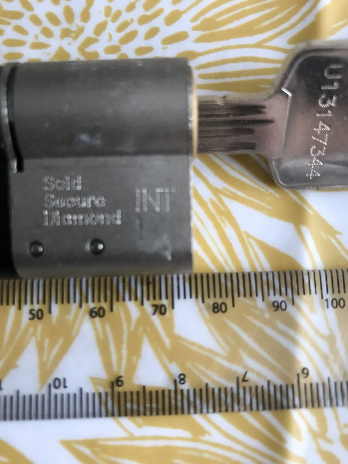

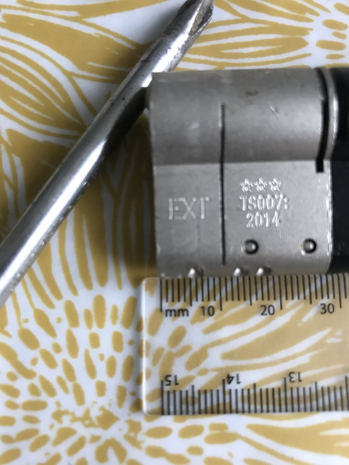

What size is this euro cylinder?
14 Sep 2010
7,056
902
Rochdale
It’s an Ultion and it’s total length is 73mm.
Internal to the centre of the hole is 37mm.
External to the centre of the hole is 37mm.
I’m thinking it’s a 35/35 but not 100% sure.

Ian
I would say it is a 35/35.
And shorter is better than long as any sticking out bits increase chance of lock being snapped.
But perhaps should check in diffrent way.
When it is in lock, does it stick out a few mm or in a few mm on each side of door?
If it sticks out a few mm then it is defiantly okay ordering a 35/35.
SFK
Measure from the end to the centre of the fixing hole, using the suggestion as an example 35/35, some companies could also refer to that as a 30/10/30 when measuring they include the width of the red tab while other companies ignore the middle mesurement and add the 10mm on differently, a 30/10/30 is the same as a 35/35..........its one of the same
I’ve gone for 35/35 for the 2 front door and reduced from a 55 to a 50 on the back door, that one stuck out too far.
Thanks for the advice (y)
