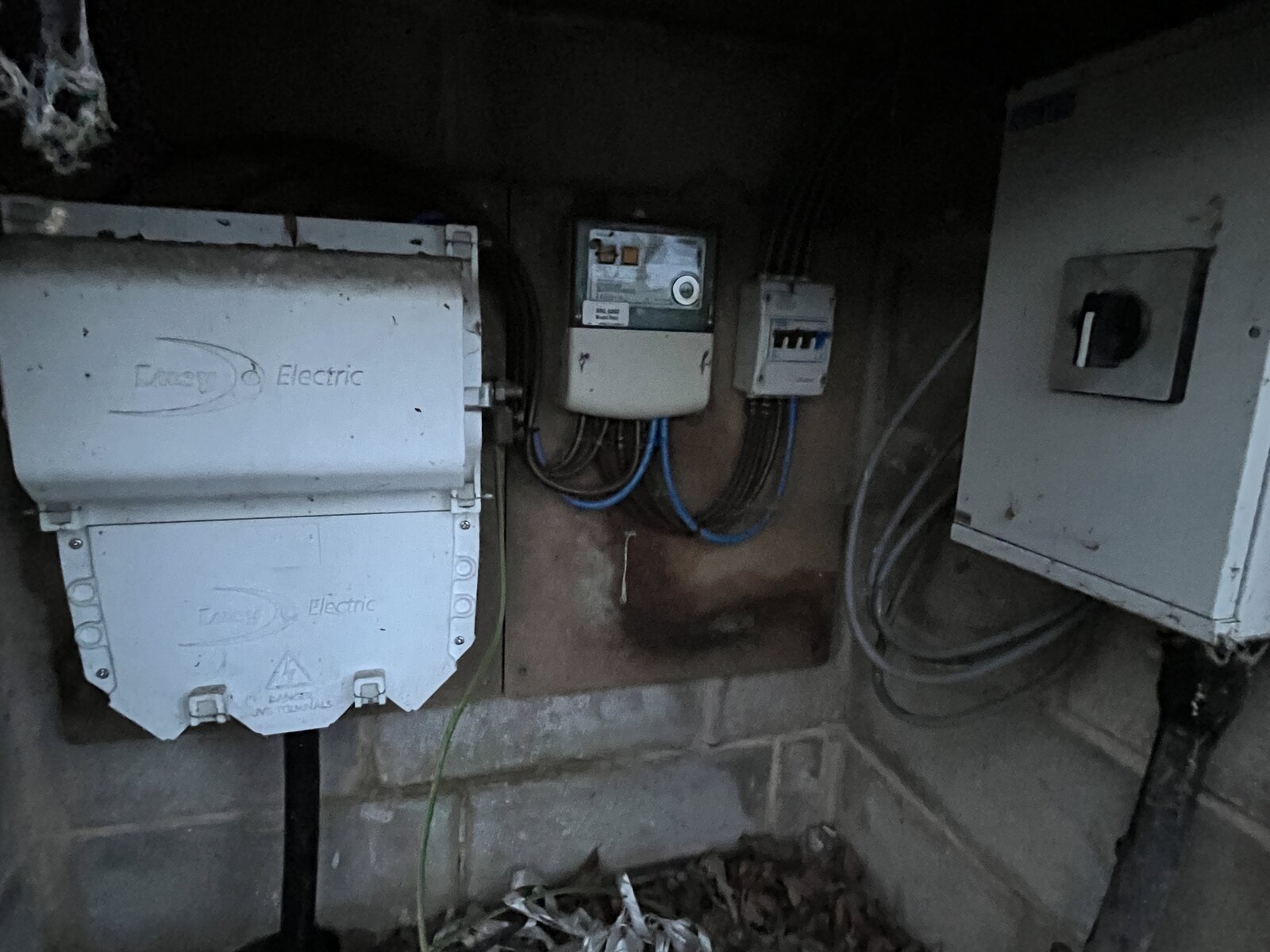

Hello good people - one for the knowledgable sparks here....
I have bought a house which has a small warehouse unit on the land, which has its own 100Amp 3 Phase supply. I have concerns over the installation so I've asked 3 electricians now to come and take a look, and I am getting conflicting advice.
My initial concnern was that I could not see an earth connection on the distribution board in the warehouse unit, and I could see an earth cable coming off the grid supply in the meter cabinet, but it is NOT connected to anything, and by the looks of it, never was.
The service comes into a meter cabinet in a field, (see picture). There is an isolator switch (not fused) which connects to a 4-core armoured cable which runs about 80m to the warehouse where it is terminated to metal trunking and connected to the distribution board. There is no earthing arrangement on the board, no rods etc... Some of the circuits on the board are protected with RCBOs but there is no main incoming RCD.
Electrician #1 Says I have a TT supply, the grid do not give me an earth, and I should have an earth rod at the warehouse. However the building is earthed through the structure, which is fine. He tested earth fault impedence at 16 Ohms and said this should be under 200, and no work needed doing.
Electrican #2 Says I have a PME supply which has not been correctly installed. He says the unconnected earth on the grid supply should be connected to the armoured cable strands, and at the warehouse there should be a similar arrangement to take the earth into the distribution board. Additionally, he says the isolator switch in the meter cabinet should be changed for a fused device at 63 amps to protect the armoured cable.
Electrican #3 Did not comment on the type of earthing, but advised I should have an earth rod installed, and upgrade the breakers in the board to RCD devices.
I have logged an enquiry with Western Power / National Grid to ask what sort of supply I have too.
My gut feeling is that Electrician #2 is right, he seemed a lot more experienced but I would be grateful for other opinions.

Unless there are any labels (probably near the origin of the installation) that indicate that the supply has been PME'd, then only your DNO (seemingly Western Power) could tell you whether or not that is the case.
However, depending upon the size of the 80m of armoured cable, it's quite possible that the EFLI (at the distribution board and beyond) would not be low enough (on the basis of the PME earth) if one connected the earth as PME - so you could well end up having to have a TTearth at the warehouse,even if the incoming supply was PME'd.
There certainly should be some protection at the upstream end of the armoured cable.

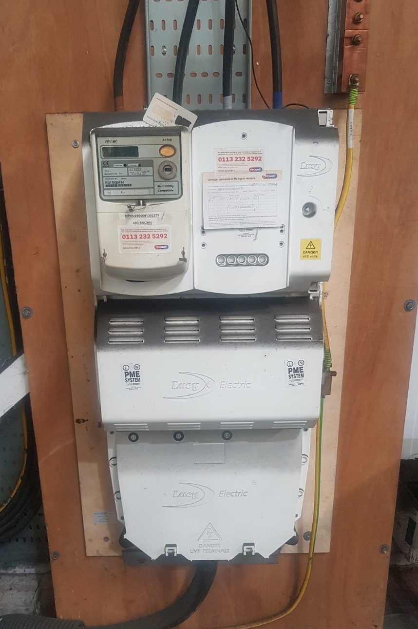

This one looks similar and is labelled PME, I had the DNO out to this one as the Ze was high, they said the additional earth goes to an earth rod (as I suspected)
Even though the meter and surrounds 'looks similar' what matters is whether or not the local DNO network has been "PMEd" - and we don't know whether it has. We do know that, even if it has been, the DNO's earth has not yet been connected to the installation.
However, as I also said, it seems quite likely that (in view of the length of the distribution cable), the DNO-supplied earth (when connected to the installation) would not be adequate for ADS, so the warehouse may well need to be TTd, with ADS provided by residual current devices, anyway.
