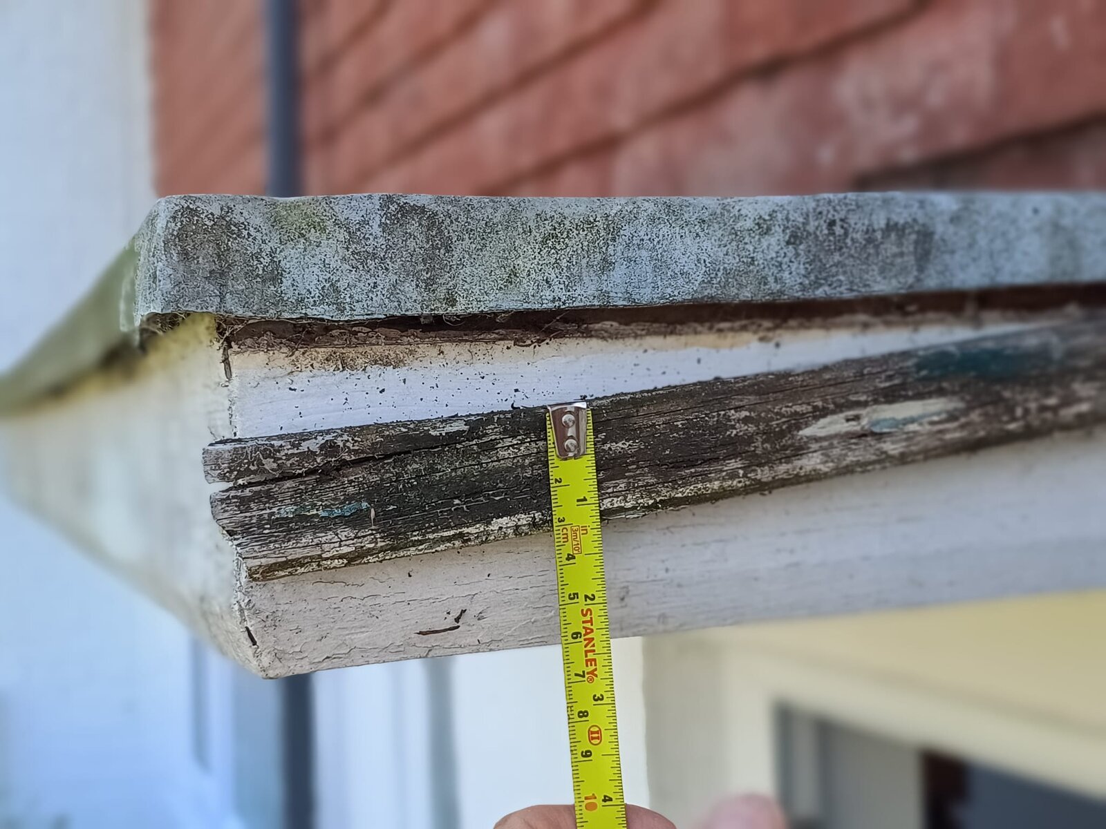

What sort of timber under existing lead flashing on porch?
Min
27 Oct 2003
298
8
The lead flashing on my porch was dressed round timber that's 32mm x 12mm. On both sides of the porch, the timber is rotten and the front piece is missing. Picture shows side piece that is dropping out.
I can't find pressure treated stuff in small enough sizes.
What should I buy and how should I treat it? (Apart from mean to keep it keen :LOL:)
Mary
PAR painted will be fine and last as long as that piece did.
Soak the cut ends in preservative.
