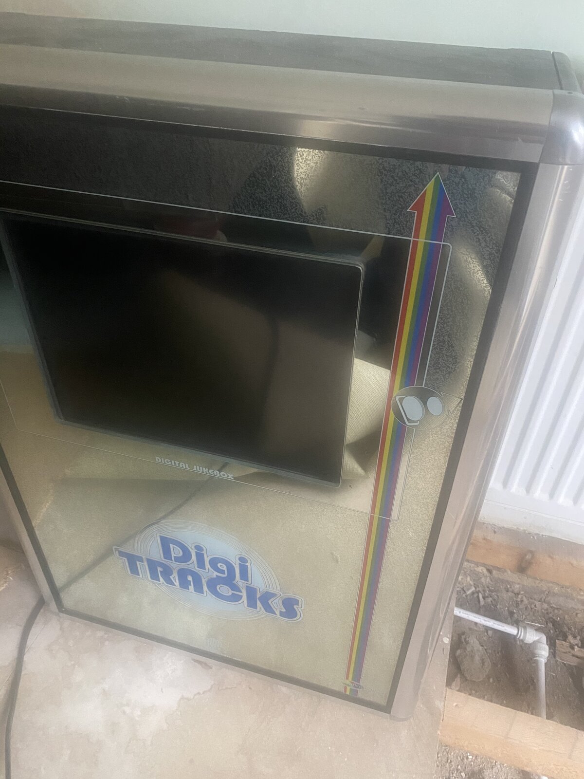

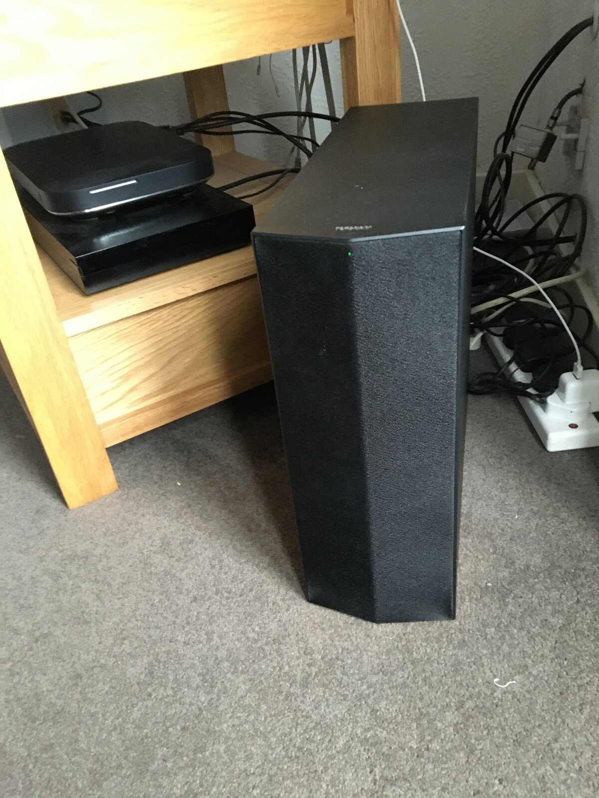

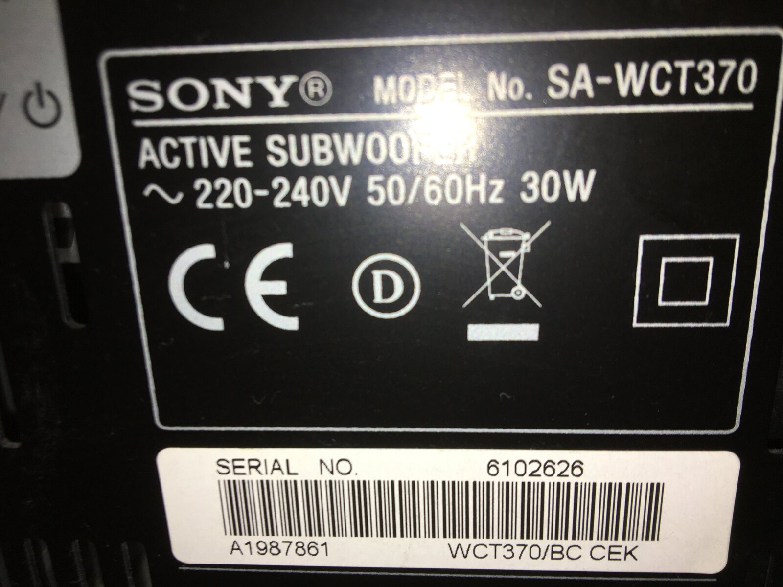

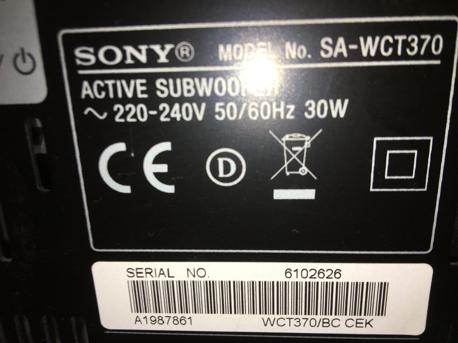

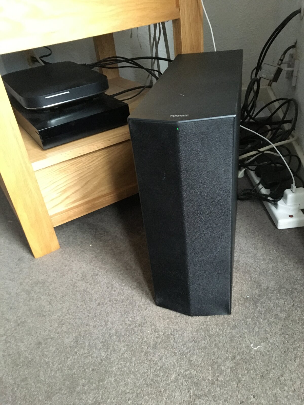

Thanks for your reply, I’m just going to upload the images of what I have. I now know that it isn’t an amp at all, it’s a sub

Your sound bar is a Sony HT-CT370. It has 3x HDMI inputs, and an Optical and a stereo analogue in. There's also Bluetooth. The HDMI out to the TV supports ARC which means that if the TV has arc too then the sound from its TV tuners and apps and any sources connected to the TV directly will get picked up by the soundbar too.
The speaker set inside the soundbar is stereo plus sub rather than pseudo-surround, but the kit understands audio formatted in a wide range of standard and high-def surround formats. It supports multichannel PCM too which is useful for console connections. Other features include AV Sync adjustment (lip sync), 3D pass-through, and 1080p 24Hz compatibility which is useful if you have a streamer or Blu-ray player and want the clearest images from from.

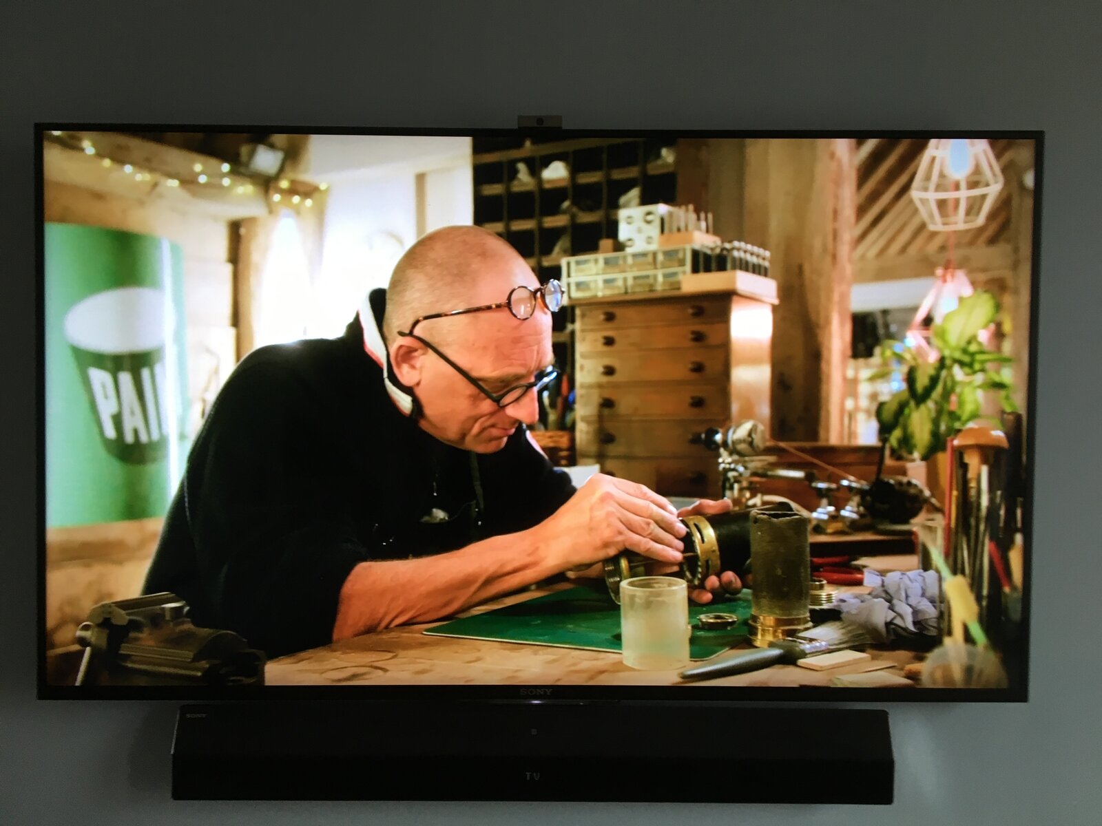

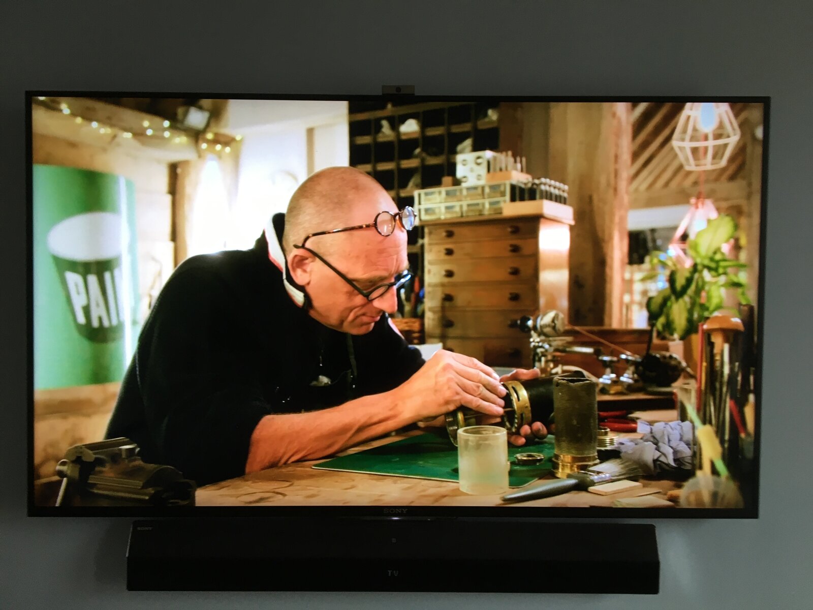

Your TV picture...What am I supposed to do with that? :ROFLMAO::ROFLMAO::ROFLMAO: That's about as much use as a chocolate teapot. It doesn't even lead to anything useful if I reverse image search it. It's a generic Sony TV shot with no helpful details. Please try again. Either write down the model number down or take a clear picture of the back panel showing the model number. I'm probably your best shot at getting something good from the gear you have, so don't waste my time or yours, thanks.

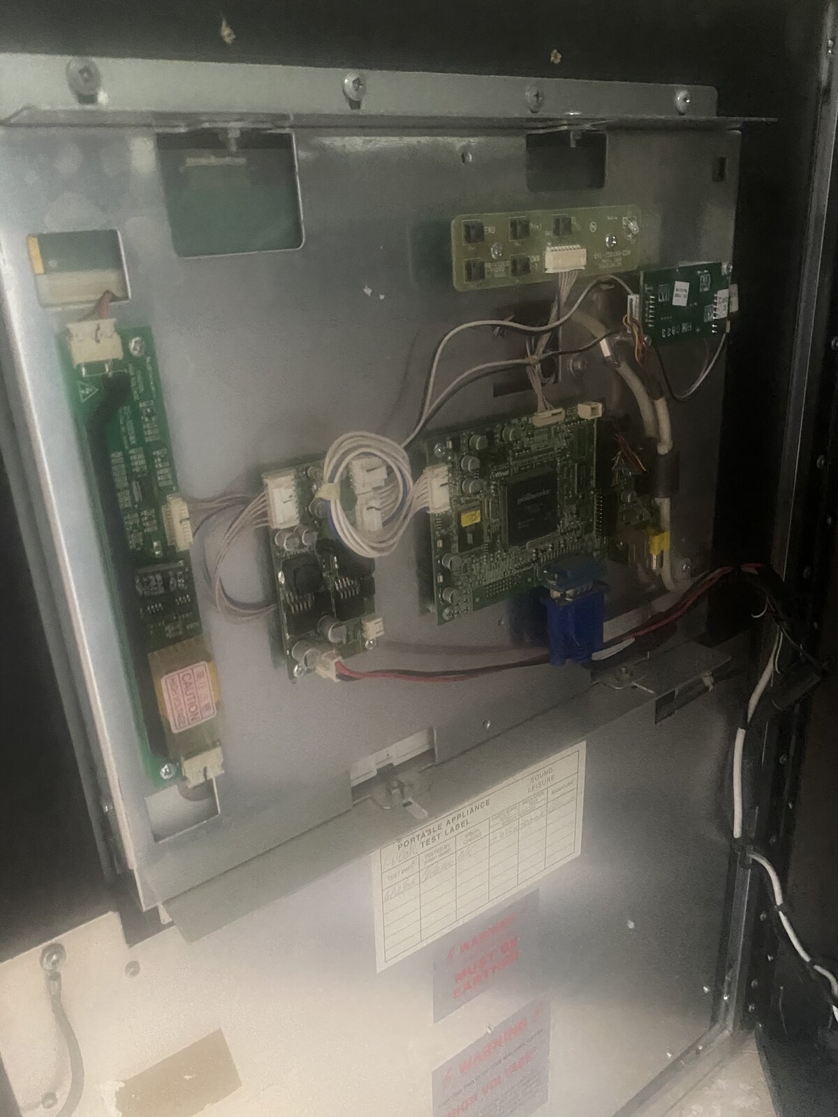

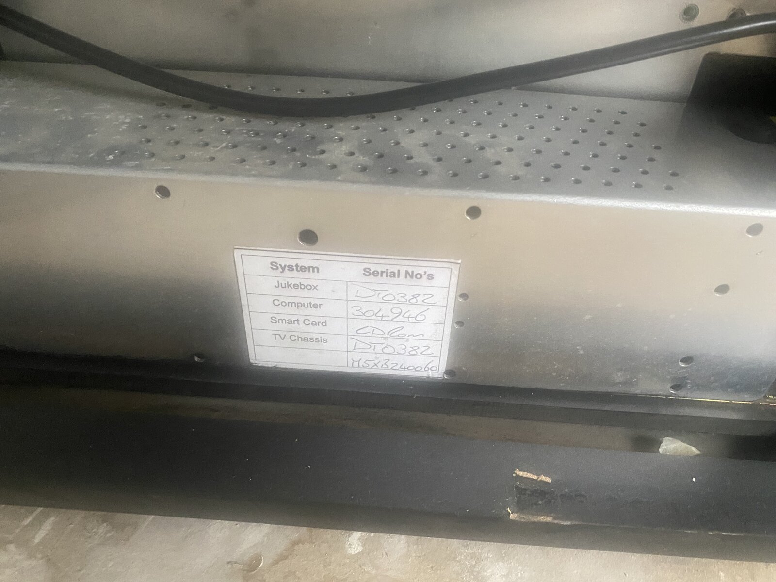

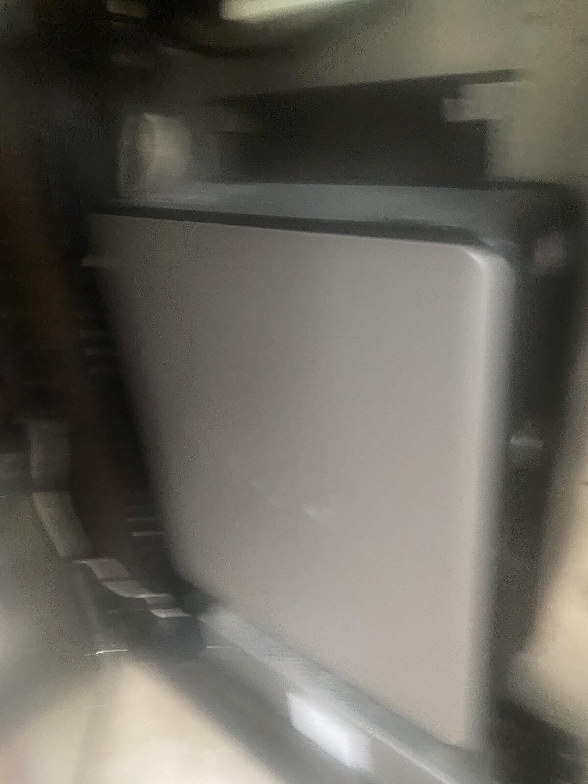

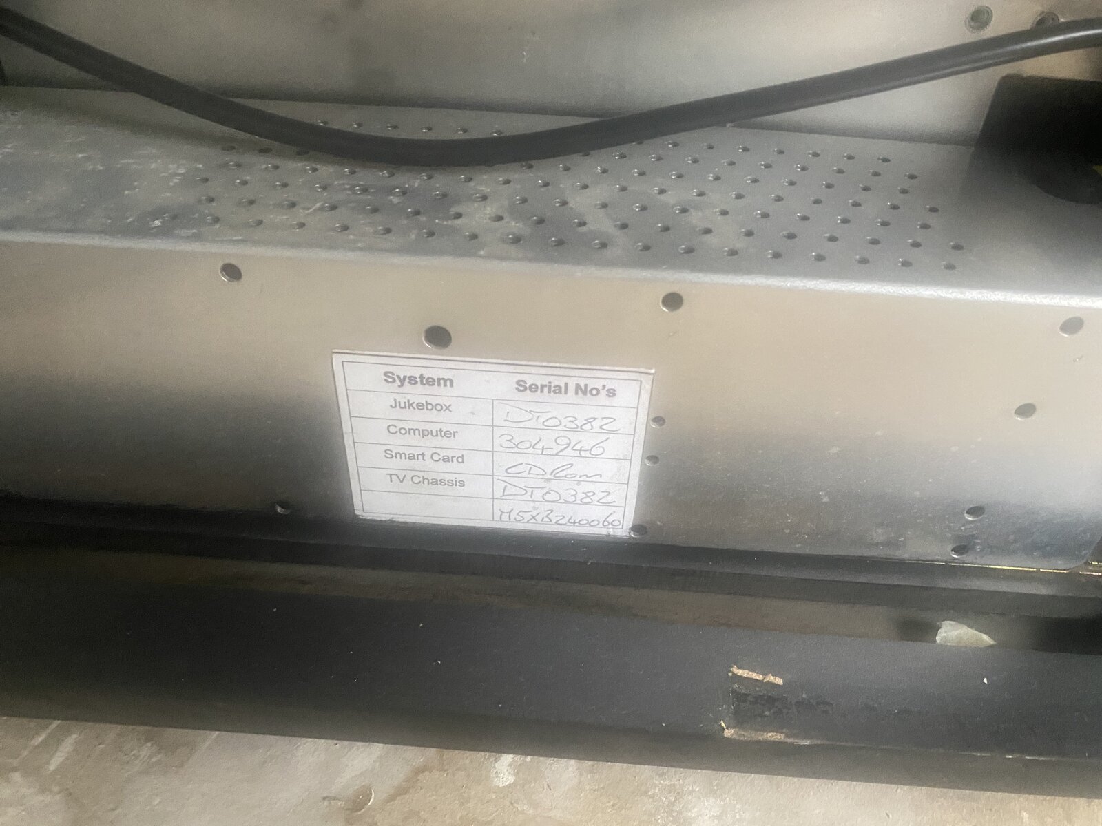

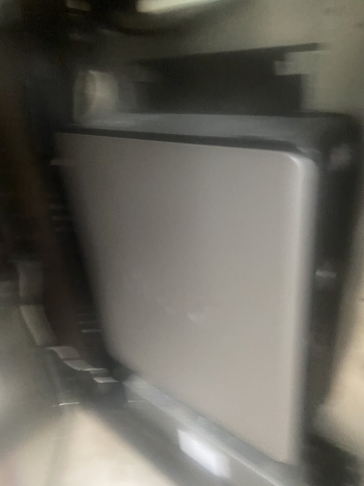

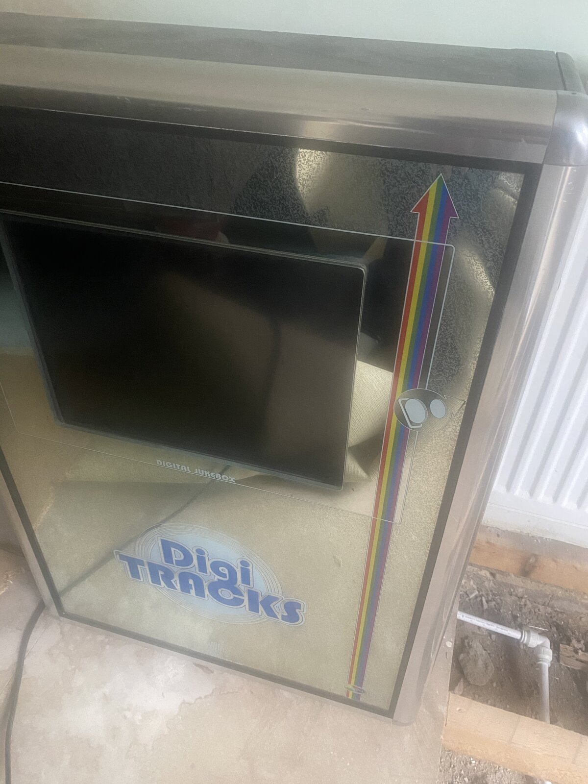

The Jukebox looks as if there's a PC base unit in there (the fuzzy shot of a grey-looking box; again, not much use) but the instruction sheets were helpful so thanks for posting those. According to them there's an audio out (green jack socket, standard for PC audio out) so that will be stereo 3.5mm jack the same size as the headphone socket on an iPod or smartphone.
For the Jukebox (PC) to soundbar connection you'll need a long cable with 3.5mm stereo jack on each end. Don't just buy any make / cheapest as they'll pick up hum. This is especially true of any cables you might want to hide in-wall. Hum from your music would be annoying through the soundbar. You want something with really good shielding. If you want, I can make a custom length cable for you using good quality cable.
The best audio quality will come from sources connected directly to the soundbar. This is where the HD audio decoding comes in to play. If you choose instead to route the signals to the TV first then you'll limit the sound to basic stereo and Dolby Digital 5.1 (Note: don't bother routing the Jukebox anywhere else other than direct to the soundbar.

Thanks so much for the reply, its so helpful, sorry for the images, it was just the best I could do at the time with what I could get from my parents.
I have since found out that the tv is a KD-55X8505B
I will do my best to get some better pictures as soon as I can
