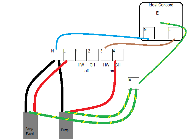

Sorry I am just trying to understand the type of system I have installed at home, and if it can be improved in anyway before I can afford to have it upgraded/replaced fully.
I currently have an Ideal Concord W - WCF 255 A
It has an old Programmer that has the option to program 2 on and off times for CH and HW, but not different times for each day.
There are no room stats at all, and as far as I can see, no cylinder stat.
I also have a pump on the CH but again as far as I can see, no valves that are powered.
Any advice would be welcome. I am currently saving for a new boiler, but the prices were a lot more than first expected although I did call at the start of winter when everyone seemed flat out.
can you get CH without HW ? or does the HW come on when you select CH on its own ?
Disregard the gas supply pipe. If you have 4 pipes coming from your boiler and the pump is underneath the boiler, which was commonly done with that model, you probably have an old gravity hot water and pumped heating setup.
HW can be turned on or off without the CH coming on. If I turn CH on the HW light also comes on. (When I first moved in some years ago, it was the opposite way around, I called a guy in to service the boiler and he fixed the issue with a switch behind the programmer [pumped/gravity its down now not sure what the word it is switched to is, I can check] and moved some of the wires behind the programmer.)
The wires behind the programmer are in the image attached.

as already advised you have a gravity HW pumped CH system but your wiring diagram that you put up is wrong, the boiler live comes from the HW on terminal and the pump live comes from the CH on terminal and that is why you cant get CH on its own the HW terminal brings the boiler on and the HW is heated by gravity , when the CH is switched on then the pump comes on and pumps the water around the radiators .
checked and the programmer is as you said! I have updated the image.
What if any thing can be done to make this system better whilst waiting for the money to replace/upgrade to a newer boiler? I have no thermostats at all at the moment and keep thinking this isnt ideal as the boiler will keep running until its internal stat is hot enough.

But so I understand what's what, when my programmer selects HW on the boiler fires via terminal 3. But when it selects CH the pump is turned on via terminal 4 but it also internally bridges terminal 3 and 4 together to also fire the boiler?
