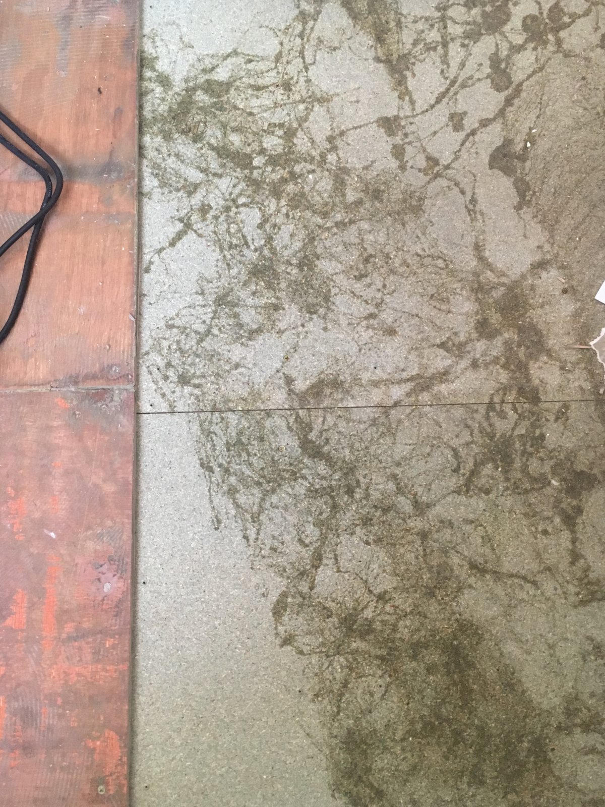

What the hell is this? Damp? Condensation? Mould?
20 Jun 2013
434
3
Staffordshire
Just taken up some relatively new amtico and underneath the ply there seems to be trapped moisture or mould or something else?
There’s no water in that end of the building!
What’s happened?
looks odd. More like staining? Put some bleach on it, if it does not disappear then probably not mould.
Could it be stained from a spillage from a while back that has long dried out?
Doesn't resemble damp, condensation or mould? Looks more like splatter from foam adhesive gun or similar.
to me it looks like airbourn dust and dirt that has been blown in on free flowing air
and for some reason has been attracted to those areas by tackyness or static but purely a speculative guess :confused:

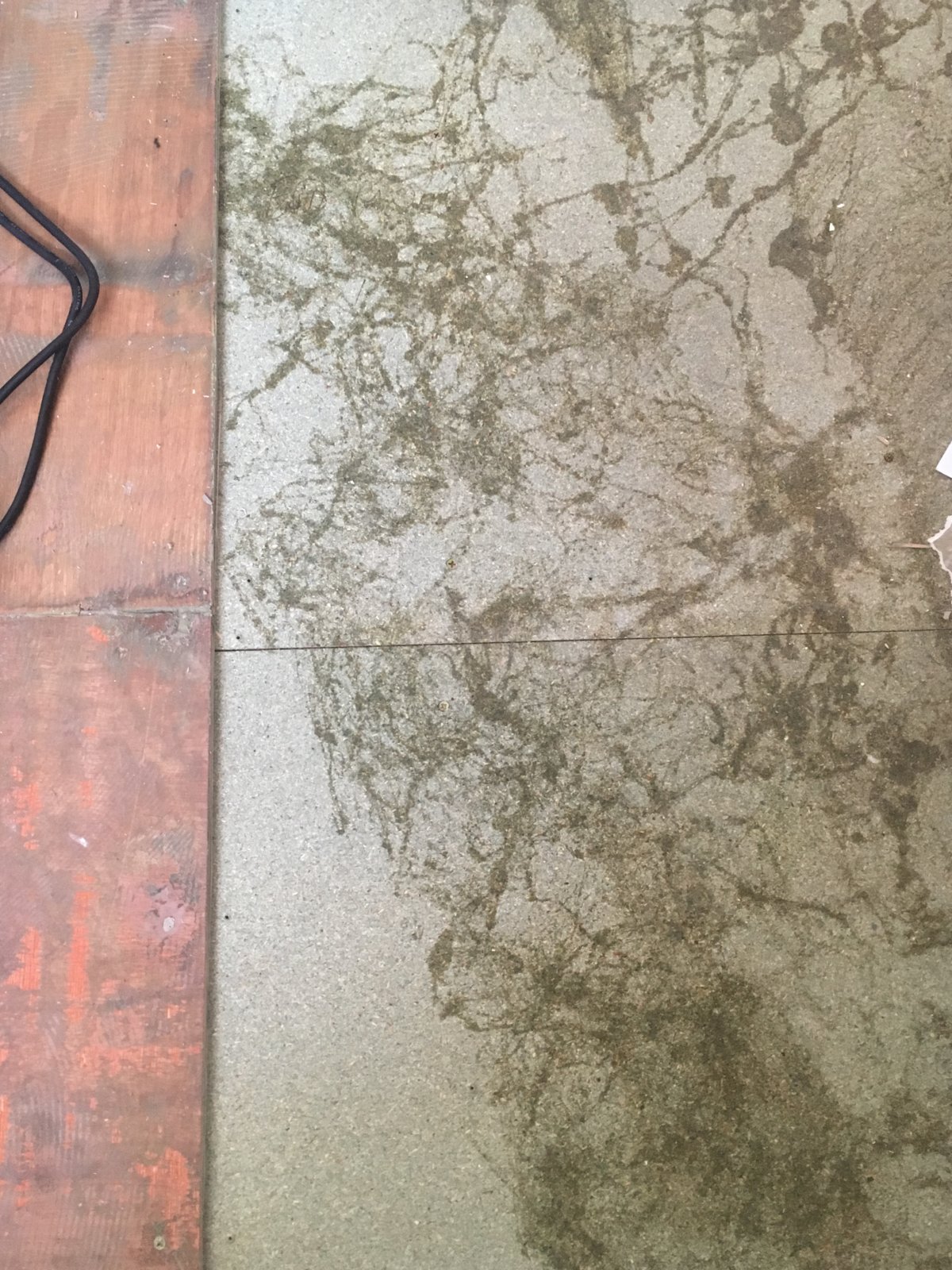

Just been under the floor and despite the usual musty Victorian cellar smell the underneath of the boards and cavity is bone dry. I’m guessing it could be vapour getting trapped between the ply and the chipboard?
Smells damp when I sniff it
Could be sticky residue from the foam work around the edges I guess
My guess is because the lines track so well accross the TandG join, makes me wonder is someone had previously sprayed 'glue' on the the floor to stick down carpet.

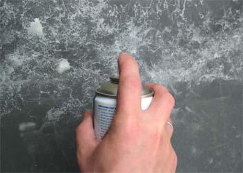

To me it looks like spray contact adhesive which comes out like silly string
Panic over ... just realised there was Lino down when we moved in. Thanks for commenting. Had a mild panic
actually, it's mutant slug trails :sick:
Spray adhesive.
It looks almost identical to spray adhesive I've used for fiberglass insulation.
Amtico when installed properly uses troweled on contact adhesive and that chipboard looks like it's moisture resistant anyway and would be a uniform dark gray colour if it had taken on moisture I'd imagine

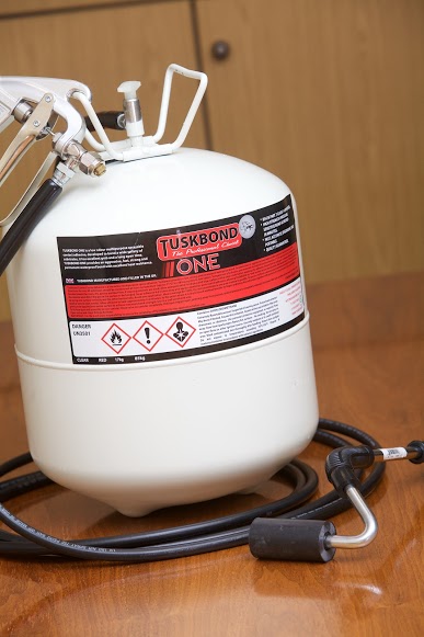

Also on site I've seen pro floor layers use spray bottles like the attached image usually packaged up on a branded cardboard box. Either that or trowel on adhesive. Probably down to flooring. When I've seen amtico laid it's always been trowel on but this is of course underlay and not as crucial.
