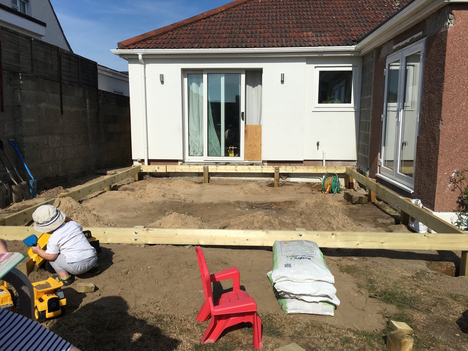

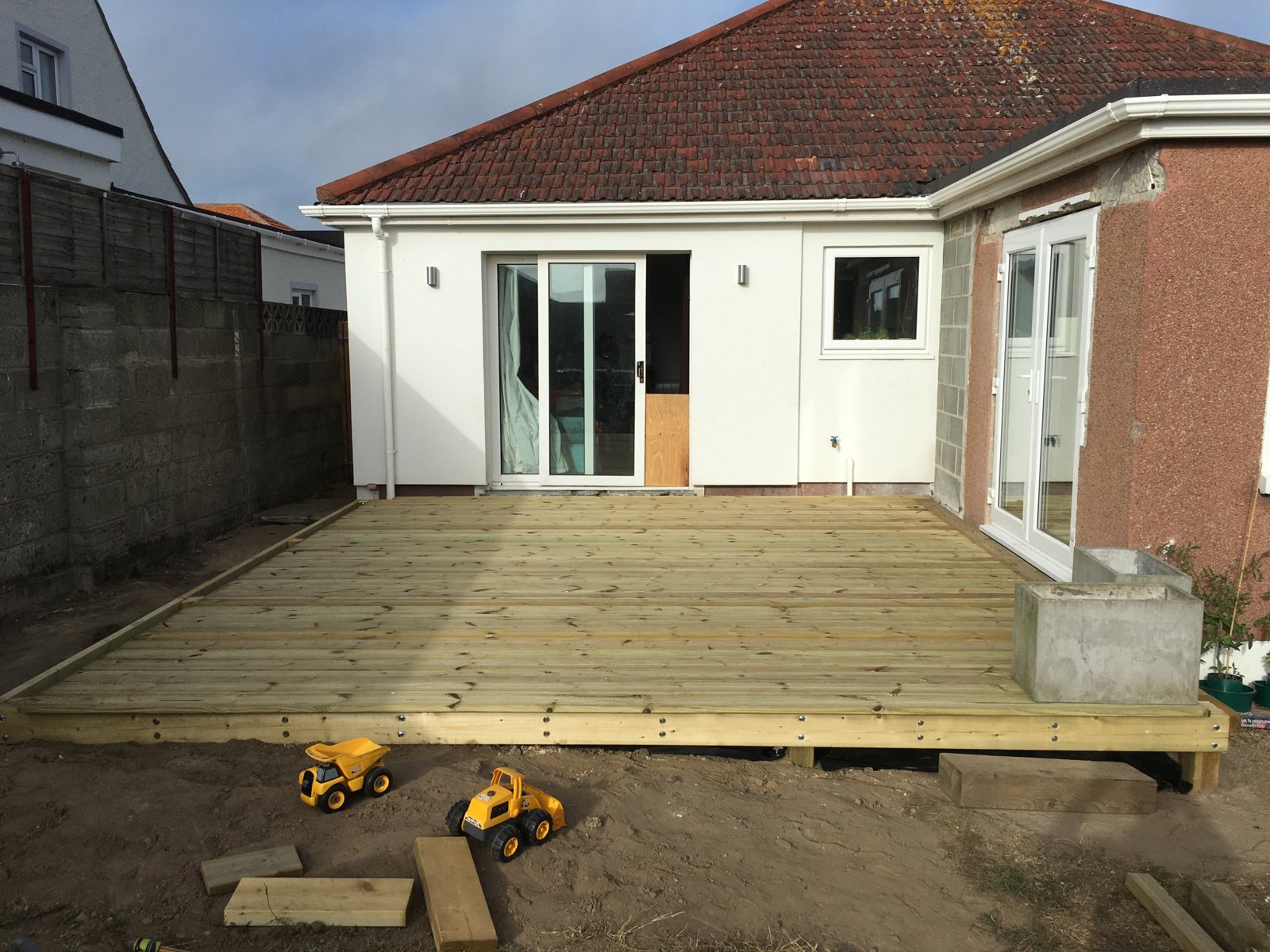

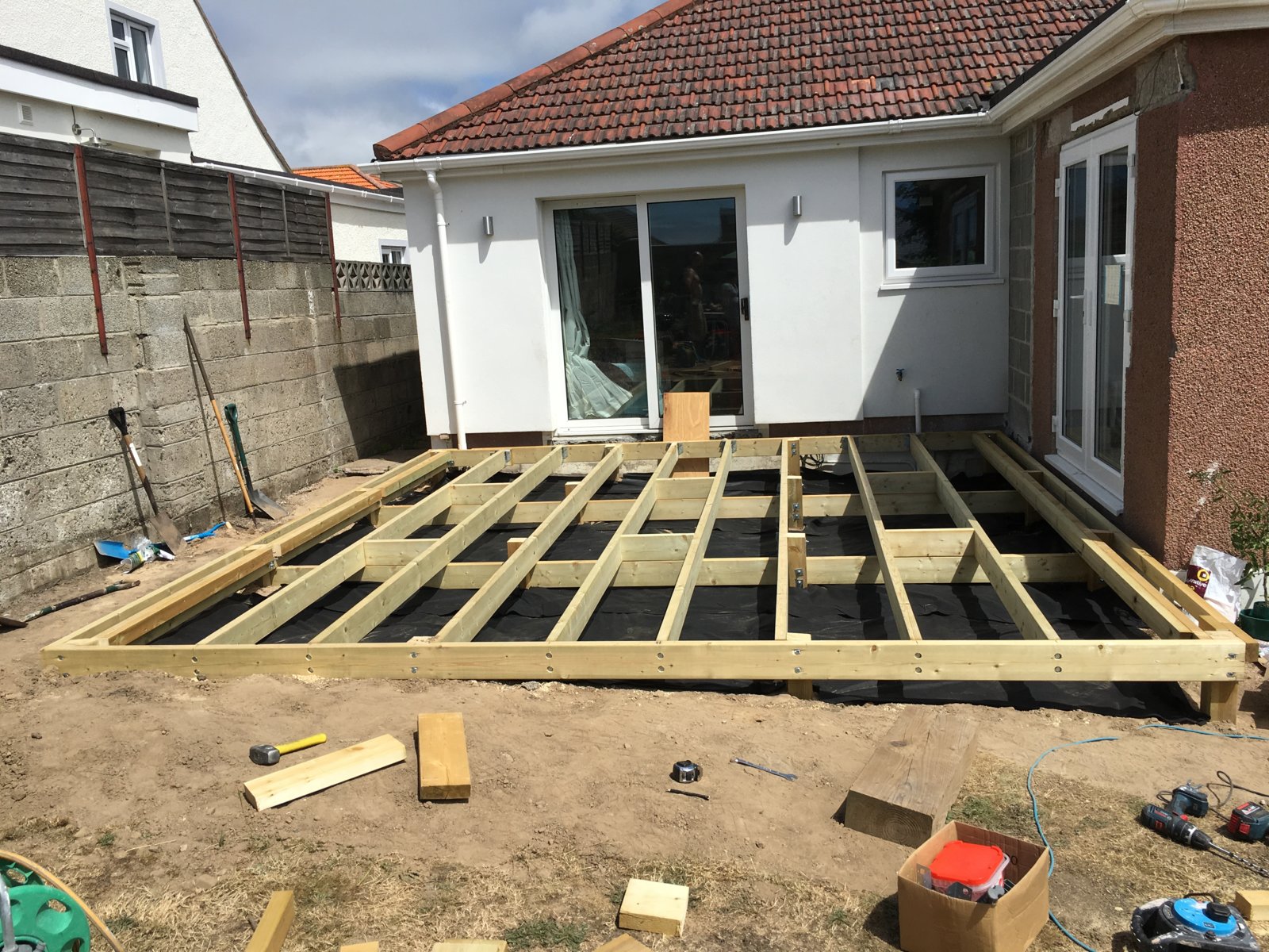

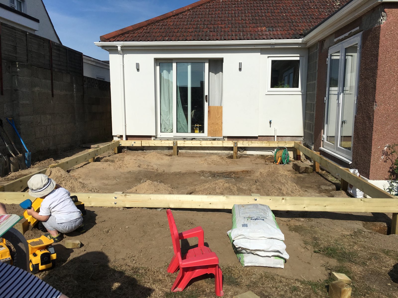

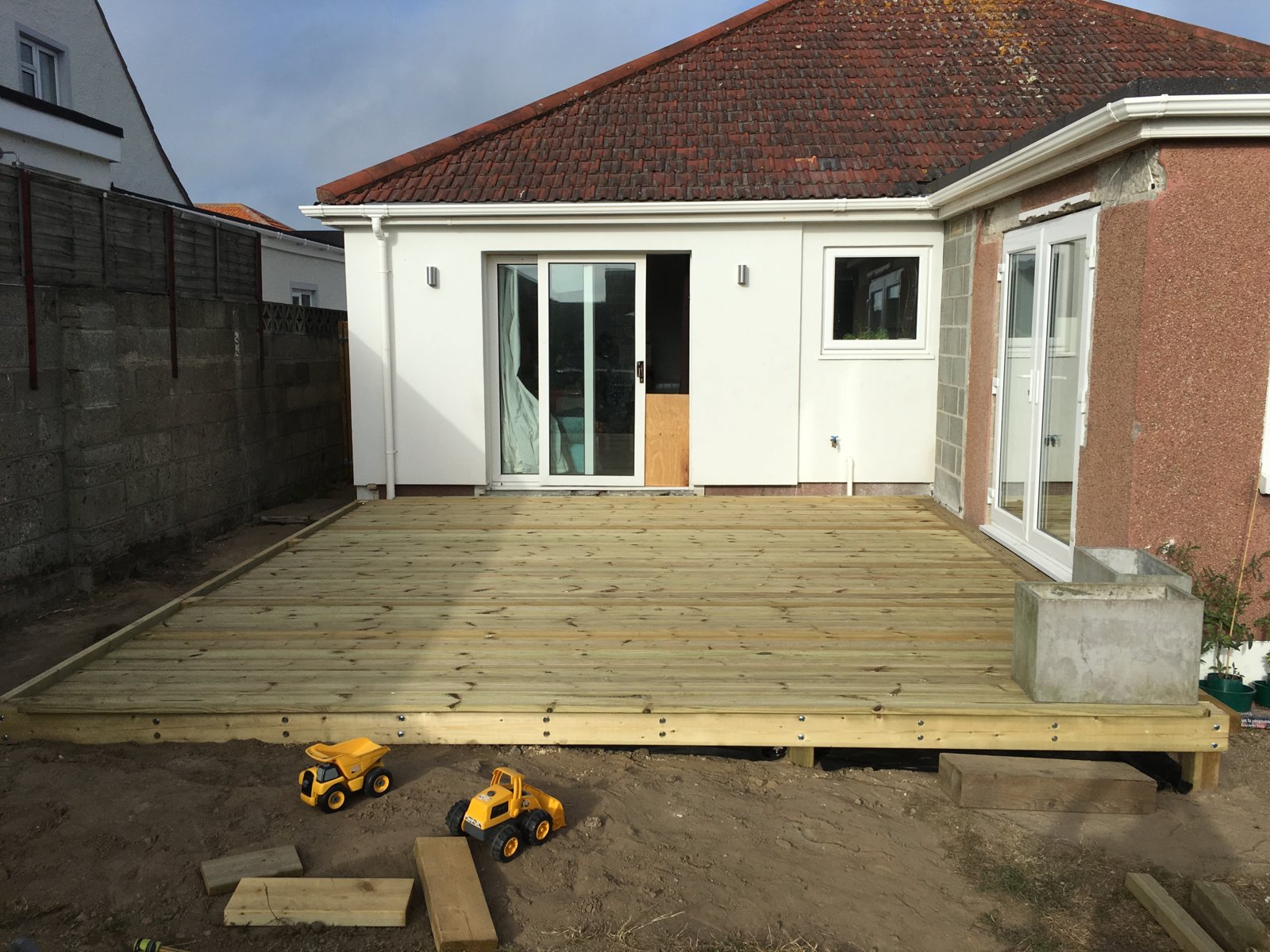

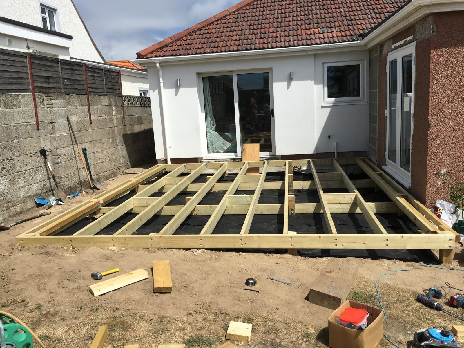

For me, they did 5.4m, but it will likely vary by merchant
