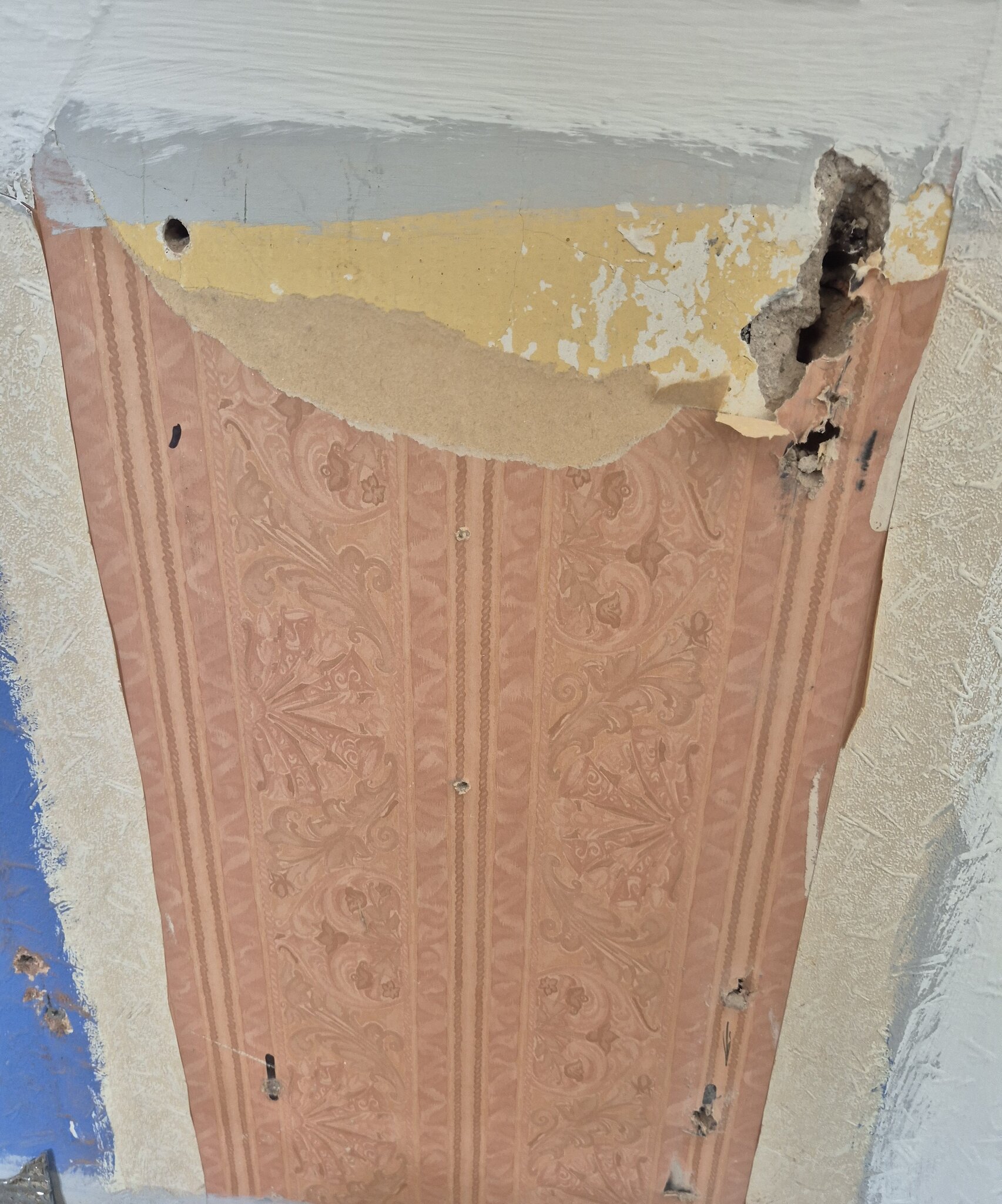

Hi all,
My radiator came off the wall and a plumber came round and I thought he would fill the holes in the wall but he said it didn't need to be filled in and put holes in another place and put radiator back on wall and assured me it was fine and strong and tested the brackets.
However I would still like to apply something to the holes in the wall he left unfilled.
What can people recommend? Something strong? I can reach it ok from the top with out removing the radiator.
Thanks all
Oh my - is that plaster with brick behind it? Mortar should do the job, pre mixed filler would probably end up cracking with a hole that size. Wet the area first before applying the mortar. Do a first fill leaving a few mm, then once it's dry then add a finishing layer.
What a way for your "plumber" to leave the job! Did the large hole appear as this plumber dragged the old radiator off the wall? If so, it was down to him to fill it in to make it good.
As others have said, fill the hole to within a few mms of the outer surface with cement mortar. Then finish to surface level with plaster or with a wall crack filler which you can sand smooth
