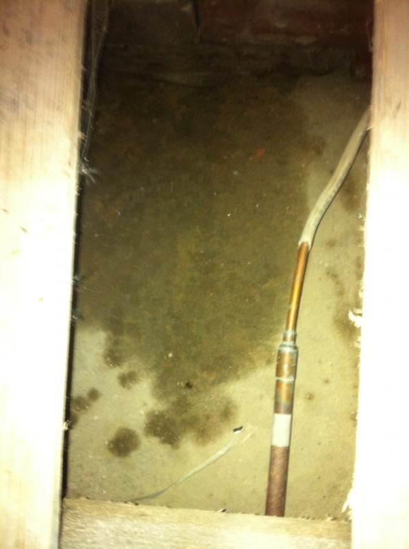

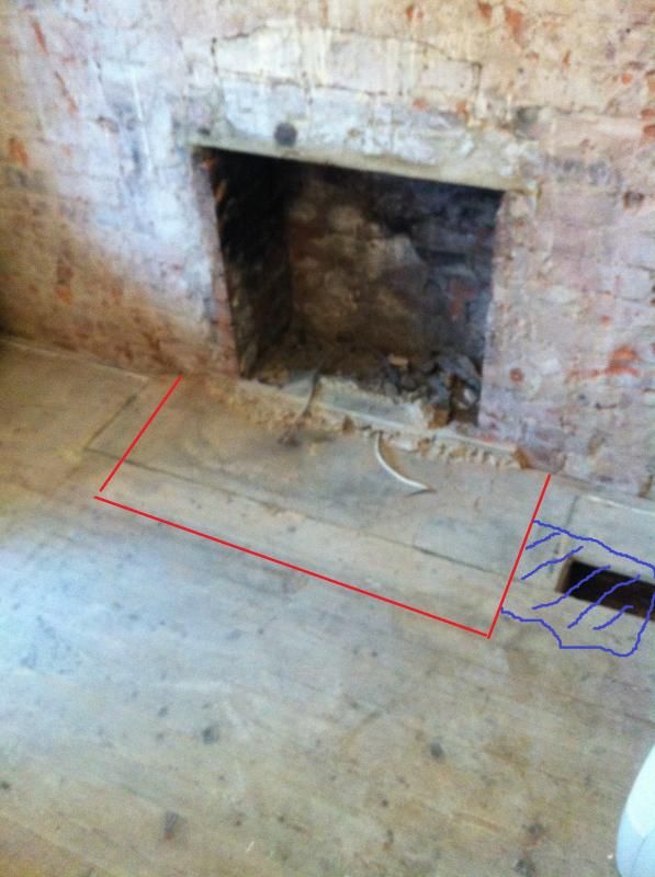

I live in a 1920s detached house, last year we started having damp problems in the dining room next to the fireplace (external cavity wall, not insulated) paper coming off, efflorescence on the plaster work. It turned out directly above this was a few missing tiles on the roof, with damaged felt and damaged lead around the chimney breast. I ended up having the whole roof re done and the chimney stack re pointed. We were told that the damp was the water falling though the damaged roof, falling down the cavity, this was highlighted by a damp meter reading high all over the wall internally and that plasterwork wouldn't dry and needed to come off. The exposed bottom bricks were reading 25% on a damp meter, this was 8 weeks ago, the bottom bricks are still reading 25%ish now. (some are 25, some ar 12ish, its all very random)
Ive taken a few floor boards up and there is a damp section on the ground, about 30 cm by 15cm in diameter, next to the chimnet breast, this has been here for about 6 weeks and not changed.

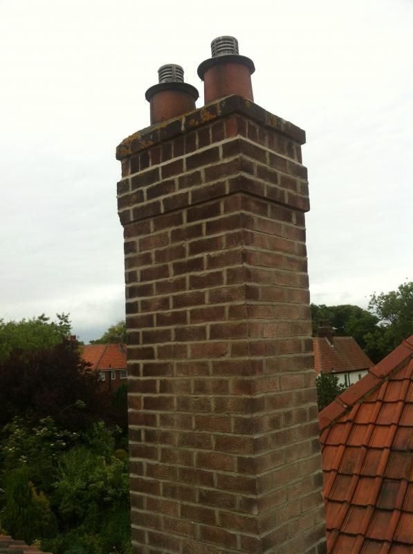

Is the chimney sealed at the top? Or does it have an open cowl allowing air flow through the chimney. Or at any point are their air bricks which allow air flow through the chimney.

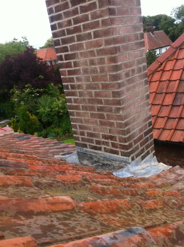

Do you have any pics of the roof & stack prior to the re-roof? And after?

What am i looking at through the floorboard - a concrete oversite or a soil oversite? Why did you lift the floor boards?

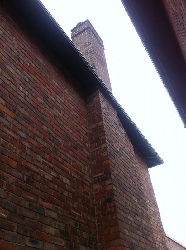

Perhaps post pics of the external c/breast and stack, and the elevation wall?
I can get some later on today of the stack now but not before
It feels like soil.
We lifted the floor board as it was damaged, so I was going to replace it. Not to do with the damp problem.
Ill get more pics tonight when i get back from work
There is an open cowl at the top, there are air bricks into the room but not on the chimney i don't think

Here is the pics of my chimney breast from the outside, i dont have access to it, it can be only accessed from my next door neighbors land.
She has built a little wall between the chimney breasts.

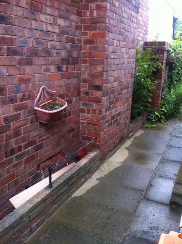

The above pic is of the wall where the problem lies.
The four loose bricks are now back in properly, they were taken out to see if the cavity was filled with rubble, which is was slightly but not much (cleared 6 weeks or so ago)

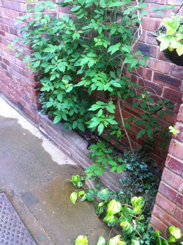

My neighbour had planted plants inbetween the her little wall and my house. We have asked to to remove them, unsure if its done yet.
The red line is where there is a brick wall under the floor boards and the blue patch is where the damp under the floor boards is.
The numbers are the percentages of the bricks on a damp meter (only cheap off amazon, bought for logs but has a brick setting on it)
The rest of the wall is between 5-10% on the bricks.
The damp patch under the floor boards is 23%
The bricks on the outside of the house are also 5-10%

The planters might be bridging the side walls of the c/breast - do you know where your internal and external DPC's are - esp in relation to the flag pathway? The external bottom course of the c/breast is very wet and stained.
When you had the bricks out did you examine up the cavity looking for blockages and snots on cavity ties?
The fender wall is holding soil up to the concrete, or stone, front and back hearths. Moisture could be coming up from this soil infill.
The stack and c/breast pointing look to be in excellent condition.
The lead flashing wasn't done by a leadworker. And given that the roof flattens out at the eaves this flashing could be a problematic area. The lead "flaps" would have to be lifted and checked for capillary moisture.

Maybe the damp seen on the oversite, and the fender wall in the same pic is a combination of residual damp, true rising damp and some penetrating damp.

The stack flashing looked like the old flashing re-used - just saying, i dont obviously know for sure.
