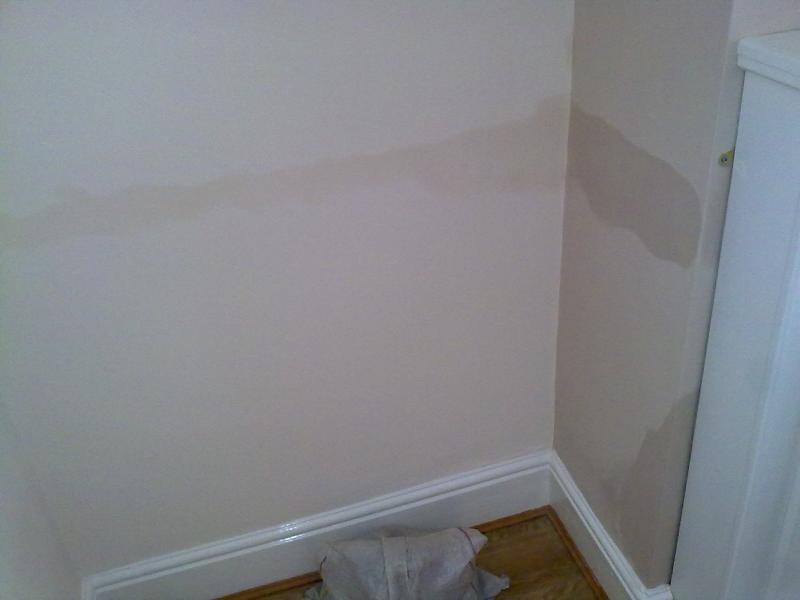

Hiya everyone,
Hope someone can help us as we are at a loss. Basically we have 3 damp patches on a couple of walls downstairs (2 around 1 meter high, the 3rd near the bottom of the adjoining wall), either side of our chimney breast and one on the adjoining wall. The damp problem is a lot more evident when it rains but there is no evidence of damp upstairs around the chimney breast. We have had a few quotes from damp proofers, 1 said it is damp, a second one said it's not damp, that it was too wet to be damp and that the problem would be a leak from a roof! So we asked a couple of roofers, 1 said yes it would be the loose chimney flashing causing the damp patches, another said it would not be the chimney as if it was the chimney then upstairs would be damp around the breast too (which it isn't).
Anyone got any ideas?
Thanks for any help
Neil

there's a strange boxy thing on that wall. Is it a sawn-off chimneybreast or flue?
Where is the bathroom and plumbing in relation to those damp patches?
It's boxed in water pipes mate but it doesn't seem like it's them as the damp is on both walls and only appears when it rains.
Bathroom is on the same floor the other side of the house.
'mmmm, wet patch on the boxing in round plumbing? Open up the box and look inside.
Does anyone drape wet washing about the house?
Yeah that's what I originally thought and we had a quick look but it's dry all around the box and we could not understand if it was the cause why it would be on the other wall too?
As for the washing we do but not for months and it's worse than ever at the moment mate.

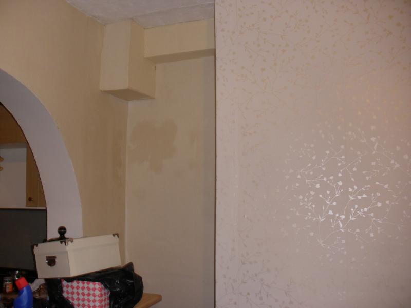

i have the excact same problem as you :( there are no pipes anywhere near my wall though .The damp only starts about a metre high off the floor ,i will upload some pics soon to show it beter :D
the damp is around the fireplace wall at the back of the terraced house ,it has a board over the opening and i recently fitted a vent to the front of it.
