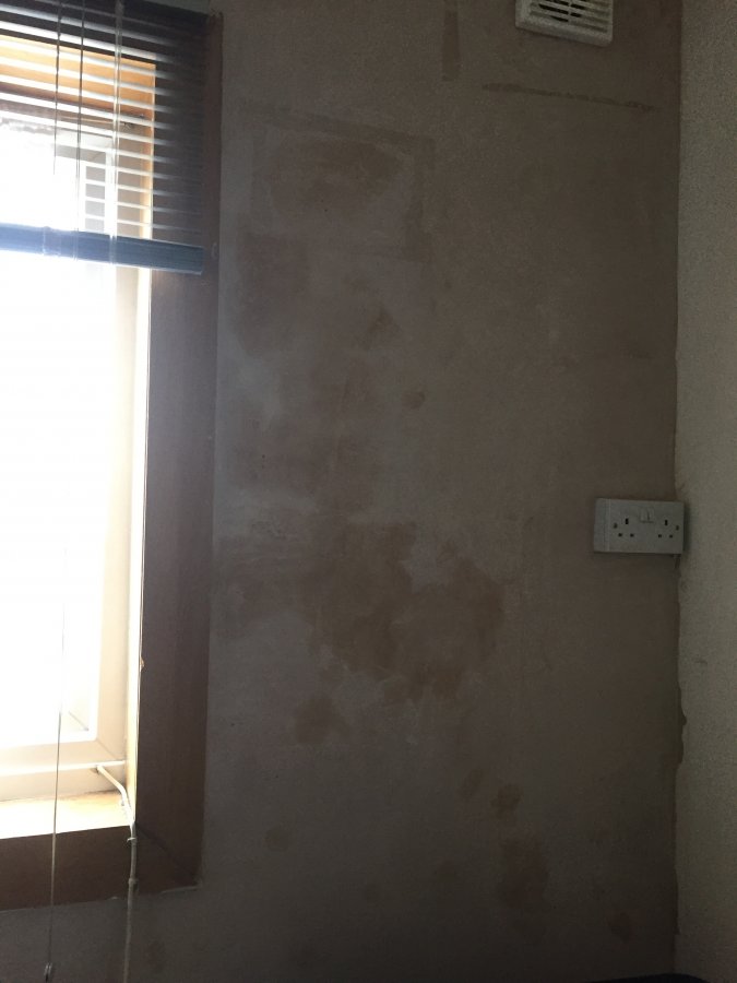

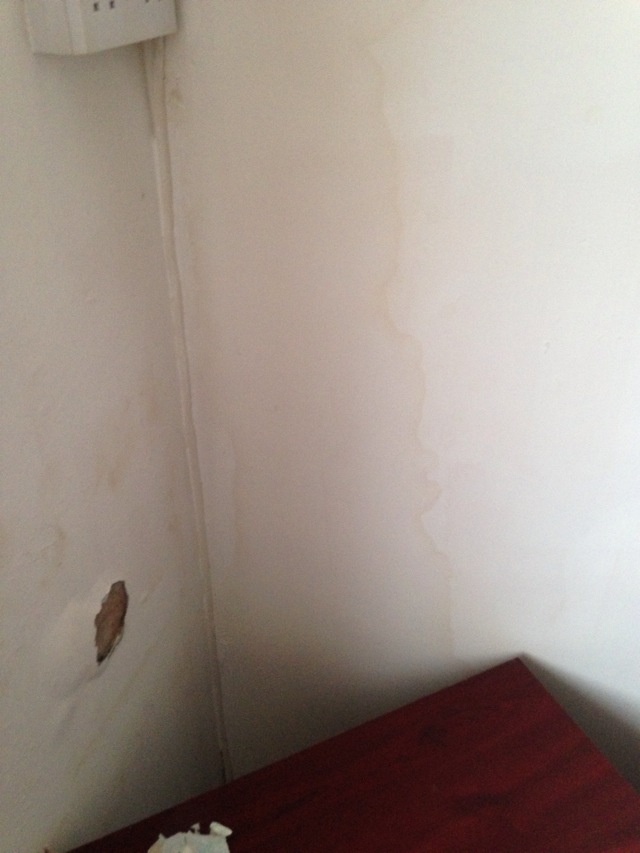

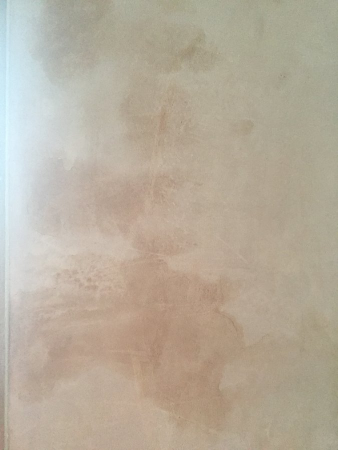

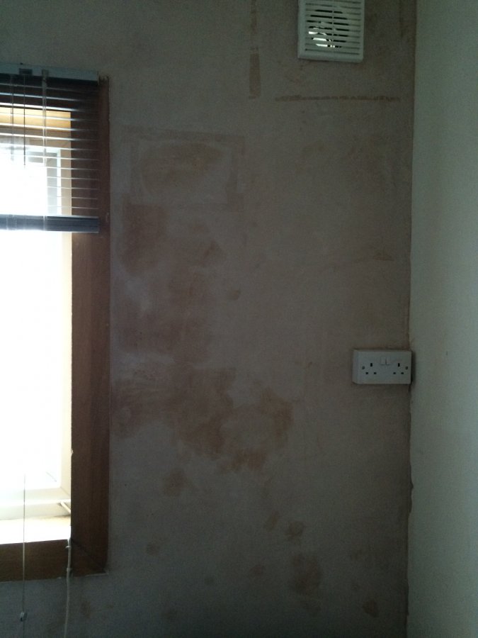

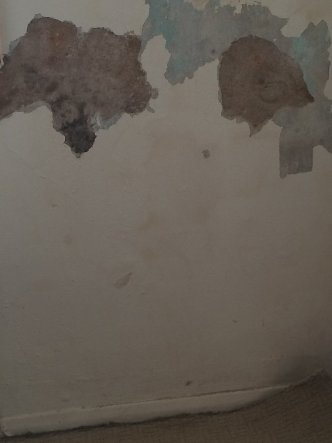

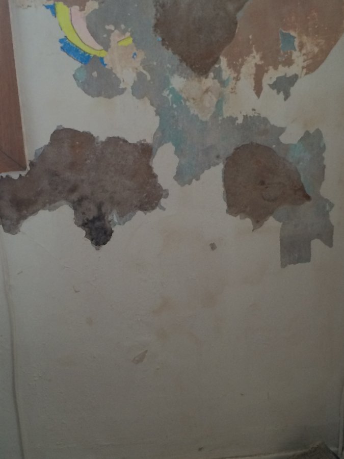

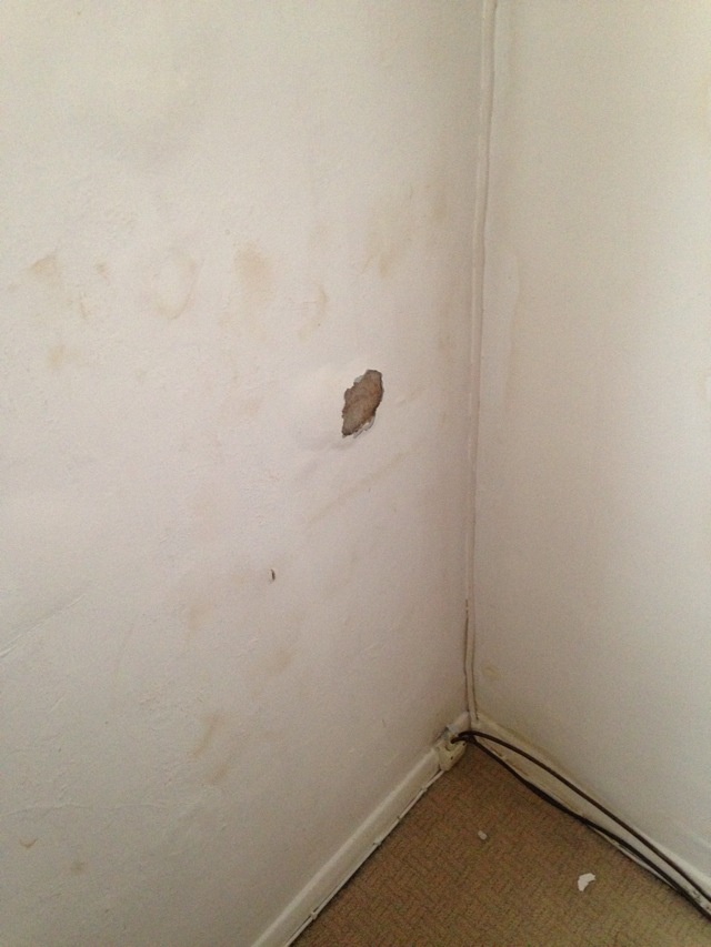

Hi I have a room on the 2nd floor facing southwest with a pebble dash wall..
2 years ago we had patches of damp appearing mainly by the windows area and adjoining wall next door (inside) the paint was discoloured bubbled and peeled off and had black patches under the peeled off paint.
We got a few people to view and they said the external render/ pebbledash seemed ok (by looking) and they advised that it is coming from the chimney area as there was a crack hole with the brick exposed. So we got that filled in and there was a old blocked Air vent which we installed a new Anti Draught Air vent (Core drill with baffle). And got the effected wall section by the windows (entire wall) plaster re skimmed (Skimming over old plaster). We even had the external pebble dash wall painted to cover any hair line cracks.
After 1 years we did not paint the wall yet but started to see the damp parches appearing again in the same places.
Got some more people to look at the problem again. and they said it might be the roofing. Got a roofer who came in and looked at the roof he inspected the roof externally the tile and lead flashing and capped off chimney and said every thing was good and looking in the loft and said the chimney has been removed and end's in the loft, and the felt was good. Then he got a damp meter and tested ABOVE the internal areas where the damp was and said its 100% not the roofing as it too would be damp.
Then we got Another Damp specialist who came in and did the usual with the damp meter and this time hitting the external pebble dash said there was patches of blown off pebble dash as it sounded hollow.
But what confuses us is that certain areas of the external wall seems solid and why would the adjoining wall next door to my neighbours house too be effected in a small section? and would small patches of blown render just by the windows area cause such damage?

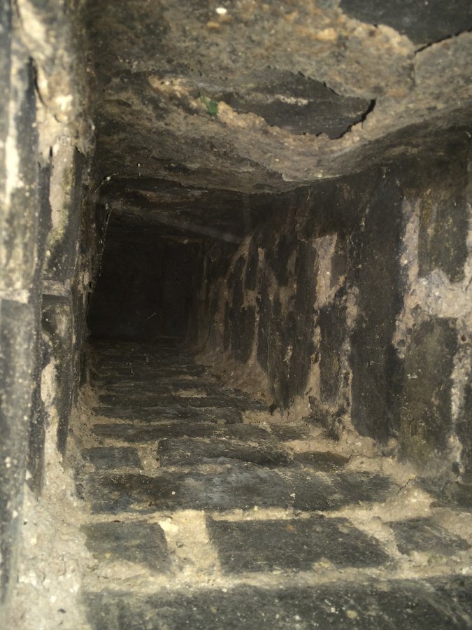

Photos added before skimmed plastering, and Inside loft of Chimney Brest that is removed

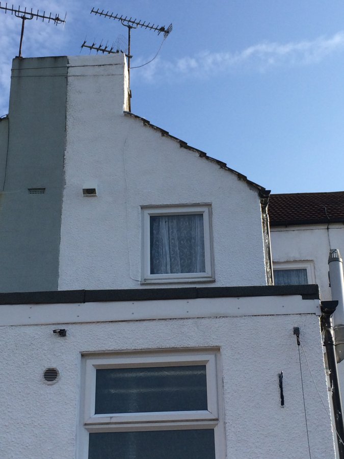

Just to add also this is what the property look like from the outside. White pebble dash render. I manage to get on the Flat roof to inspect and could not see any large cracks. the wall has been painted. But just around the windows frame it sounded hollow when I tap it. but as the internal images show it is around the windows and away from it in sections. but the render towards the left of the windows sounds ok. hope this helps

Its probable that the render was originally applied because there were
problems of damp penetrating the solid wall & appearing on the interior wall surfaces.
The only suitable paint for render is masonry paint - if you have whats called "plastic" paint then it will make things worse. Moisture will be retained in the wall.
If the render sounds hollow then its blown and will have to be renewed.
When the bed room chimney breast was removed its possible that the sooty brickwork was not wire brushed and blinded with SBR for example. A sand and lime render mix should then have been applied not a gypsum plaster.
The patching and skimming carried out by yourselves is useless it wont prevent damp or condensation.
Hacking off the plaster on the external wall, including window reveals(?) and back say 1m on the return wall for the full wall heights, and then treating as above would be the way to go.

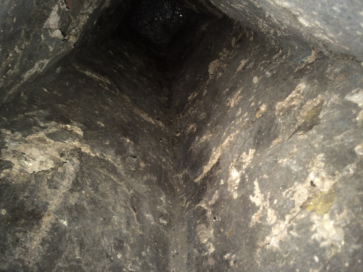

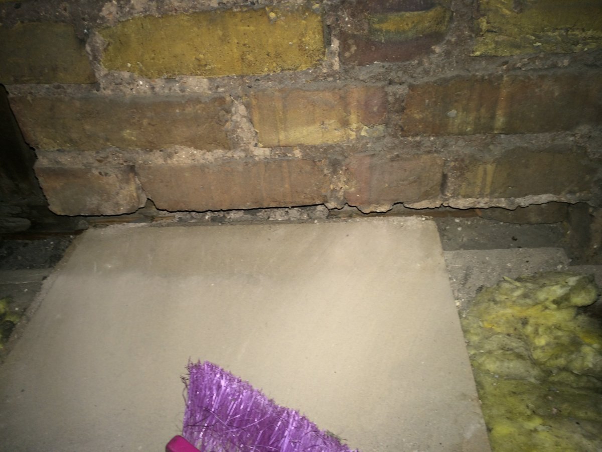

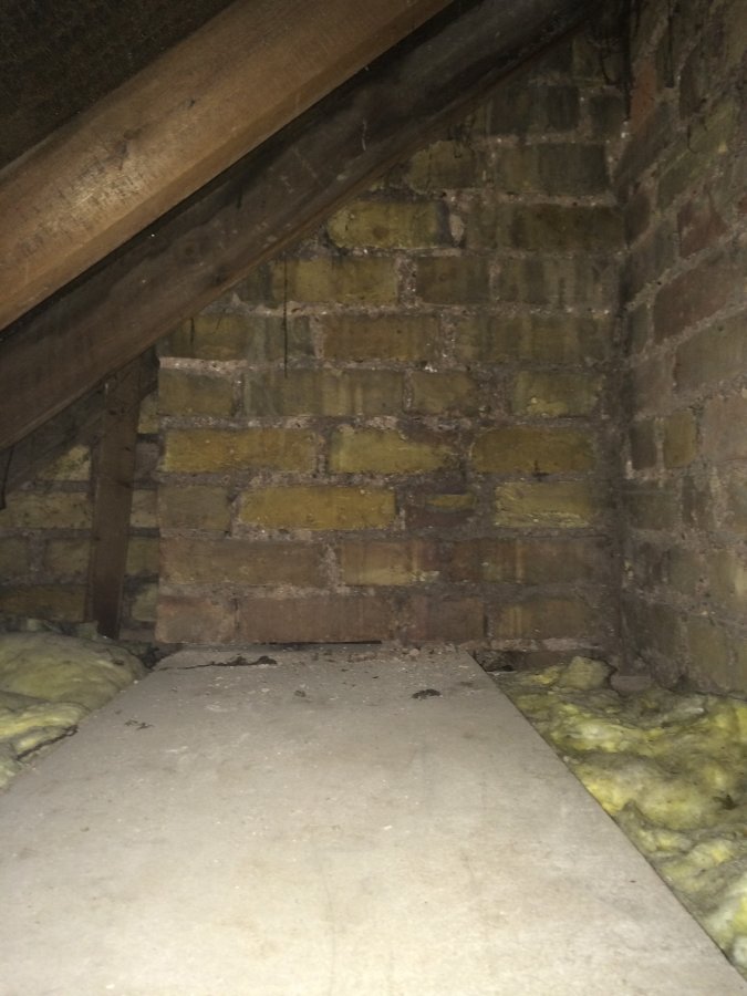

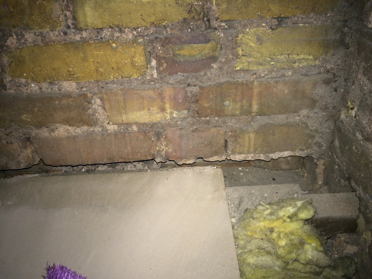

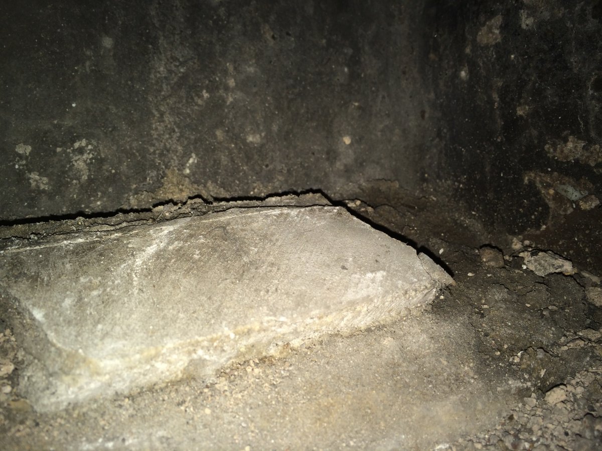

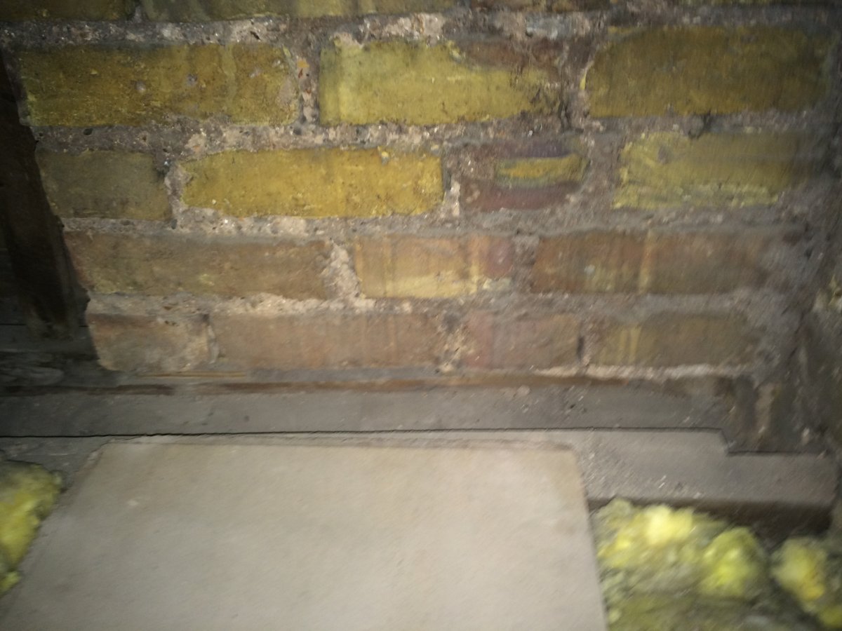

Have taken a few photo of what is left of the chimney from the loft area and have added these here.
Any further help of advice would be great.

I can see a lintel supporting the remaining c/breast - what material is the lintel: wood, steel?
How have you managed to take the photos showing up the flue?
If the render is loose then it must come off - typically, its the best practice to remove all the render rather than try and patch.
Remove all the affected, internal wall plaster from the outside wall & the party wall - then render as above. Only SBR the sooty area.
This way you at least take care of two variables.
Your verge has not been bedded on an undercloak.

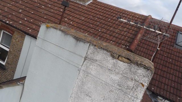

Rendered chimney stacks are a constant source of trouble - plus I dont see any flaunching or chimney pots? Is the stack lead flashed?
Only a possibility but moisture could be entering your property from your neighbour's side of the stack or the roof?

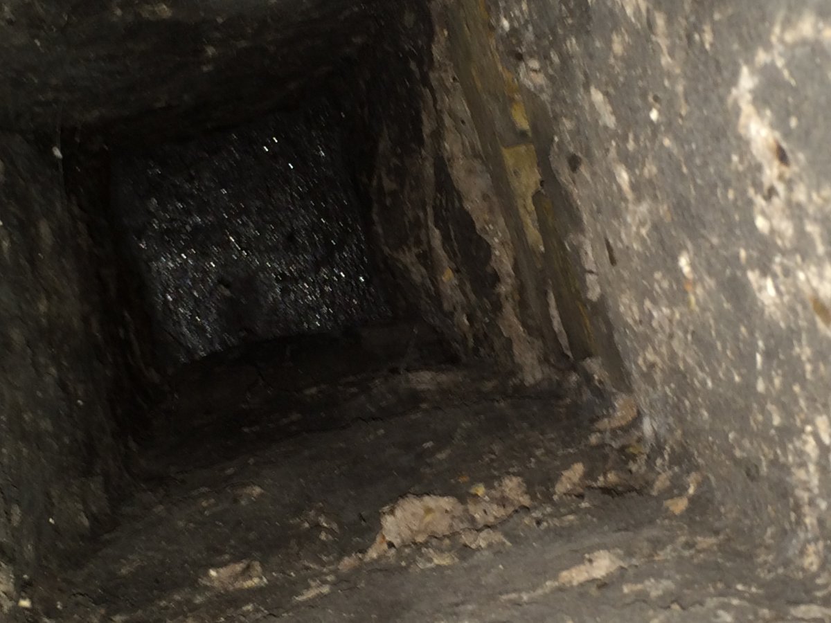

What is photo 216.6 showing?
Hi,
Not to sure about the Lintel but do believe it maybe wood as did not see any steel in this area.
As for taking the photo, The Chip board that you see in front of the remain stack (photo 1801) this can be pulled forward and you can just about fit phone under to take photo, either side. (Photo 1755 & 1750 are how it looks when board is pulled out) Though the chimney is rectangle when looking it looks like it maybe 2 separate flue's is this normally.
Can i just ask do you feel that this could be 2 problem Rear of house being caused by Blown Render in places and Wall adjoining neighbours to do more with the Chimney area?
Can i just confirm when you say the Verge is not bedded (what does this mean?)
The Chimney stack have been totally capped off so no chimney pot or flaunching. It does have lead flash around base of chimney stack have had a few roofers in and all have said this look okay. 2 Years ago when problem first started before we had chimney fixed it was cracked as shown in picture attached.
Photo 216.6 is under chimney at the base
Now have been in loft area when it rains and have never seen any water running down from wall or felt and felt looks to be in good order to. However when it does rain walls are definitely becoming more wetter on both sides. Now today it did pour down. and took damp meter reading before and after. In most area it seem to jump between 3-5 % higher after rain. All wet looking patches seen in 0855 photo below are reading between 20 - 29% where as most other area are between 12-18% We also placed outside as well and wet patches are similar measurement outside as well and what seems to look like the dry patches are much lower.

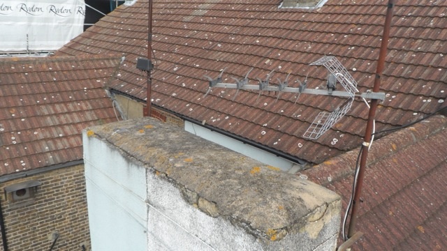

Your wood lintel & chipboard support are totally inadequate for purpose but the c/breast must be well tied in to keep hanging there - anyhow, now you know.
The skim of mortar on the stack is fragile, and no venting can be seen.
The stack render is failing and will allow moisture in.
The stack flashing cant be seen either, so i cant comment on it.
I can only repeat what i suggested above - forget about solving mysteries with a "damp meter" and simply hack off and render. If possible, work with your neighbour but keep it simple.

The chimney i meant chipped see picture 97.9 the front edges. Ok my question with the chimney is that it is totally sealed from the top as seen in picture 113.6. yes there are no vents. some people who came out said that it is not necessary to put vents and my neighbours chimney is the same design.
My question if there is a problem in the chimney would it possibly effect the external wall by the windows area as shown in pictures i have supplied. as like i said before the external pebble dash render has no visible cracks and been painted. but i can hear hollow sound only in certain small patches and most around window (but not all of window) and not in the middle of wall . would this cause so much damage to the was as shown in the picture?
