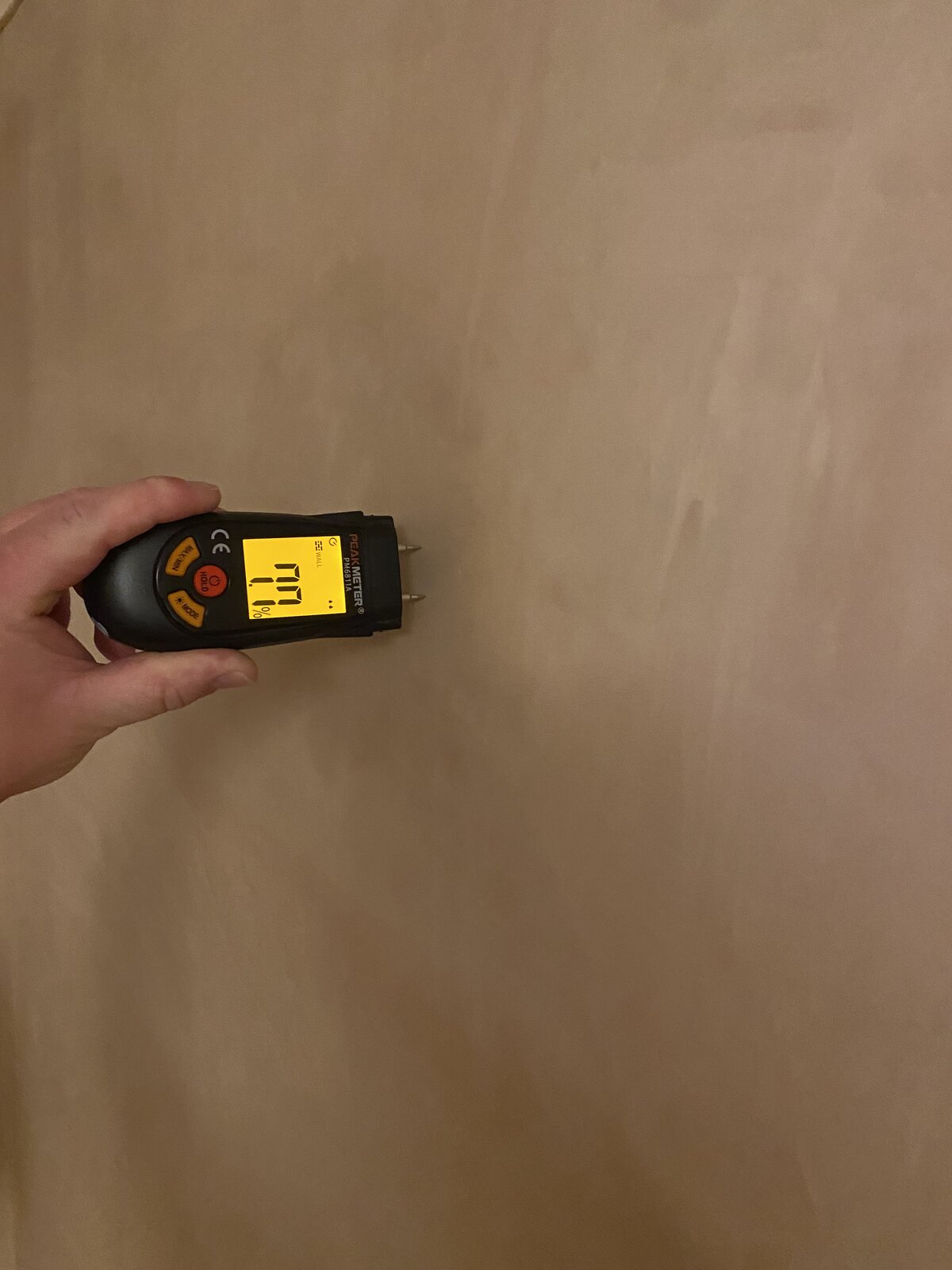

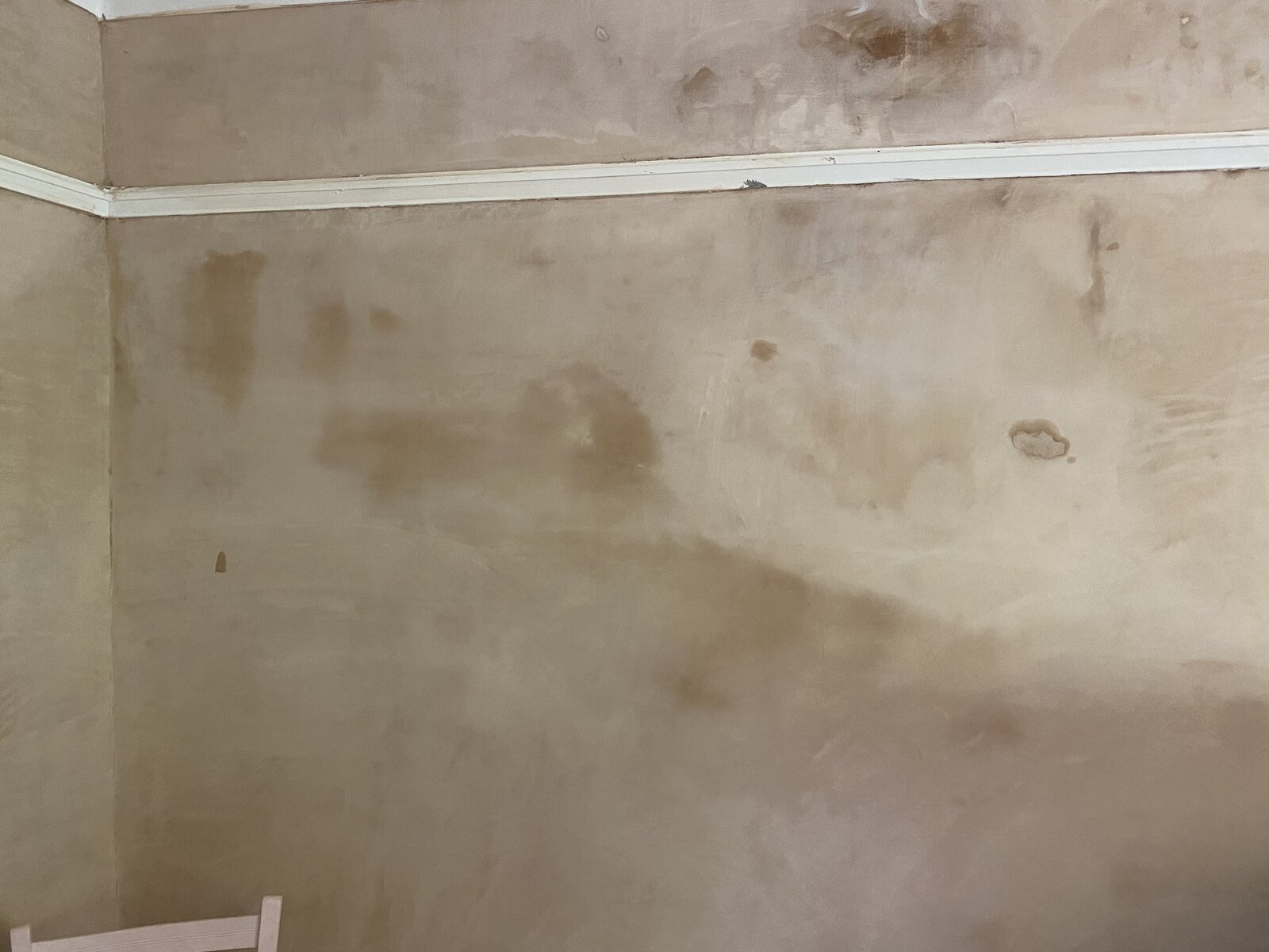

Good afternoon folks,
In March 2025 we had two rooms replastered. Both of which are now showing random patches of damp.
We have recently had the chimney removed. The builders did a terrible job of putting the felt back where the chimney was. We had this remedied by the placement of eave support trays, so there are no leaks in the gutter and no water runs off the fascia boards now.
However, we are still getting damp patches which are exacerbated when it rains, not by size but by severity of damp. Would could be causing this?

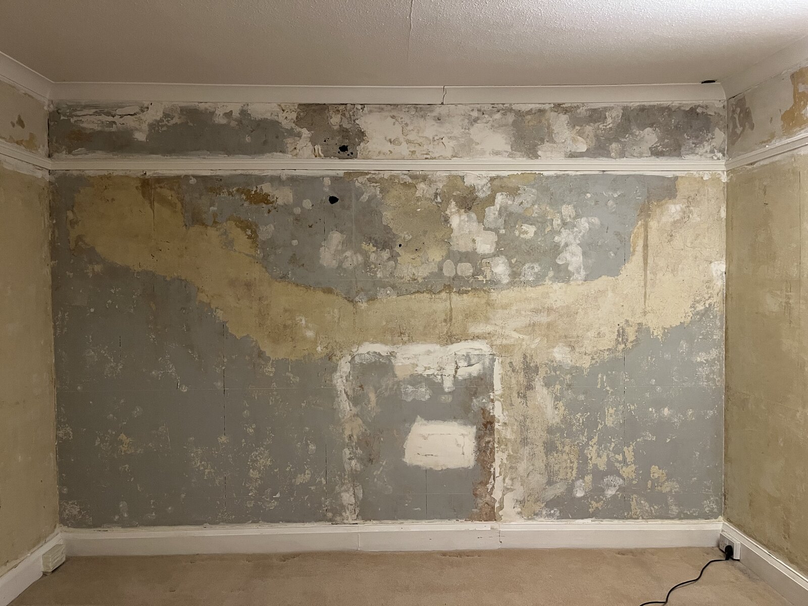

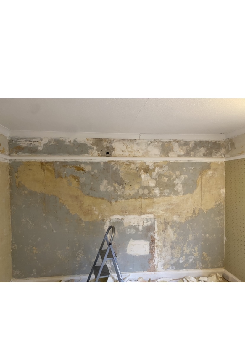

The new plaster is gypsum - I’m not sure whether the old plaster is lime or not (photos attached for reference of old plaster). The damp in the bedroom follows the lines white “wings” in the old plaster above where the fire-place was (shown in image).
The house is pebble-dashed, build in 1935 and detached.
What could be causing this?

Are the bricked-up fireplaces open at the top? If you have a large drill, it would be helpful to drill a hole just above the skirting. This will start to give a little ventilation to help dry out the cavity, but will also enable you to sniff it and insert a finger to see if it is damp, and to probe inside to see if the cavity is full of wet rubble ( builders like to throw rubble down chimneys and into fireplaces to save the effort of barrowing it out)

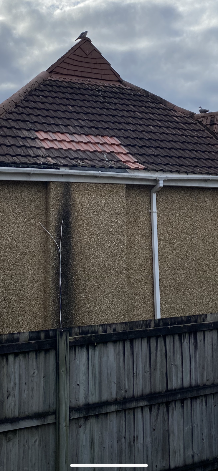

Attached image shows the roof on the affected side. The black mark is now inactive - was from the chimney which was buggered. The pebble-dash is not blown here.
This damp is on the first floor

The guttering looks modern, but surprisingly crooked. See if you can borrow some binoculars, or a long focus lens, and see if it could be spilling. Look during and after rain. The damp pattern seems consistent with a roof or gutter fault.
