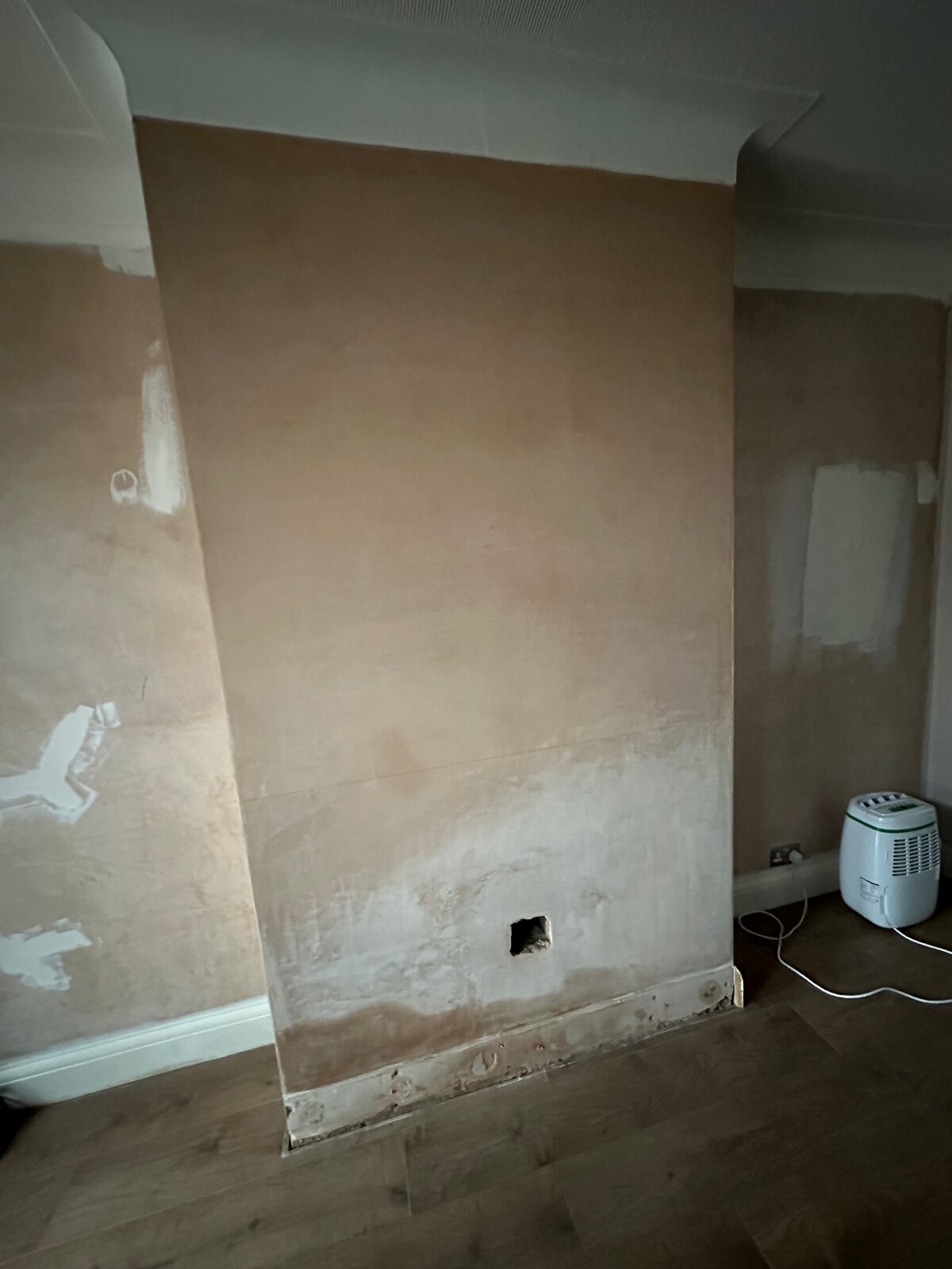

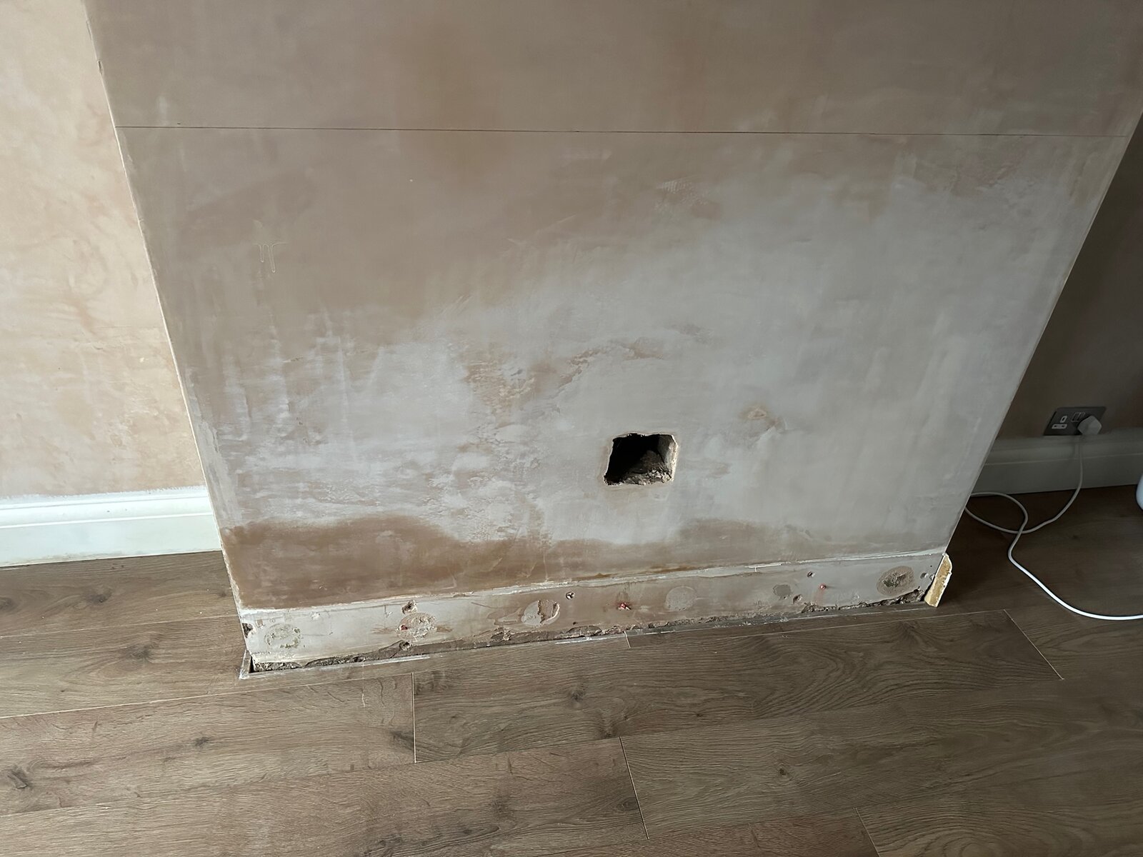

So there was no rain overnight, and perhaps a light drizzle in the early hours. I was just looking at the chimney breast, and it looks noticeably worse than it did yesterday and on Monday (when I took the original pictures).
I've booked in a plasterer to hack back to brick and then build up with Limelite Renovating Plaster and then skim with Limelite High Impact Finishing Plaster.

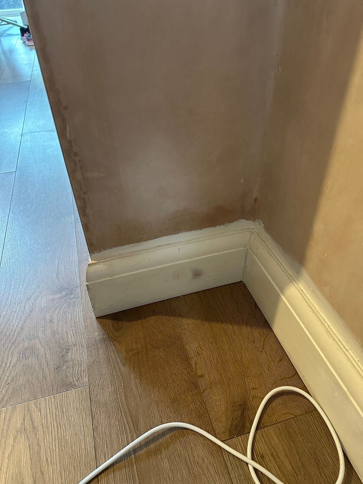

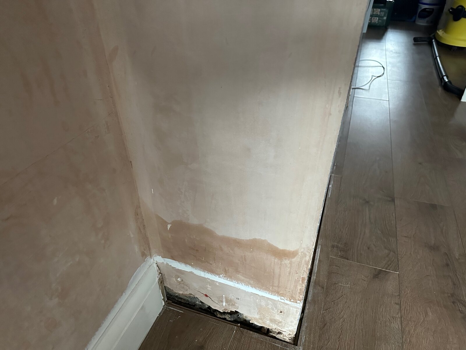

It would be very useful to look under the floor.
And some photos of the other side of the wall.
Good shout, about looking at other side, never noticed that area before up until now.
Getting to the floorboards is going to be a pity, due to the laminate flooring, with the subfloor running perpendicular too...

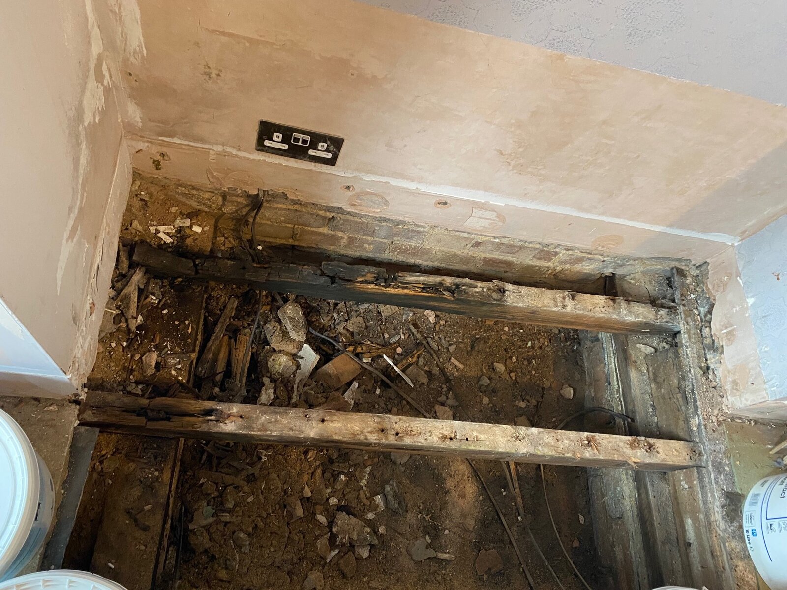

We had these out a couple of months ago, and I did not notice any water at the hearth.

I wouldn't be surpised if water is soaking up the rubble under the hearthstone. It goes down to the original footings. There will be no DPM. You can break it up and dig it out. As well as removing the path, exposing the bare brick allows water to evaporate off. You may also discover a source of water down there.
Thats a massive job, could I not use something like Dryrod Damp Proofing Rods DPC Kit
Drill and insert these rods at the base of the breast (where the flooring meets not below the subfloor), then not having to rip out the flooring?
OP,
Without permission, how would you follow the above suggestion to inspect your neighbour's chimney breast & living room wall?
Just one look & your pics make clear that there is no "hearthstone" - neither is "water soaking up the rubble" under a non-existing hearthstone.
Moisture in the enclosed soil rises by capillary action ie. rising damp.
But you have no need to be lifting any flooring unless its damaged or swollen. Carry on with the Limelite - & sweeping the flues.

I dug out a picture (excuse the pun), of when the joists were repaired near the chimney, this was at a point when there was still wallpaper on the walls. However, looking at the image closely, I do not see any tide marks.
