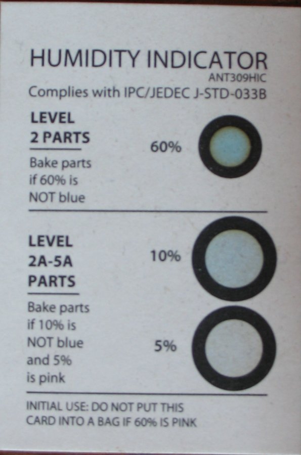

Hi J,
I get electronic components with a damp indicator within the sealed bag, here's a photo:
You would need to put it in a seal-able container, dry it out till the indicator showed blue, then put a measured amount of your damp drillings inside, and see what the reading is. Some experiments first to get the process.
Damp indicator Cobalt Chloride. http://www.ebay.co.uk/itm/25g-Cobal...152662?hash=item4639c88296:g:WlQAAOSwBahVRLJ4
