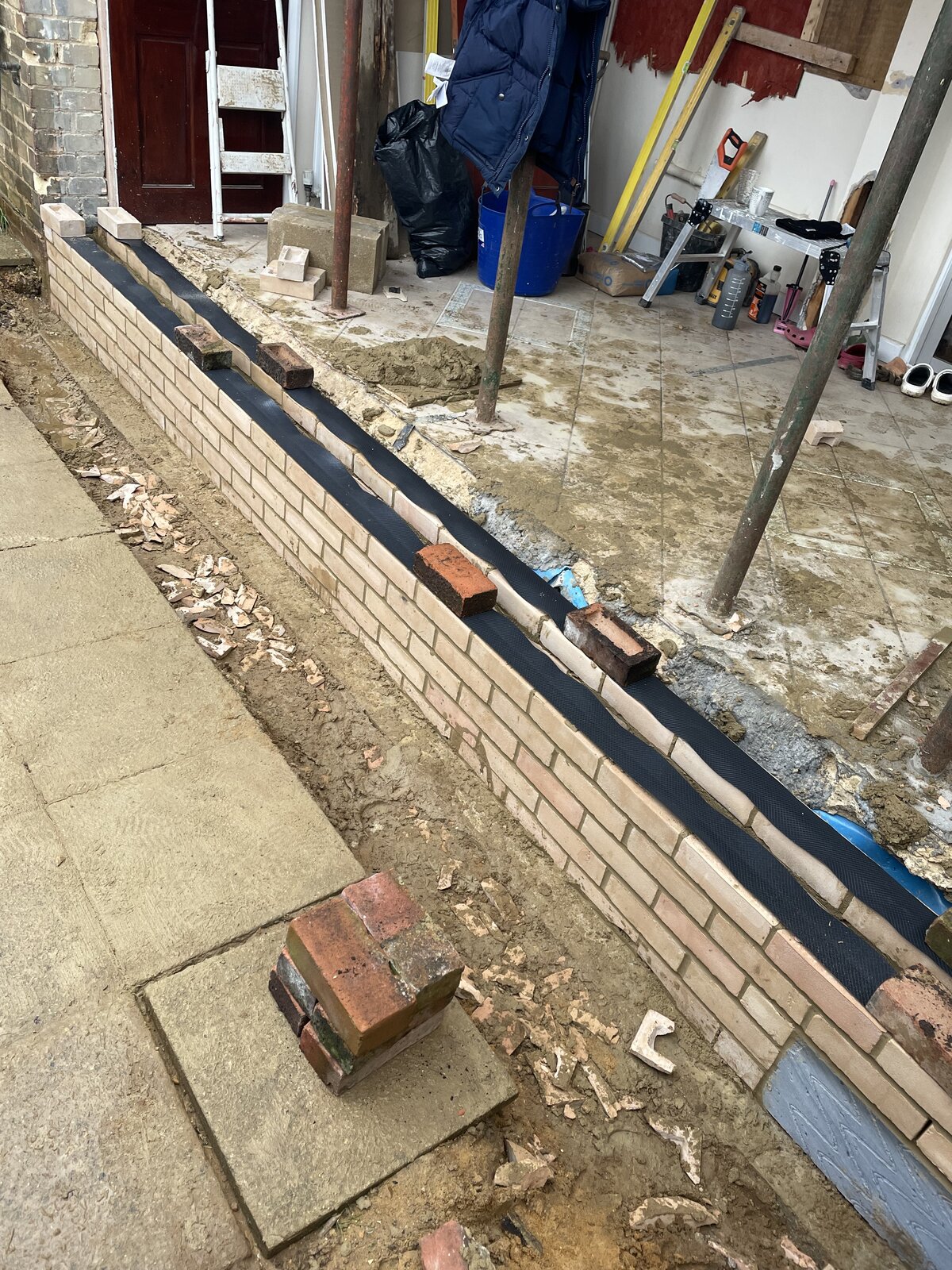

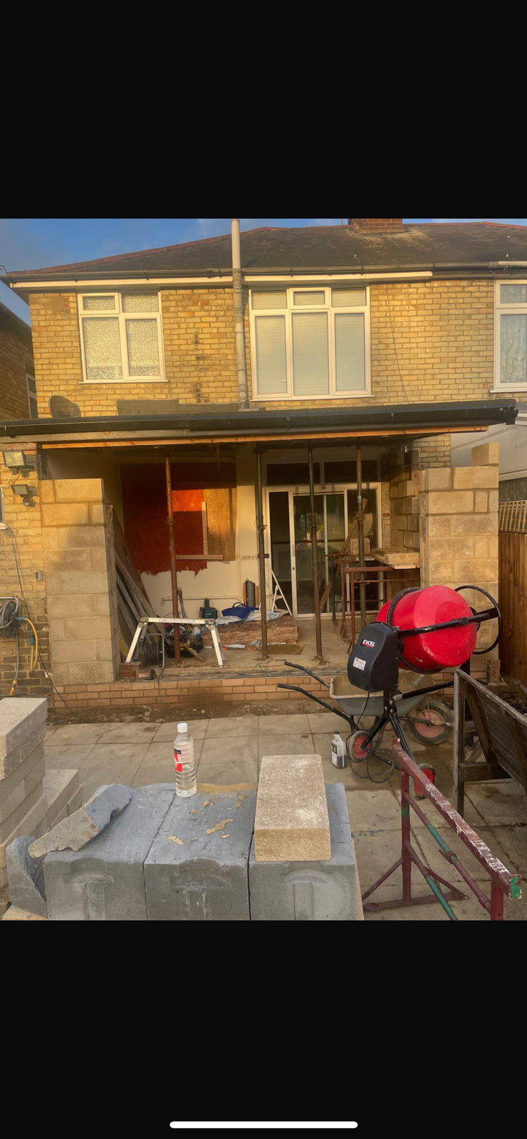

What to fill cavity with inner and outer block work for bifold.
3 Jan 2025
3
below pictures of brick work,with regards to the gap in between gap for bifold what shall I fill the cavity as it the same height as exiting floor level
As far as I know you should have concrete in the cavity to 6inches below the DPC and cavity closers for the sides.
Yeah I have done this I am just wondering about the floor level cavity ?
