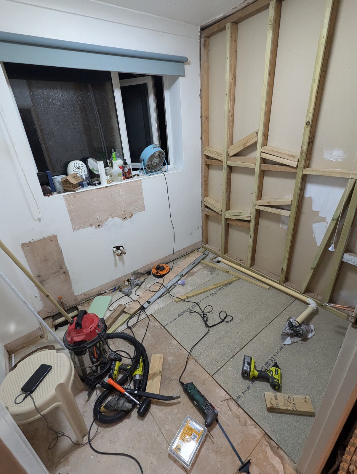

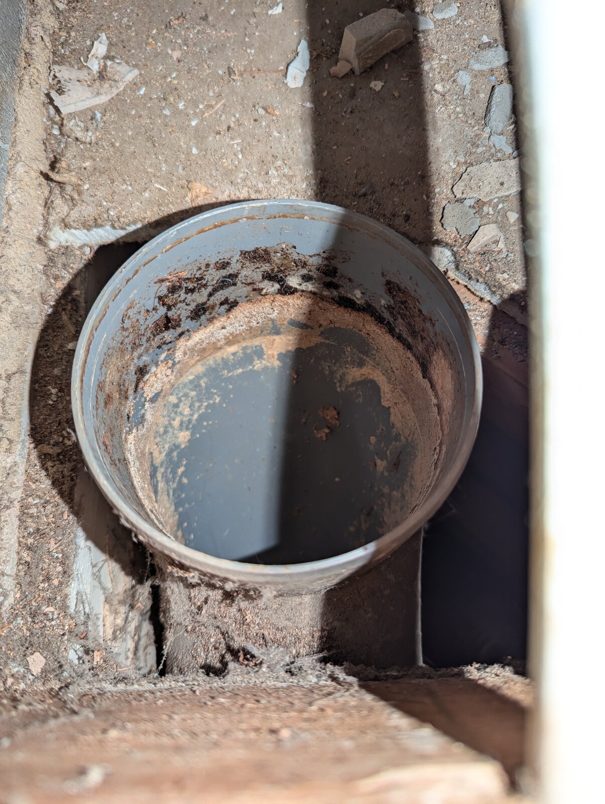

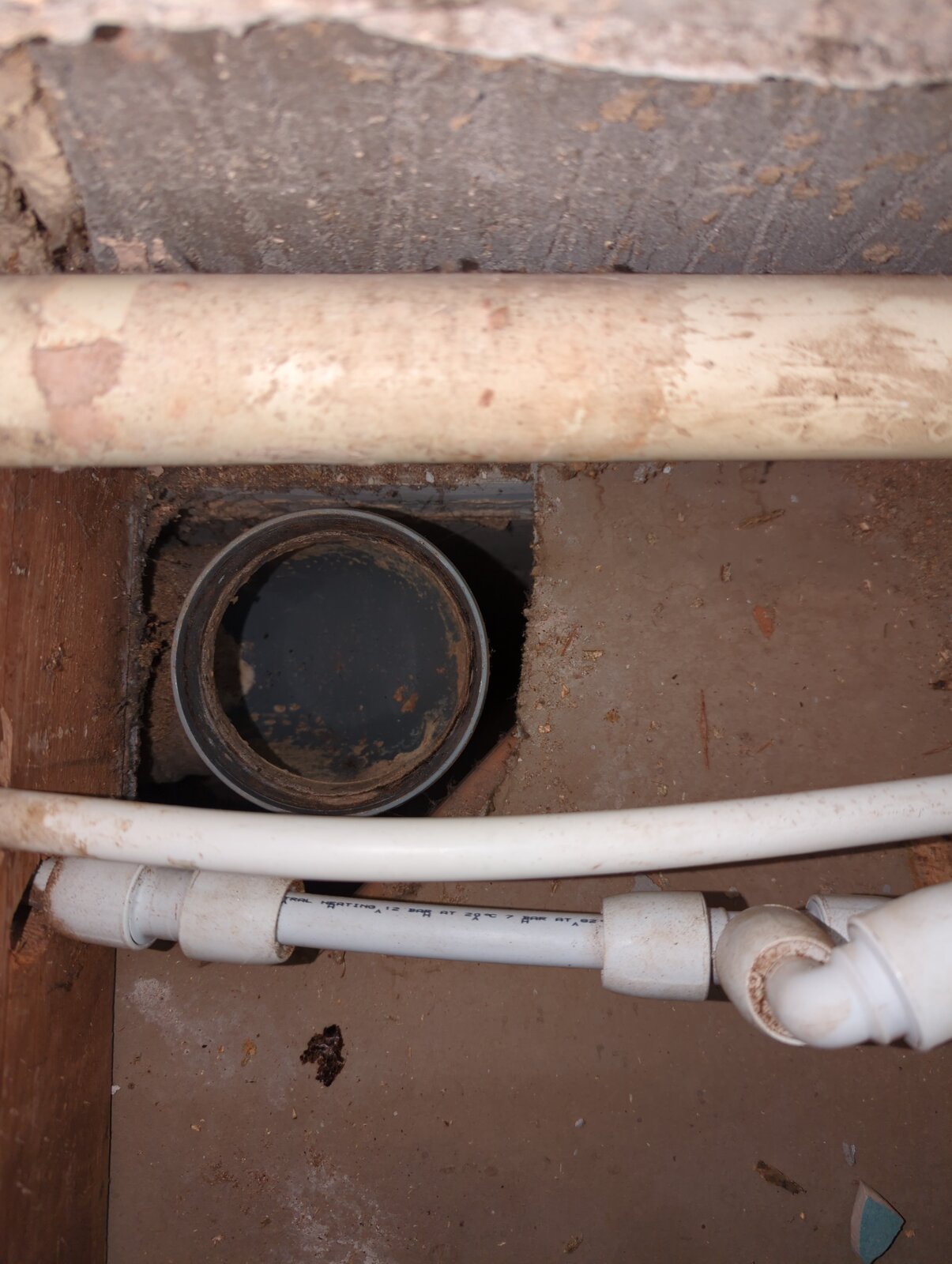

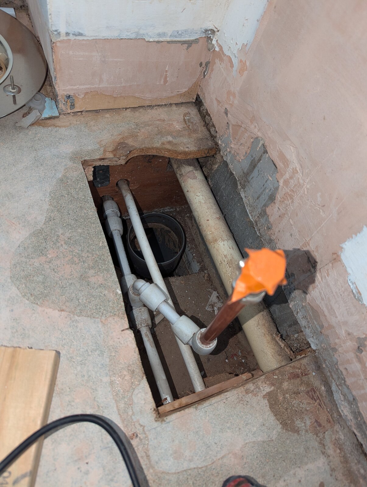

Hi all,
Just relaying new bathroom subfloor and wondered what I should do with the waste pipe so I can make my cut outs on the flooring. It used to be a long Flexi tube connected to this so is it best to replace it with the same? (If so any recommendations)
Or would it be best to have a sturdy pipe extended to meet new floor level first and then attach the Flexi?

Measure the diameter of it and go from there. I would always advise rigid connections.
Thanks, it's about 10.5cm

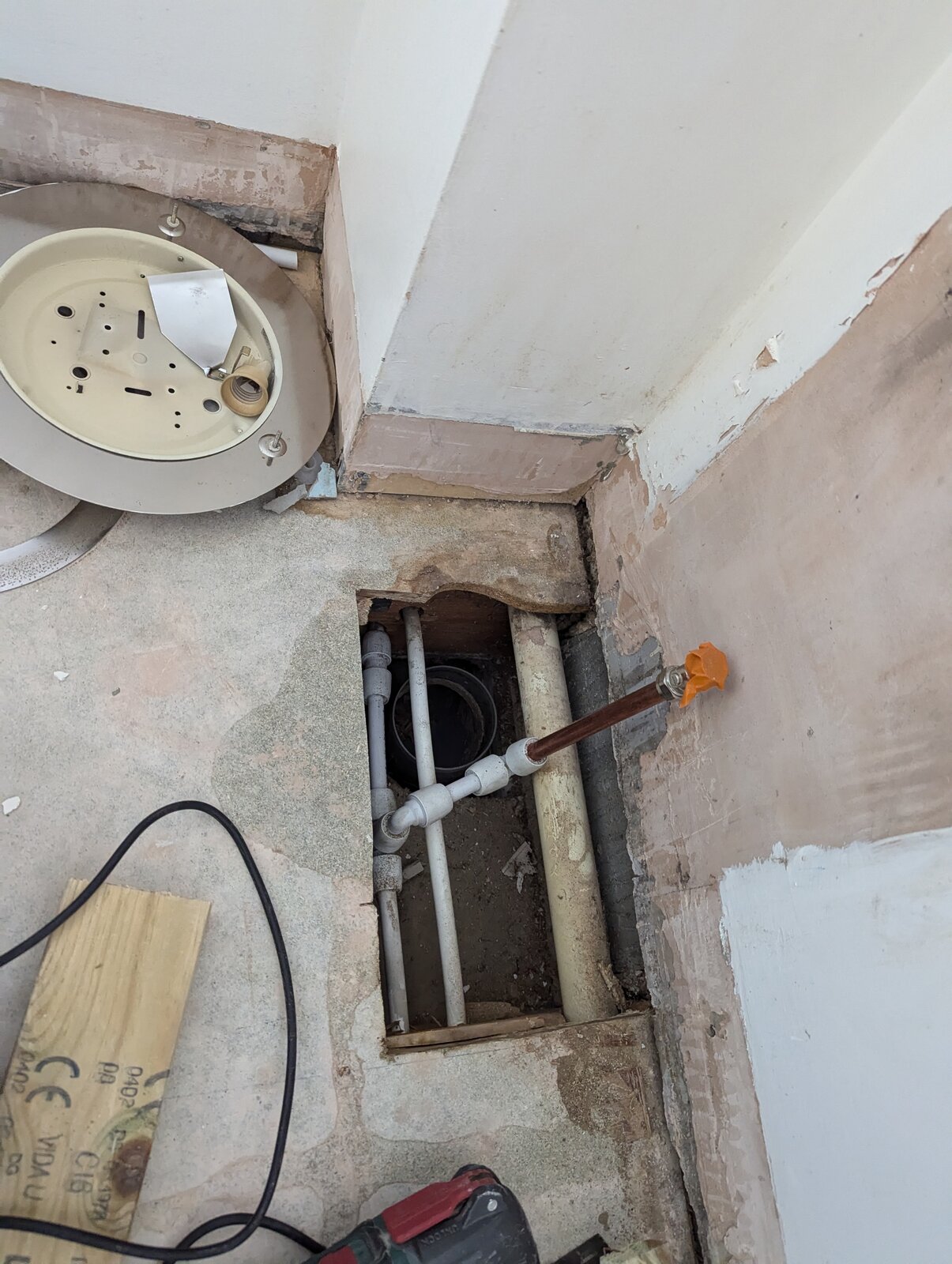

I think I will need to have a Flexi due to locations of the other waste pipe and water pipes. Be quite hard to position the waste. The actual gap between the smaller waste and water is about 8.7cm

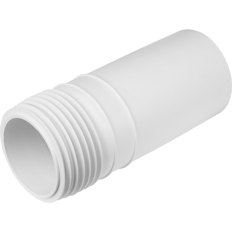

Could I use something like this? Could work as the middle section of the pipe seems slightly smaller. If so, anyone know of this is a simple push fit or best to use glue/silicone?

The one that @Hugh Jaleak appears to be the same diameter and would probably work better. If you want to use yours, when you connect the 90 degree connector you'll need a short piece of pipe in between as it may be susceptible to a leak. The other one doesn't.
Thank you so much. Do you mean same dimensions for both Hugh's suggestion and mine? It seems to be.
I was mainly trying to use the one I found to make the soil pipe rigid (as suggested) below floor level. Then as I'm likely to have a back to wall toilet, I would then use a Flexi to connect the one I found to the toilet.
Will this be ok?

It should be ok, but as I say, if you use the one you suggested it may leak unless you put a small piece of pipe in between. I have used plenty of the one like Hugh's and can't remember having an issue. If you search for an extension rigid pan connector if you wanted a more rigid one.

Ive managed to chisel out the hole on the joist so that the water feed pipe can move slightly more to create a bigger gap above the waste pipe.
Hopefully I can get the pipe you guys suggested.
Would I need to add any silicone/glue to that pipe or just simple push fit?
Silicone grease would certainly aid the installation but often just push fit. Do not use glue

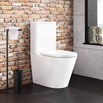

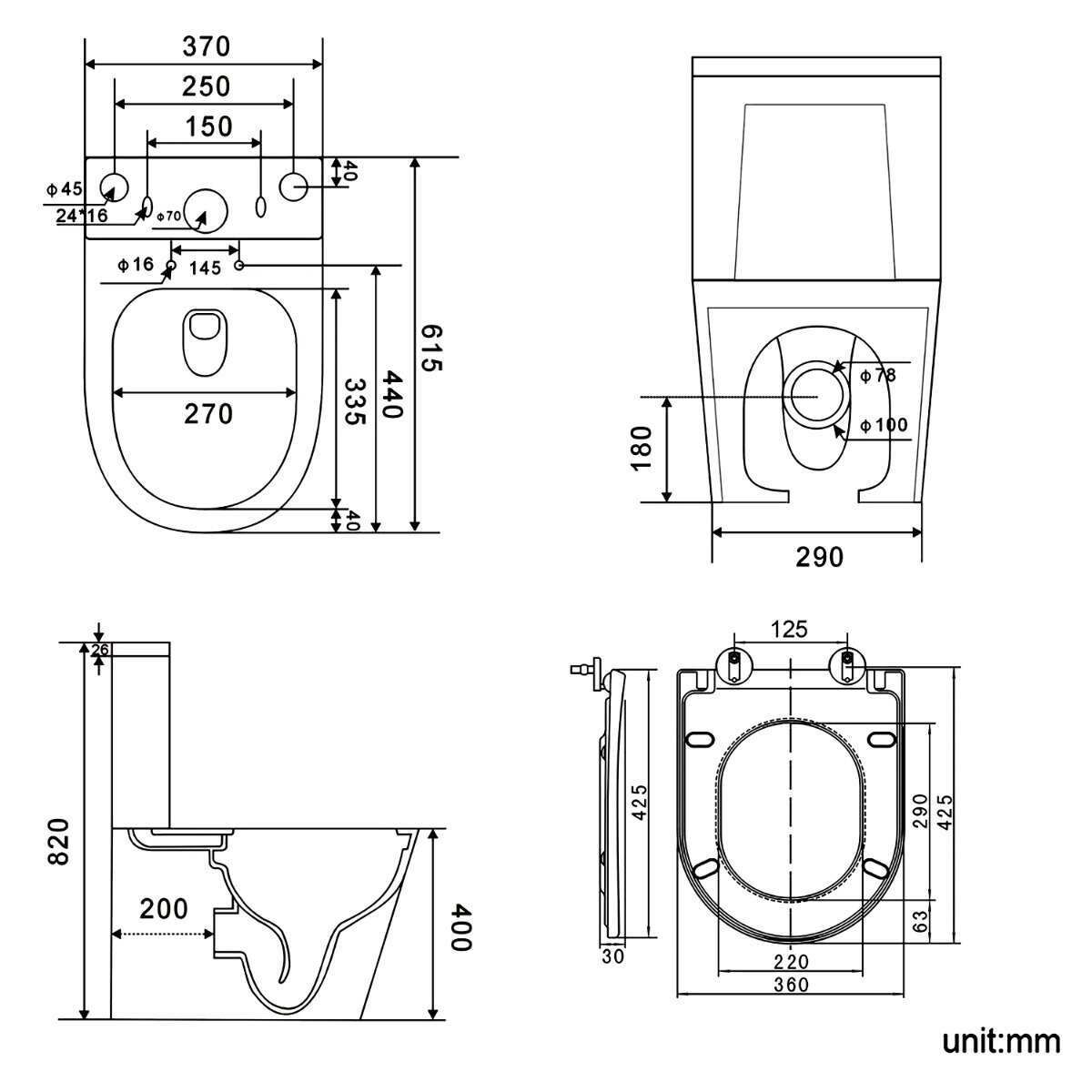

Thank you guys so much for your help. One last question, I was thinking of getting this toilet (see below)
Should I cut the extension pipe so it's just above the finished tile floor level or near the height to be level with the toilet connection point?
Difference would be whether to try and get the flexi doing the near right angled bend or a rigid 90degree and then Flexi being more horizontal (hope that makes sense).

The one I recommended is designed to allow the finned end of a Pan Connector to fit in snugly, and make a suitable seal. Ideally I would suggest you leave it so it's slightly proud of the new floor, and cut the flooring around it snugly to help keep it in place, then fit your Pan Connector into the extension section above finished floor level.
Use rigid Pan Connectors wherever possible!
