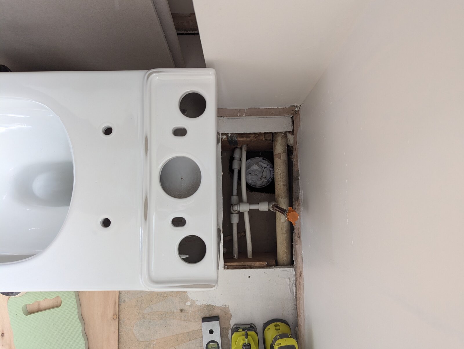

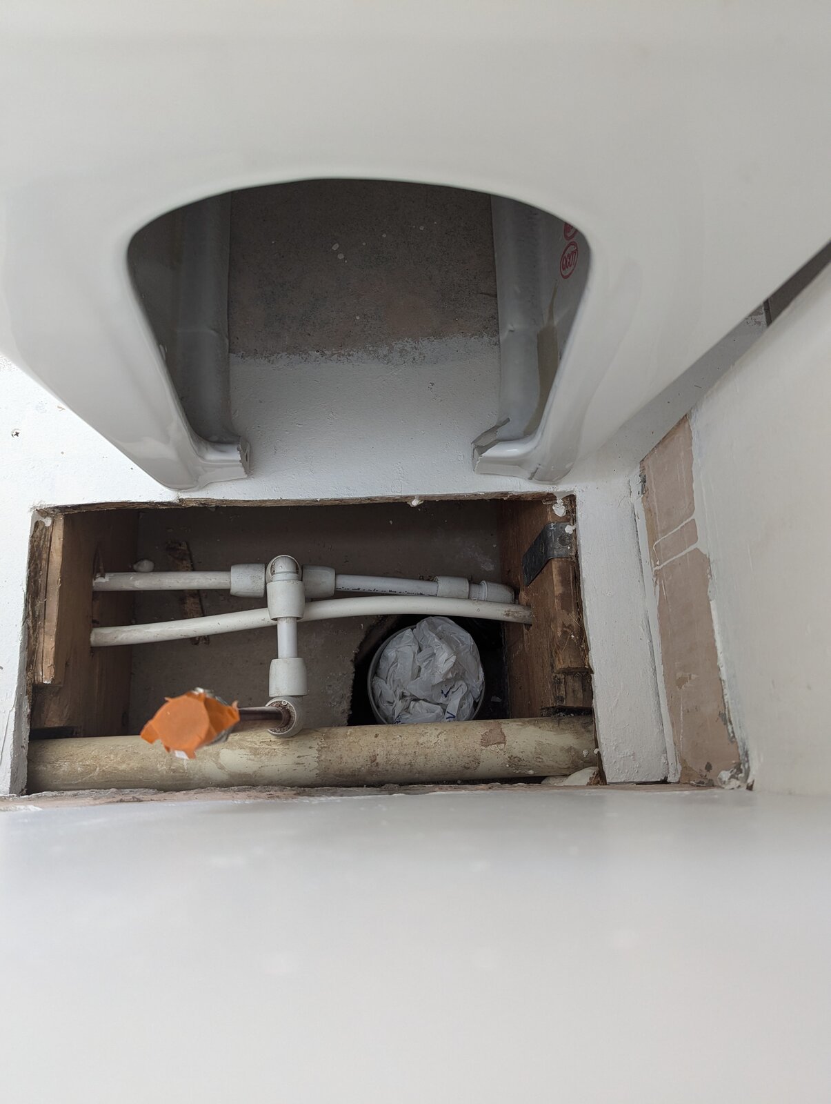

I bought the straight rigid extension but encountered a problem. The bottom of the back of the toilet has a lip which narrows the opening. It's a back to wall toilet so with where the soil pipe is now, I can't go straight up. In the photo, I've even put the toilet right up against the wall (boxed in corner).
I was wondering if I should get a couple of 45degree pipe connectors. But I seem to struggle to find these and/or they're ridiculously expensive.
Or should I just go down the Flexi pipe route? Now I know why they had Flexi previously

Flexi looks to be your only choice without major surgery on the soil pipe.
Thanks. I'm thinking that way as well.

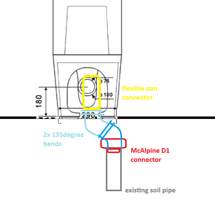

Is there a way I can almost creat a bracket at tile floor level to help keep it in place a bit better? Only asking as the the overall Flexi section would have to be massive as the pan spigot is set back a bit as well as the distance below current floor level
Maybe something like this could help?
Thanks. Greta idea but I effectively need two 45degree bends to make a 'chicane' going up. If I was to turn this 90degree end piece facing up, I think it may be a weird angle and would need another bend/angled piece. Don't think this would work as I've not got a lot of space to play with
Looks like including the extra space needed for when the toilet is pulled out, I need over 430mm. So looks like the Flexi would need to be 'up to 600mm' range. McAlpine doesn't do one this long so any recommendations for other brands please?
Flomasta? Flopast? Fluidmasta? Viva?
Wondering if you'd get away with a McAlpine DC-1 into the old collar, come off that with the 2x 45° bends or an adjustable bend, and then a pan connector?
I did originally think to try using two 45degree so it pops up close to the centre of the toilet. But can't seem to find many McAlpine 45degree bends pipes?
Any idea which adjustable bend you'd recommend. Google shows lots to choose from
