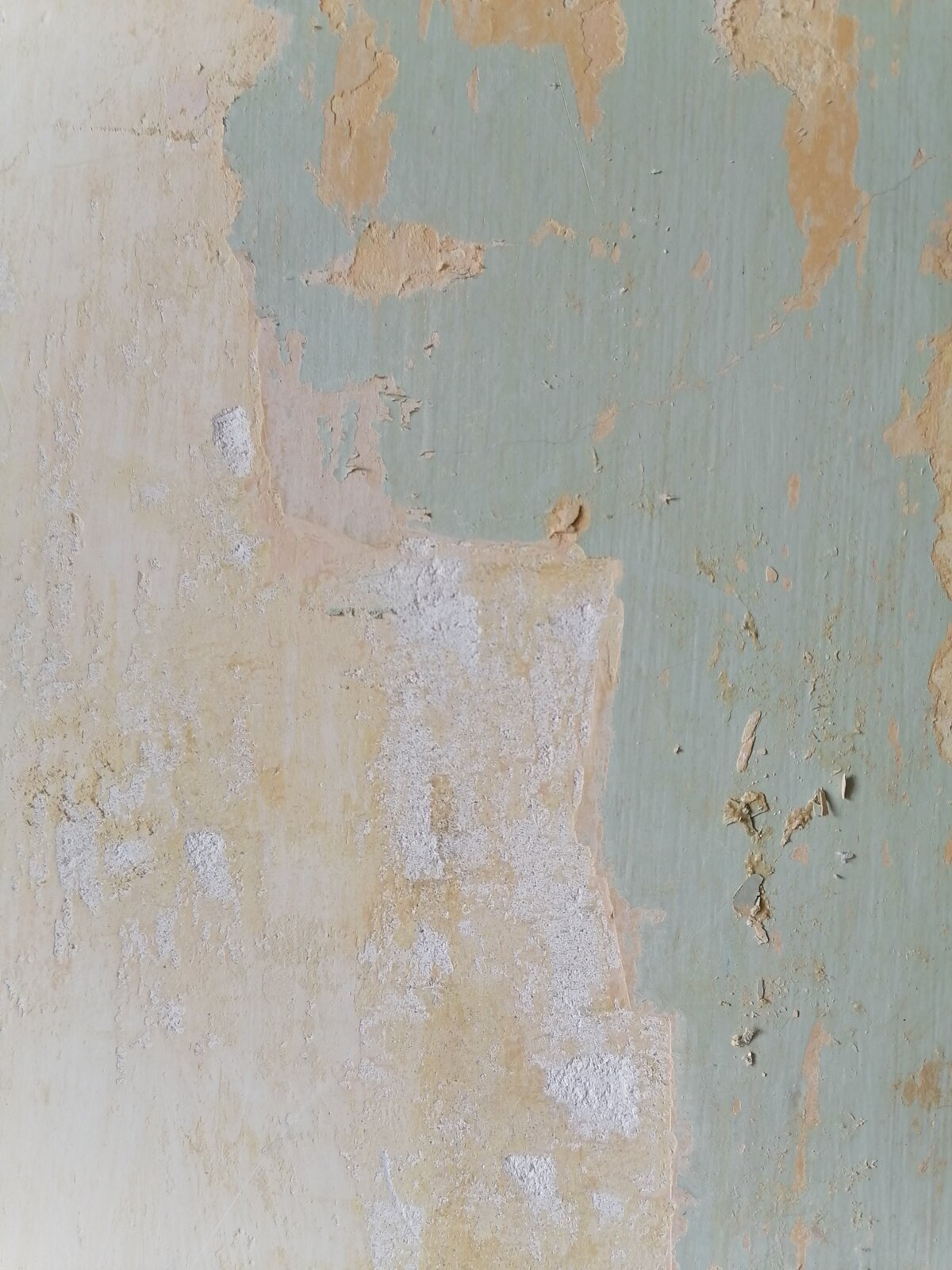

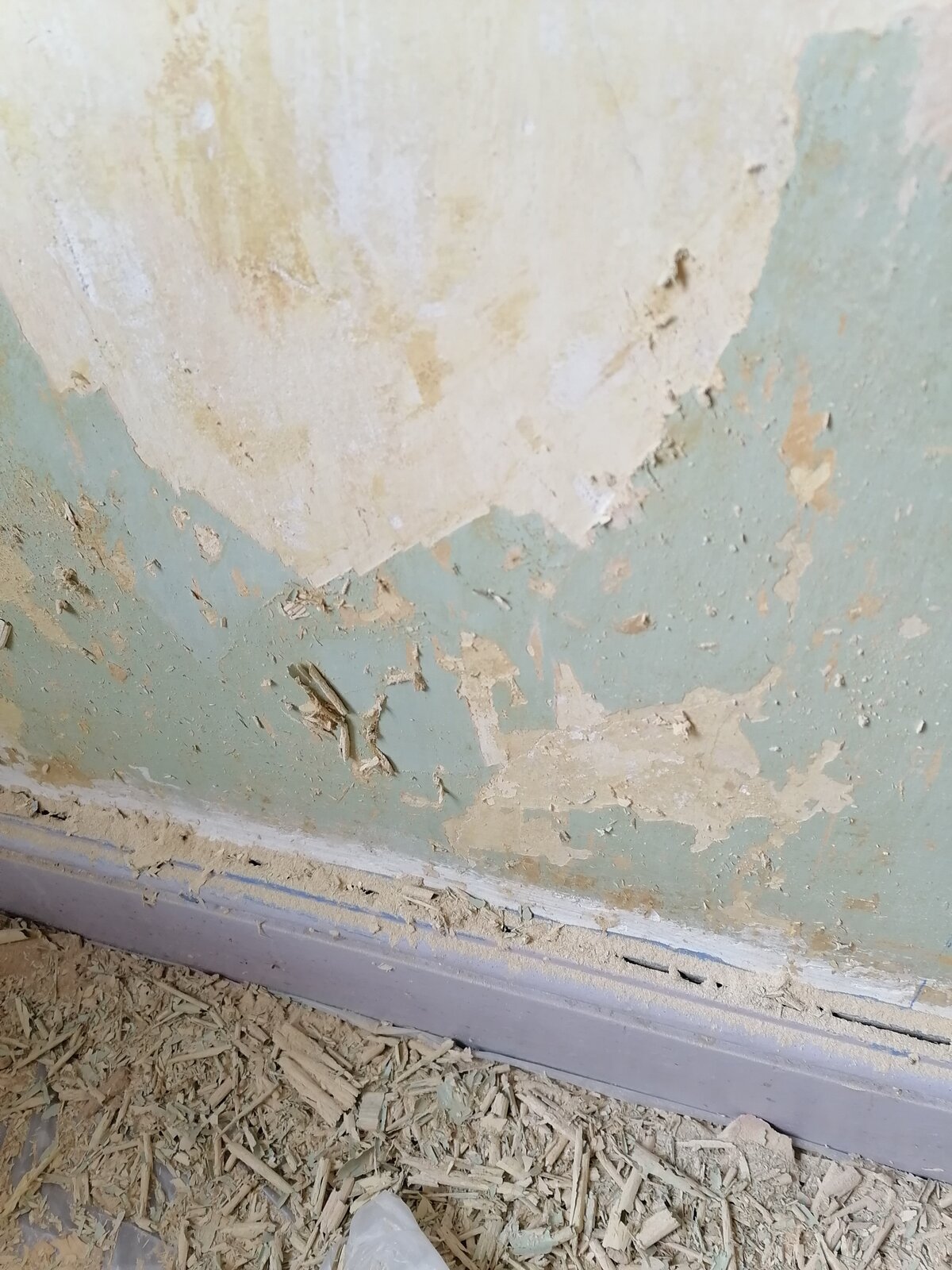

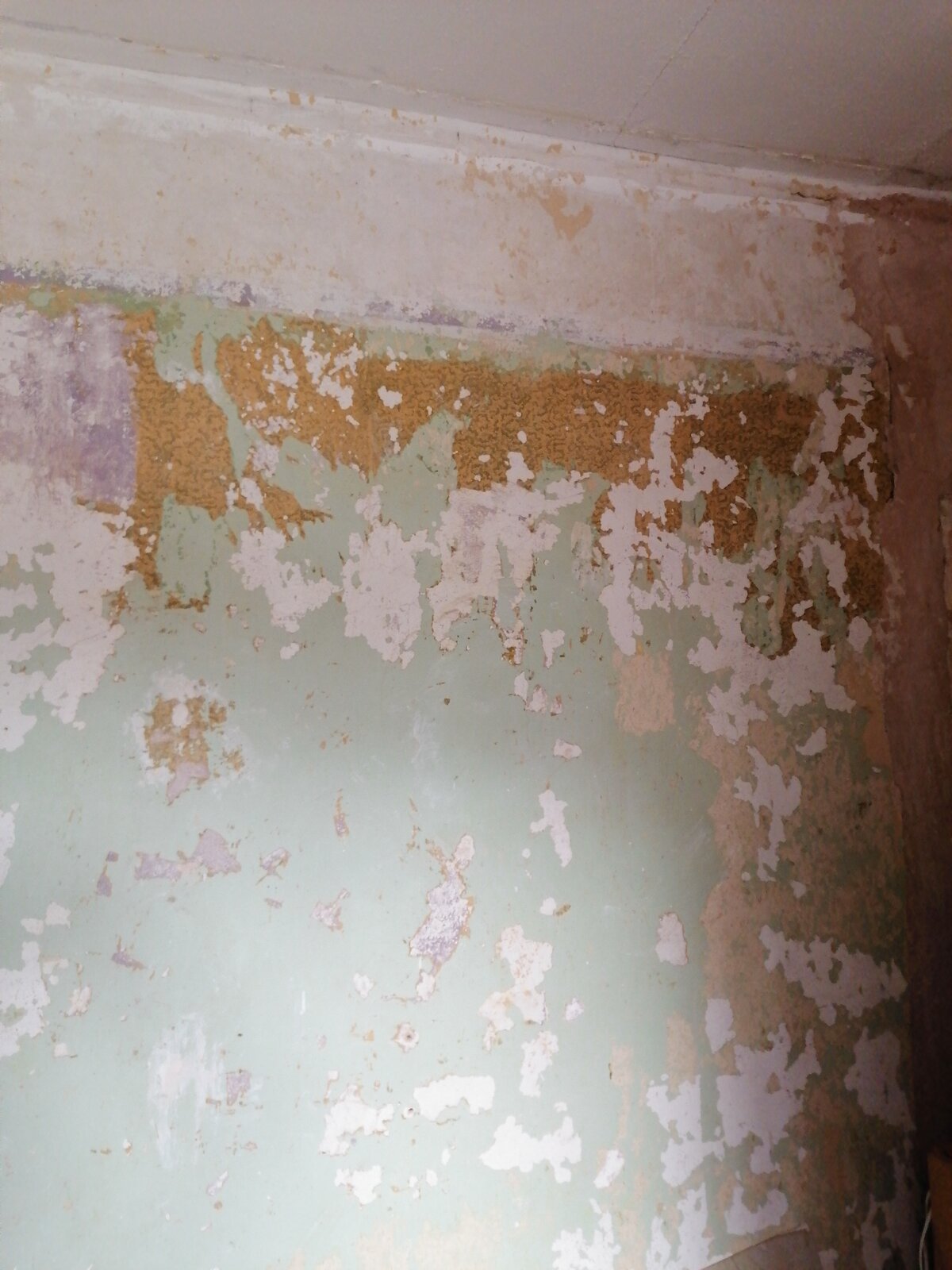

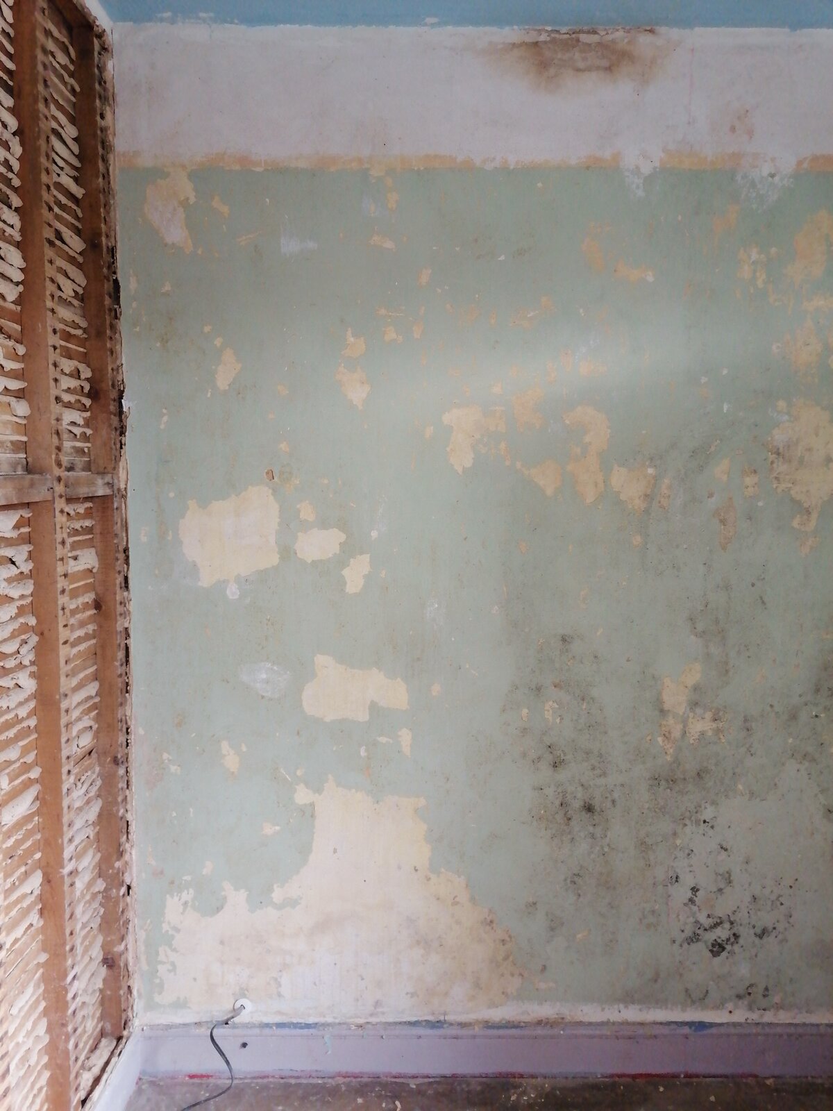

Hello,
I am trying to decorate some solid brick walls and just removed various layers of wall paper etc
After removing I am left with a pale green flaky in places type of paint? This is on lime plaster walls please see pics
I am assuming I am best off removing this before proceeding, if so any one have any tips? I will probably wall paper these as a finish on external walls and maybe skim internal walls
distemper
it can be scrubbed off with hot water but not with cold
it must be removed as paint will not stick to it.

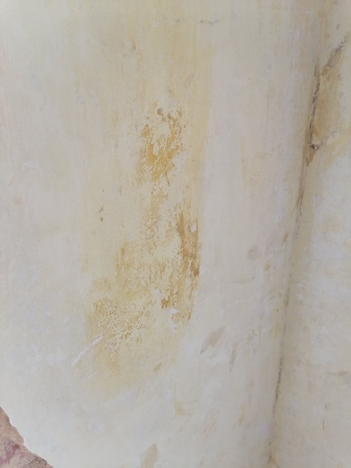

As an update, I removed the majority of the green flakey layer, now have a second yellow layer which is very chalky... So will be repeating the process. I think the green layer had been a sealer but had started to peal, it did have wall paper on which was tough to remove
