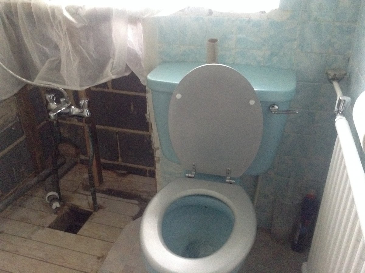

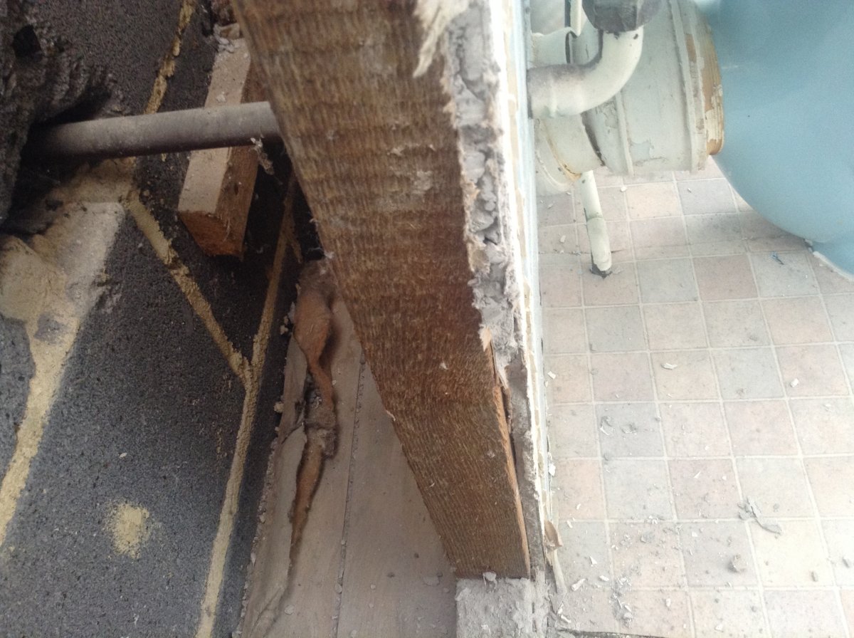

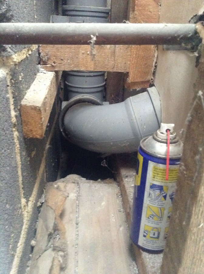

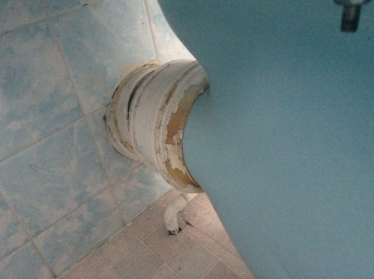

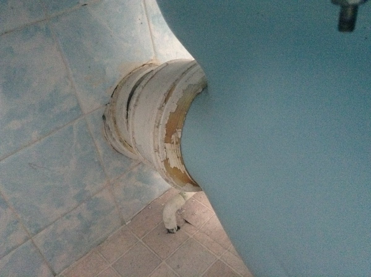

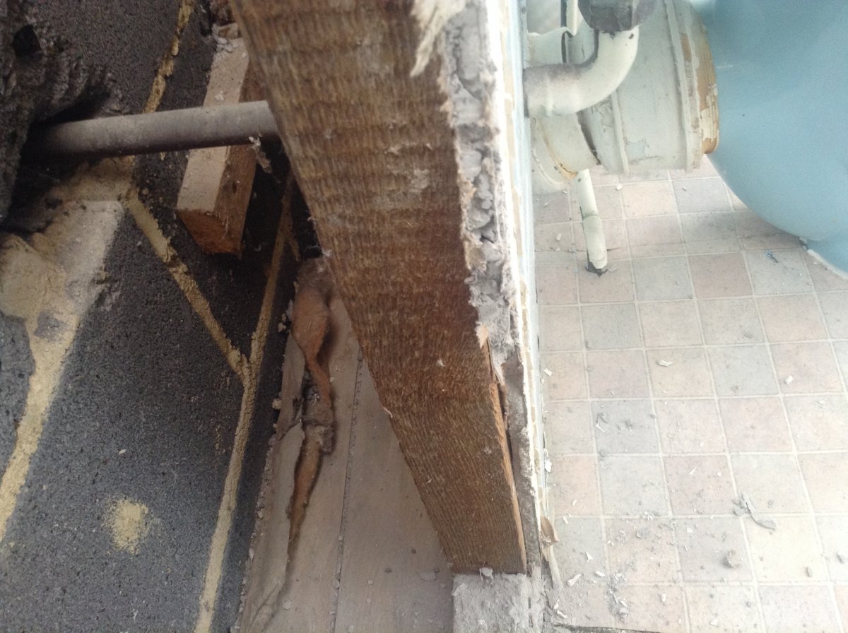

We are fitting a new bathroom in our bungalow, and don't know what to do about a new toilet. We wanted a back to wall, but not sure if our pipe layout is suitable. We have a 1960's close
coupled toilet now. The pipe goes IMG_1272.JPG IMG_1276.JPG IMG_1270.JPG IMG_1264.JPG straight out the back, through a plasterboard panel, then does a sharp right into the stack.
there is a void of 22cm between the panel and the back wall, where we could fit a cistern??.
Hi jean56, welcome to the forum.
That can be done, with a Hideaway cistern with remote push button and flexible pan connector.
Daniel.
