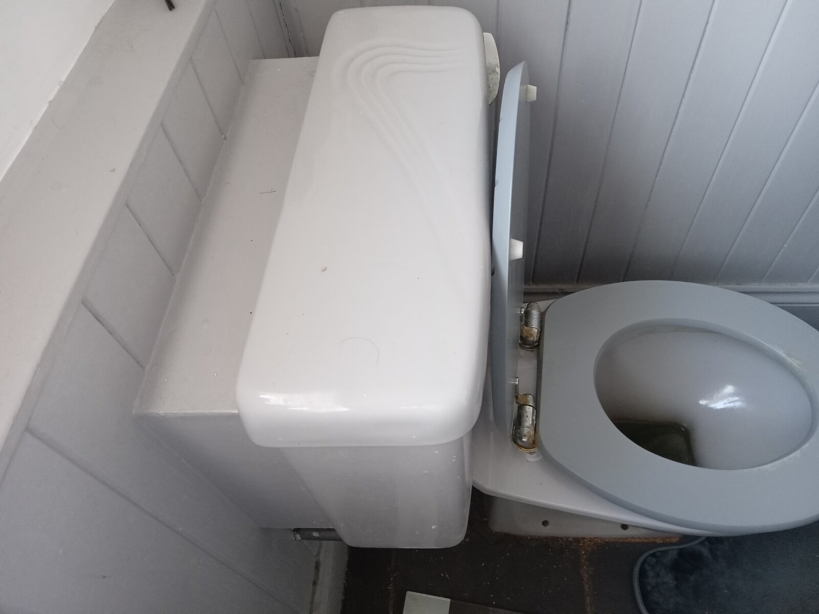

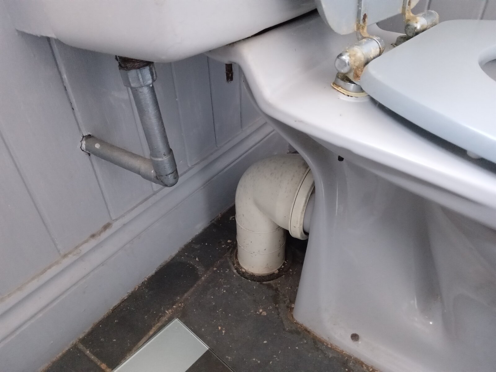

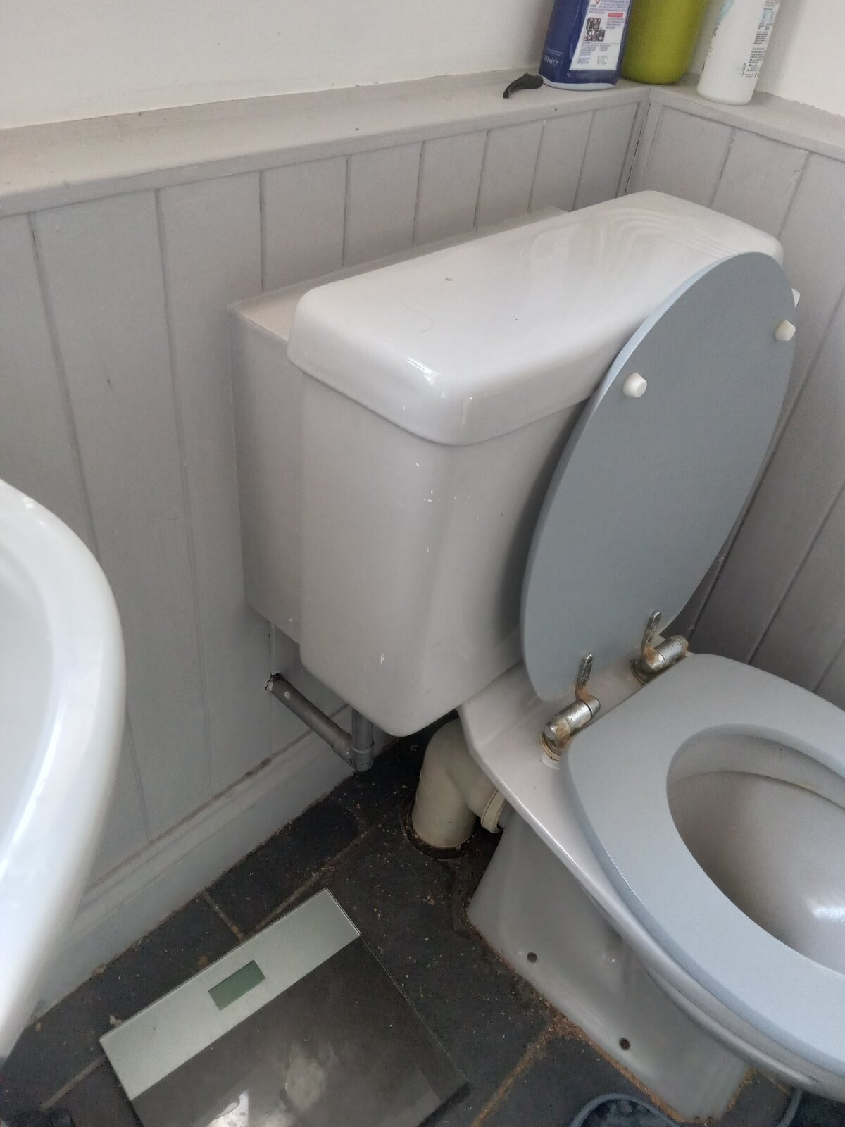

Hi All, i am fitting a new bathroom and the current toilet has been fitted with a gap between the cistern and the wall which i want to remove when i fit the new one (the old owner filled the gap with a tiled box).
However im not sure what toilet i can get that will allow me to close this gap.
Currently the back face of the toilet cistern is sat 19.5cm from the wall and the soil pipe outlet in the floor is inline with that face.

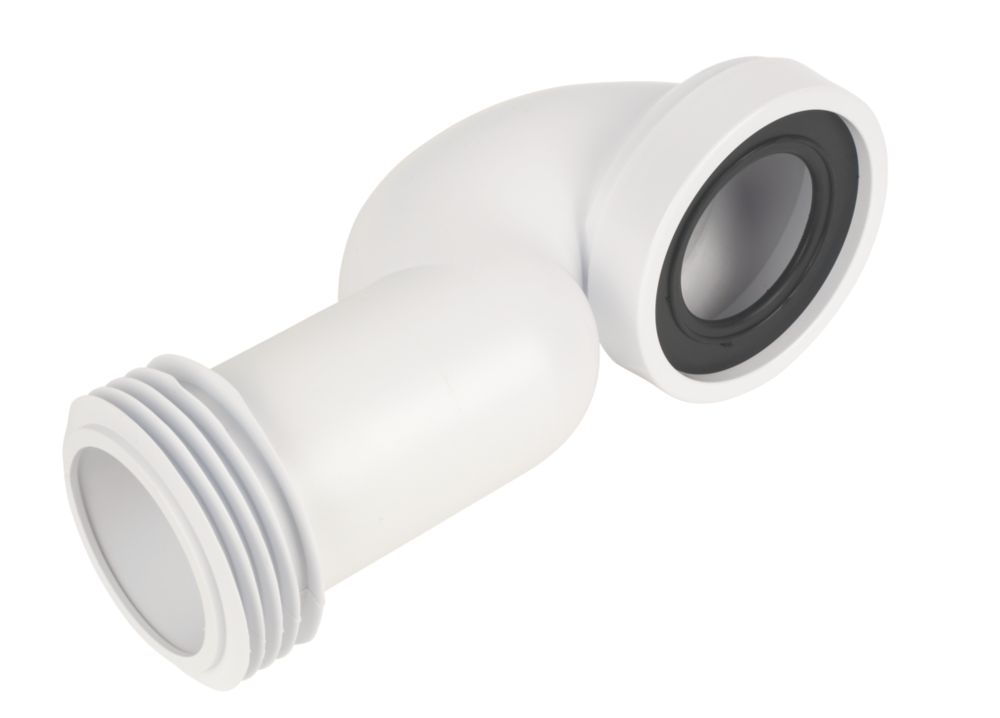

Thanks for the fast response. Would that also be usable on any close coupled toilet?
Looking more into it i dont see how that can take up the full 19.5cm gap between the back of the cistern and the wall? Unless im missing something
It will be usable, but imo will not get you back far enough, to the wall.
