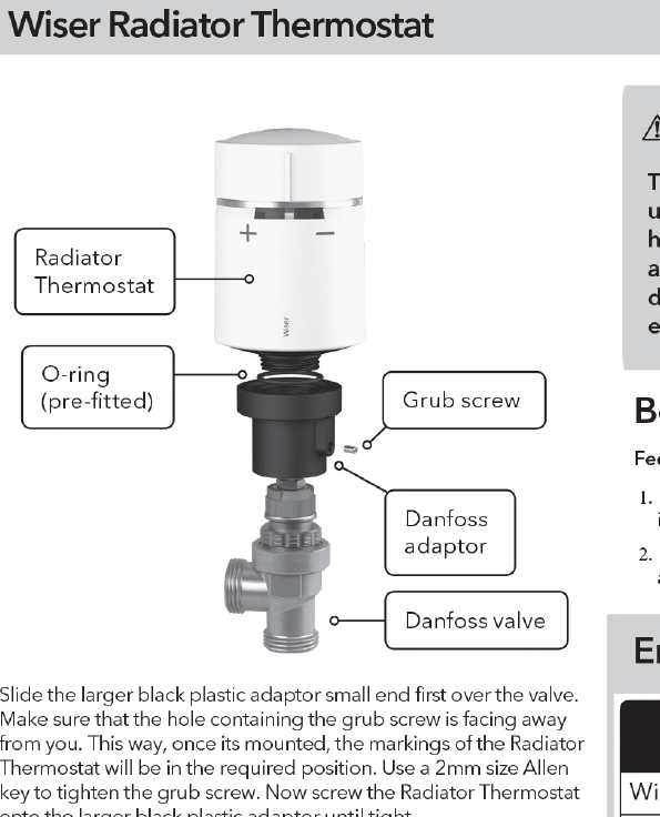

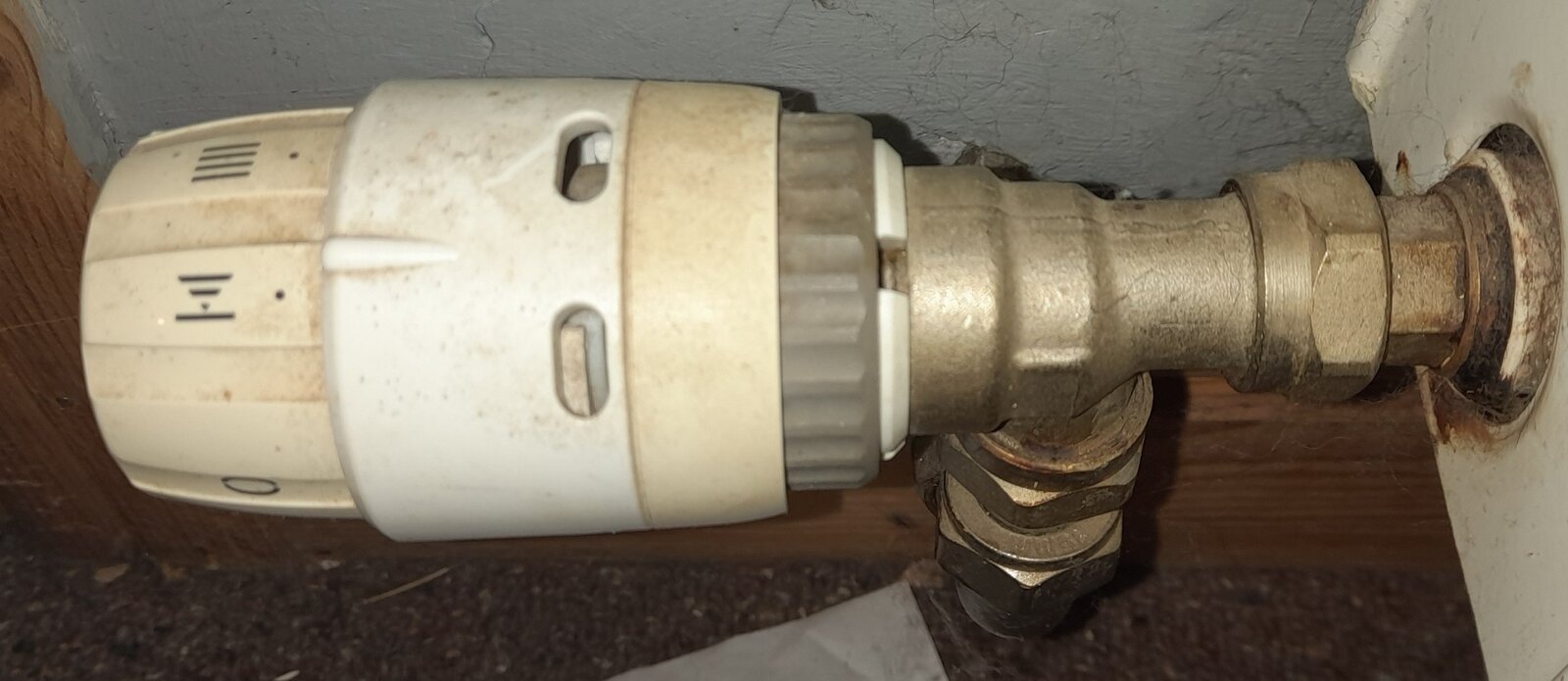

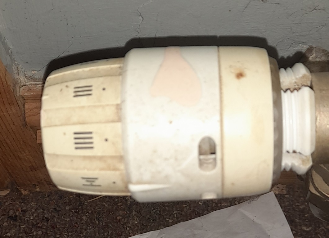

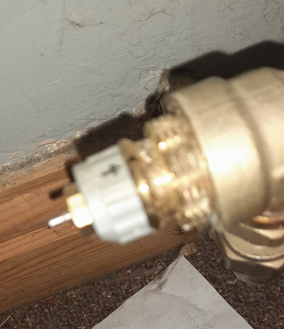

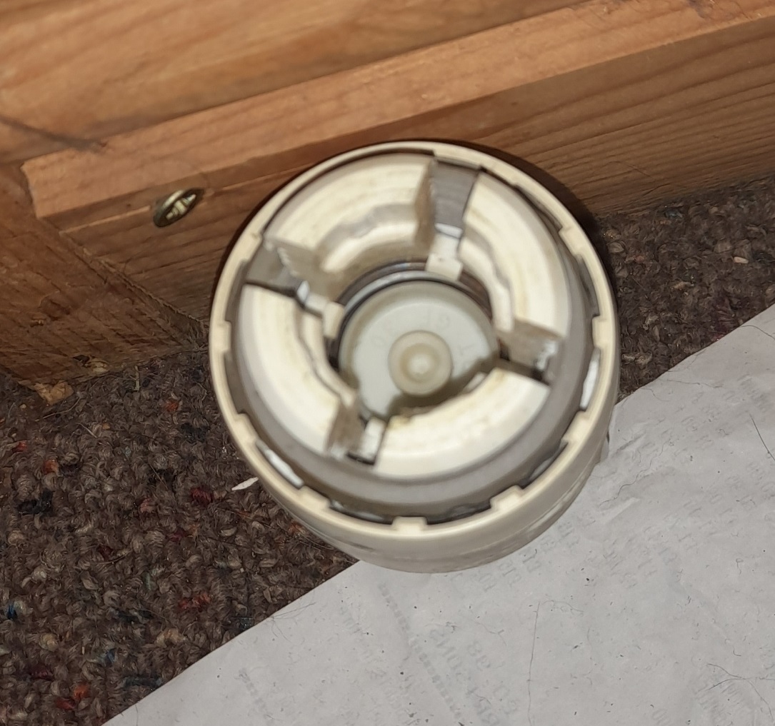

What type of TRV is this, and what electronic or smart replacement can I use?
27 Jan 2008
23,677
2,668
Llanfair Caereinion, Nr Welshpool
20240117_164827.jpg20240117_164657.jpg20240117_164712.jpg20240117_164724.jpg20240117_164827.jpg I have these in 4 rooms in the house. Is this an RA fitting? Can I use Hive or Wiser heads with these valves.
I thinking back had adaptors with my eQ-3 heads. So next step is tomorrow find one out and try it.
I want to be able to control the 4 rooms in the flat without going outside and going down to the flat, as daughter has left heating on a good few times, and also need a second thermostat up stairs.
So it is now a case of working out how.

Does the house and flat share the same boiler? If they have their own boiler then you will need two Wiser hubs but if they share a boiler then the wiser single channel or 2 channel hub should work. There may be an issue with distances between TRV's and hub but you can get a Wiser smart plug that also acts as a zigbee extender.
The Wiser TRVs come with the Danfoss adapter.
I binned mine as we have Drayton valves.
Can the Kasa TRVs trigger the boiler like Wiser, Tado and Evo can?
They look more like programmable TRVs. A slightly more advanced version of your EQ-3

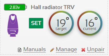

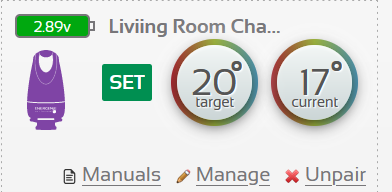

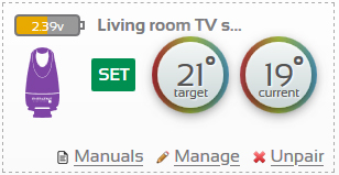

Thank you for your candid reply. I did use the Energenie in mothers old house, with a modulating boiler, and found the lock shield valve setting was critical. The display Flat Battery TRV.jpg helped to set it, if current exceeds target then close a tad, and clearly the reverse, but set at 20ºC at 7 am it was nearly 11 am before actually got to 20ºC, so cheated and at 7 am set to 22ºC and at 8 am set to 20ºC and in the main at temperature by 8 am.
However the new owners did not want them, so mechanical replaced, and now lock shields set worked well, and the Energenie were brought here, however mothers house had a modulating boiler, gas, this house on/off boiler, oil, and to date not got them working that well, first point is in spite saying they worked with Nest, on fitting Nest Gen 3 I found they didn't, and so I could turn off rooms not being used, I added a further 5 eQ-3 blue tooth TRV heads, but at the time flat not used, so left the 4 mechanical in the flat, and turned off the motorised valve so all flat not heated except for frost protection.

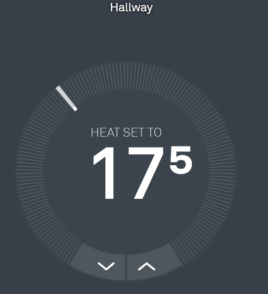

I blamed the on/off nature of the boiler to start with, but now wonder if there is a by-pass valve not found. But found the boiler turning off while living room still cold, I think main problem is hall cools too slowly, so idea is a second thermostat in parallel with Nest, must be wireless, and to be able to turn off with Phone would be a plus.
I did consider Wiser three zone, but realised no access to the com, and I need to power both a 2 pumps and 2 motorised valves, and a boiler, and the Nest Gen 3 wiring worked A1 but Wiser would need relays adding, so looking at single zone just for main house. But Hive is cheaper, so is being considered.

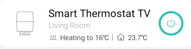

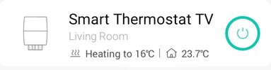

But that leaves the flat with nothing to tell me when daughter has left on the heating, the Kasa head £35 for Amazon so a cheap option to see if heating left on, the eQ-3 no good as only shows target, it does not show current. But only need one head to see if heating running or not. Fitting a Wiser head to wife's bedroom would ensure that room is warm enough, don't have a problem with my bedroom.

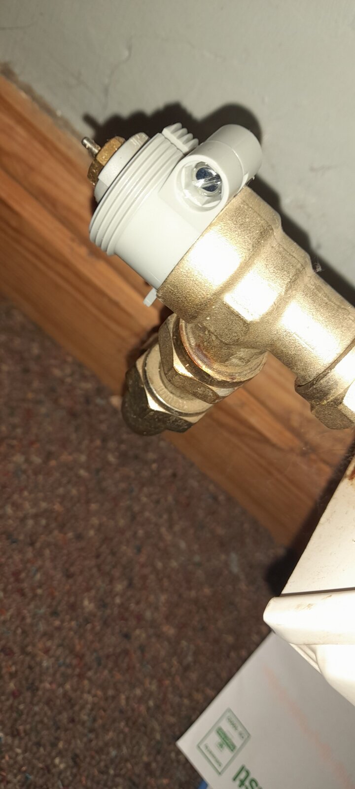

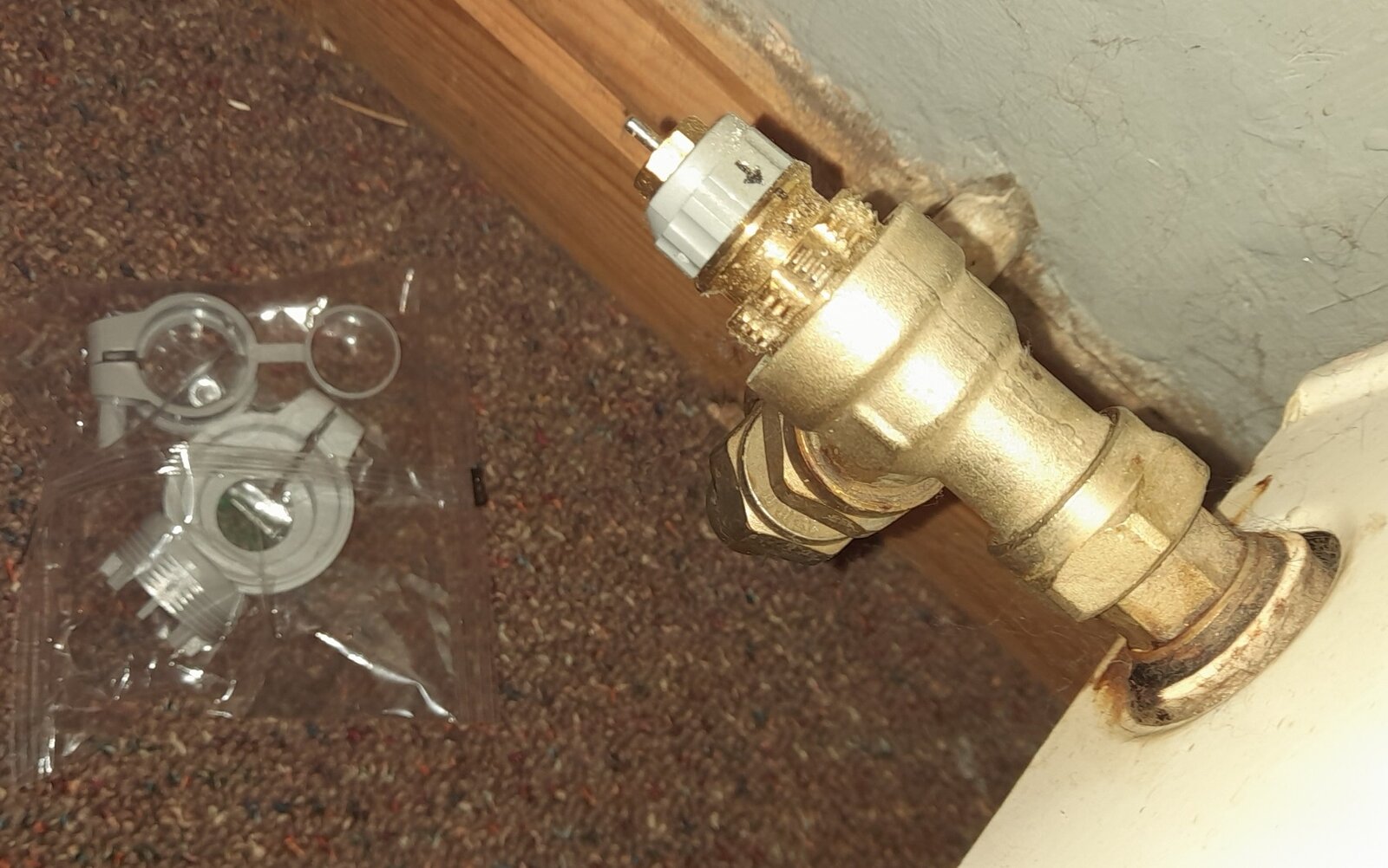

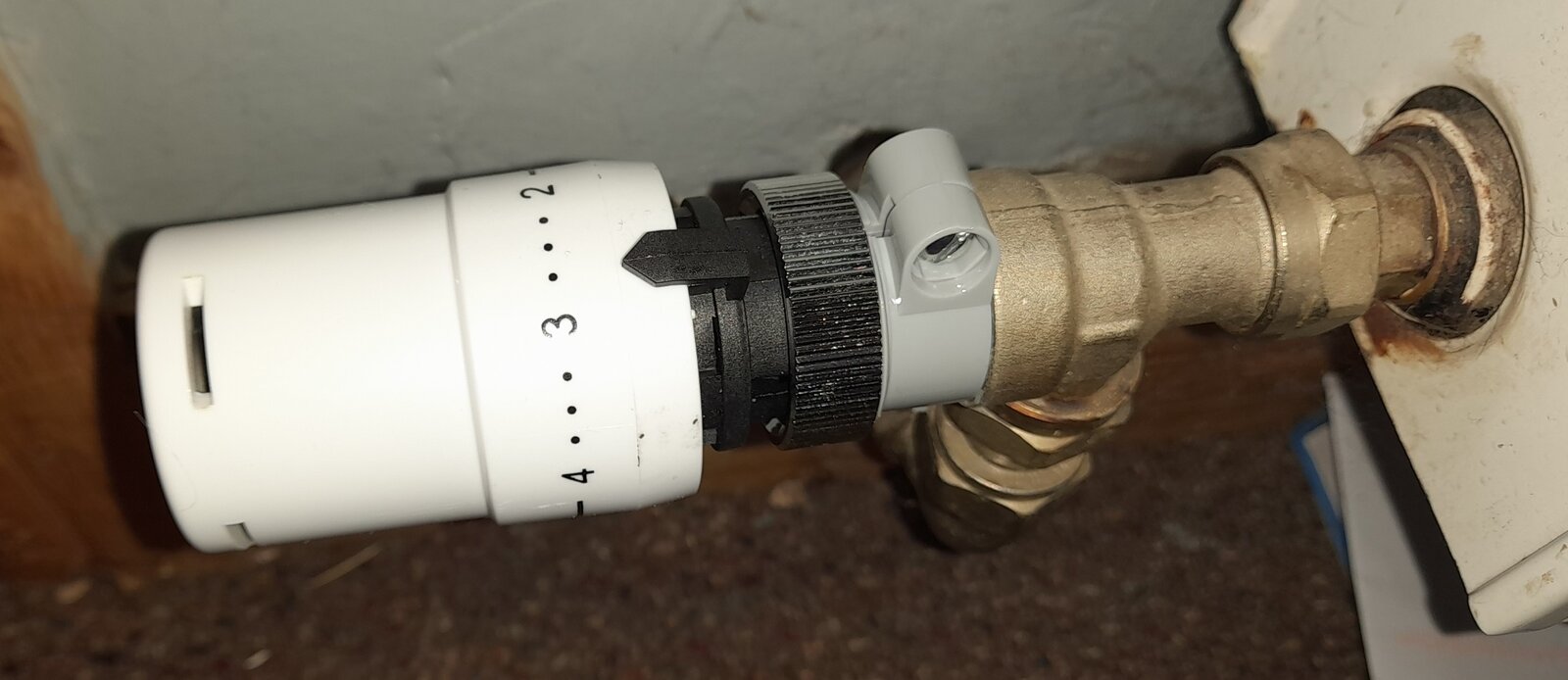

So today tried the adaptors that came with the eQ-3, 20240118_111953.jpg20240118_112230.jpg20240118_112349.jpg and they work, so can fit electronic TRV heads to radiators in the flat, as I have the adaptors already. So good news, but @Mister Banks report is not what I expected. I have not seen the software for wiser, the Kasa shows TRV Kasa.jpg but looking at the damaged Energenie TRV for same room it shows room has actually reached 20ºC it is the furnuture stopping the flow of air, but other side of living room also showing 1705581418687.pngand that one has only a table in front of it, so there is air movement, and boiler at moment not running, just on the edge 1705581579530.png but the TRV in hall showing 1705581671476.png so 1.5ºC between the TRV and wall thermostat, the house today is warm enough, but sun is shinning. 1705581861912.png so don't really need heating today.
