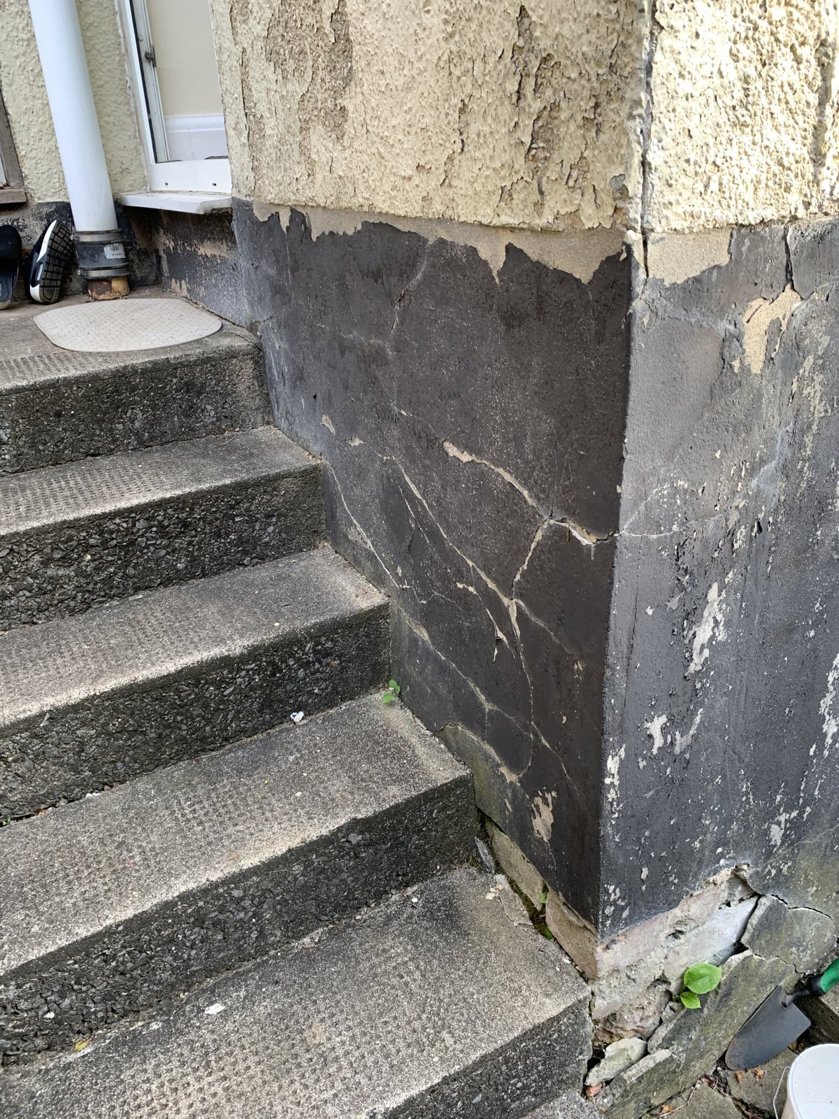

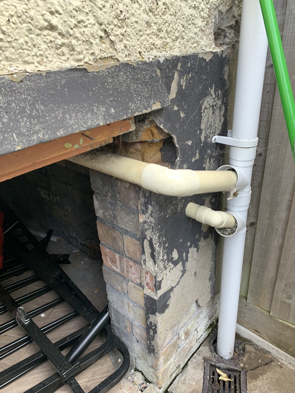

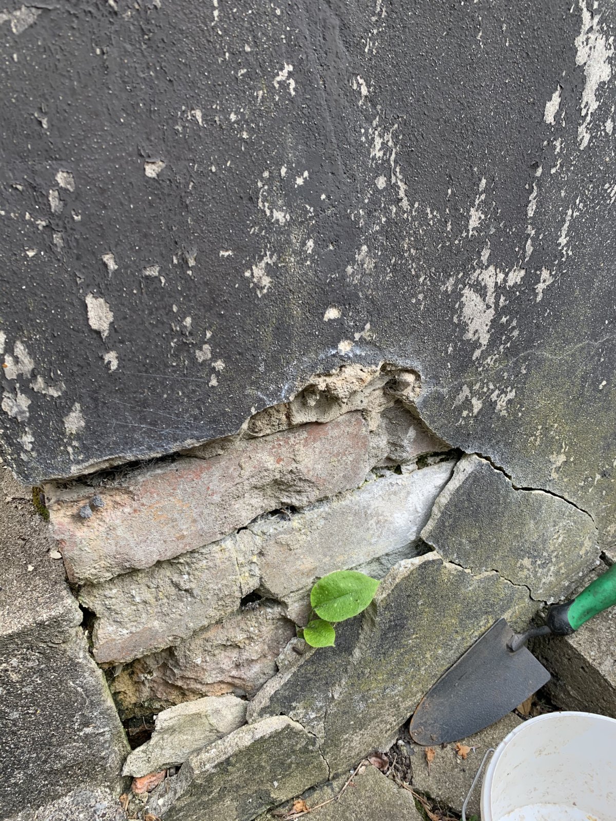

How would you recommend I tackle this. My house is on a slope and there’s a lot of brickwork at the back.
the render is original 30s and it’s cracked and I am worried what water is doing to those exposed brick.
I initially intended to repoint the bricks and try to render over the gaps, but I Don’t know whether it’s better to knock it all off repoint and re render.
Could you suggest how to deal for a DIY er?
I also have a gap to under the kitchen which I’ll have to deal with somehow. Suggestions on that welcome too

Knock off all loose render, back to a good, straight edge and re-render. If there isn't one, re-render the lot.
It's not much fun trying to render to an indeterminate, wavy, loose edge.
There's no point in re-pointing that which you are going to render over. The 'gaps' will provide a good key for the render. Think about how a base coat is scored to provide a key for the topcoat.
The gap under the kitchen, if it's a storage area, put a door on it.
It needs rendering. Plain and simple.
You don't need to repoint before rerendering.
