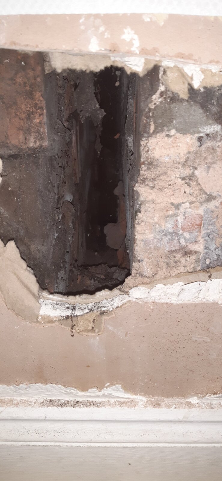

Hi, I have a hole I need to patch, I don't live there so want to do it in one quick go if possible.
What's the best way please?
Also I think the cavity could do with some insulation at the end before I fit the plasterboard, is it a good idea to put some rockwool in a strong bin bag and stuff it in there?
Also I think the current plasterboard is 12.5mm I only have some 9mm, can I use that?
You can dot and dab the thinner plasterboard so its flush with the surface ready for skimming. Expanding foam for the gap, or if small enough a cement based filler.I think foam behind board has to be fire rated.
Great thanks for your help mate, do you mean I can use the expanding foam as insulation in the cavity?
Or shall I stick to my rock wool in a bag idea?
The rockwool should be fine as long as no damp in the vicinity that might be transmitted to the pb.
It does seem damp that's why I made the hole to investigate
