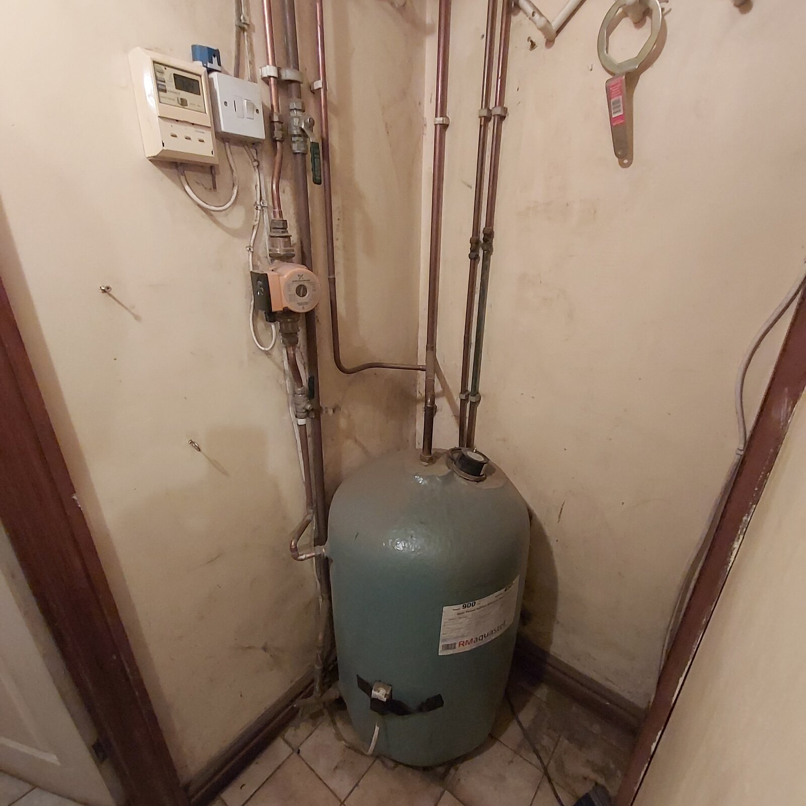

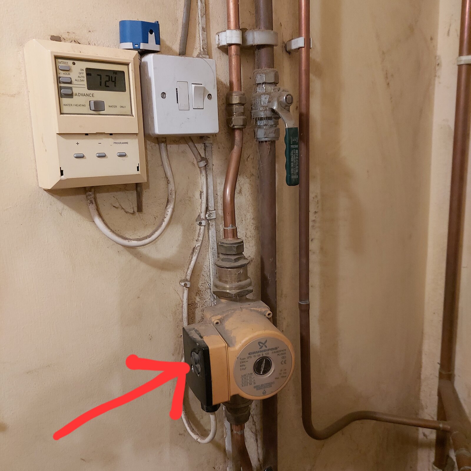

Hi
Just moving into a property with a hit water cylinder/immersion heater and it has this fitted, can I ask what it does please? There's a timer unit wired into it too.
Cheers,

Not a plumber but it looks like a pump to me, presumably it circulates your hot water to the taps.
It's a pump, it circulates hot water around a loop so that when you turn on a hot tap you don't have to wait for the hot water to travel all the way from the cylinder.
Timer is to switch pump off during periods of no usage.
  • Thanks
Reactions: CBW
Nothing lagged, that'll be super inefficient, all that will be doing is heating the space the hot water pipework circulates through when the pump is running. That being said I see it's set @ off.
Is it a large house with bathrooms far away?
Thanks for replies. No, nothing is lagged here at all. I've just moved into the place, a large bungalow. Furthest bathroom is approx 16m away. Kitchen is 5m.
