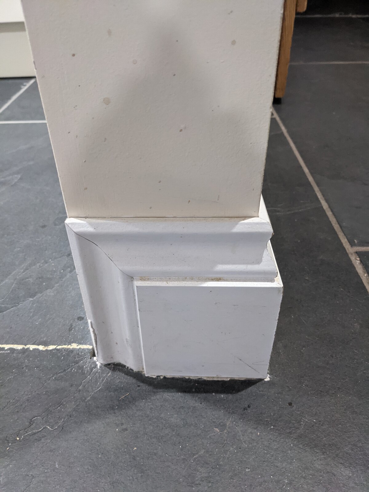

Hi all
Please can someone let me know what this skirting profile is called? I've googled it didnt spot it in the hundreds of options!
Cheers
Hi
Thanks for the reply. That's exactly what I thought, but I can't find a join in it anywhere.
Was hoping it may be a readily available but not common profile.
It's a car of either find a match, or replace an entire hallway!
Is there an inconspicuous piece somewhere you can try prying off?
Hard to believe that someone would go to the effort of moulding a skirt that looks just like a bit of dado rail stuck on square edged skirting, but I suppose that makes your job of replicating it a bit easier!

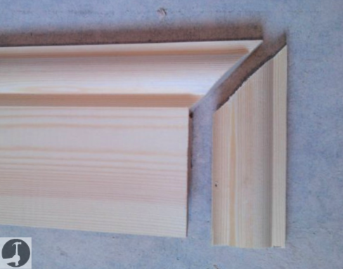

unless the person that fitted it was exceptionally anal it is in one piece
because the normal way would be to mitre the add on architrave sized moulding to the around 5-6x1"square cut
but as you can see its mitred to the corner[diagonal]
That’s standard Ogee skirting, cut on a 45 across the wall end. You can just see the hairline join on the diagonal. It was done that way to finish off on the face of the wall instead of returning round the corner.
This is what i would've done, saves having a mitre joint through the skirting
