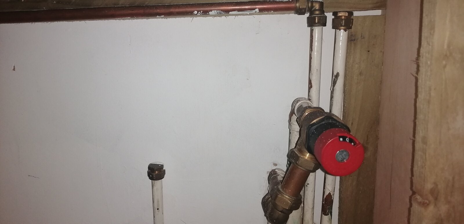

Honestly ... It's an ABV. It needs to be set properly to work correctly, you need someone that knows CH systems to check it. What combi boiler do you have - Make and Model.

Needs to be set? It just has a number 5 and turns the number doesn't move and on it it says " unscrew to adjust"
If it does need to be either open or closed and is needed and in use I have no idea as it doesn't show which way is which.. What would happen if it was say off...?
But if it was being used wouldn't it then get warm it was stone cold I had my heating on full for about 15 minutes still stone cold. So if it did have water needed running through it for the system it would get hot I'd assume.
I've had my heating on all winter just gone so assume its not in use. Well you can see the capped works isn't it water regulations that any capped works can't be more than 3cm.

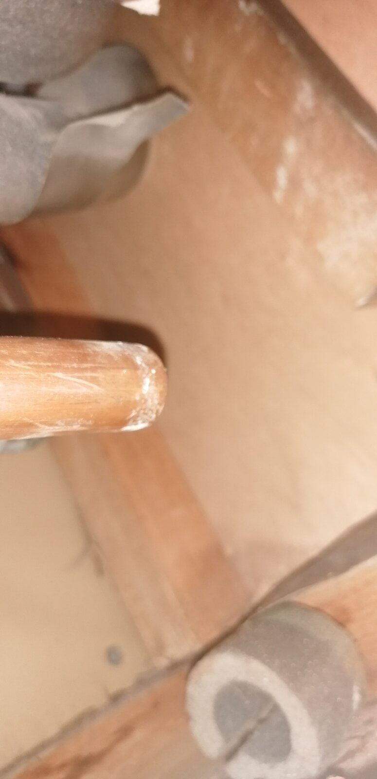

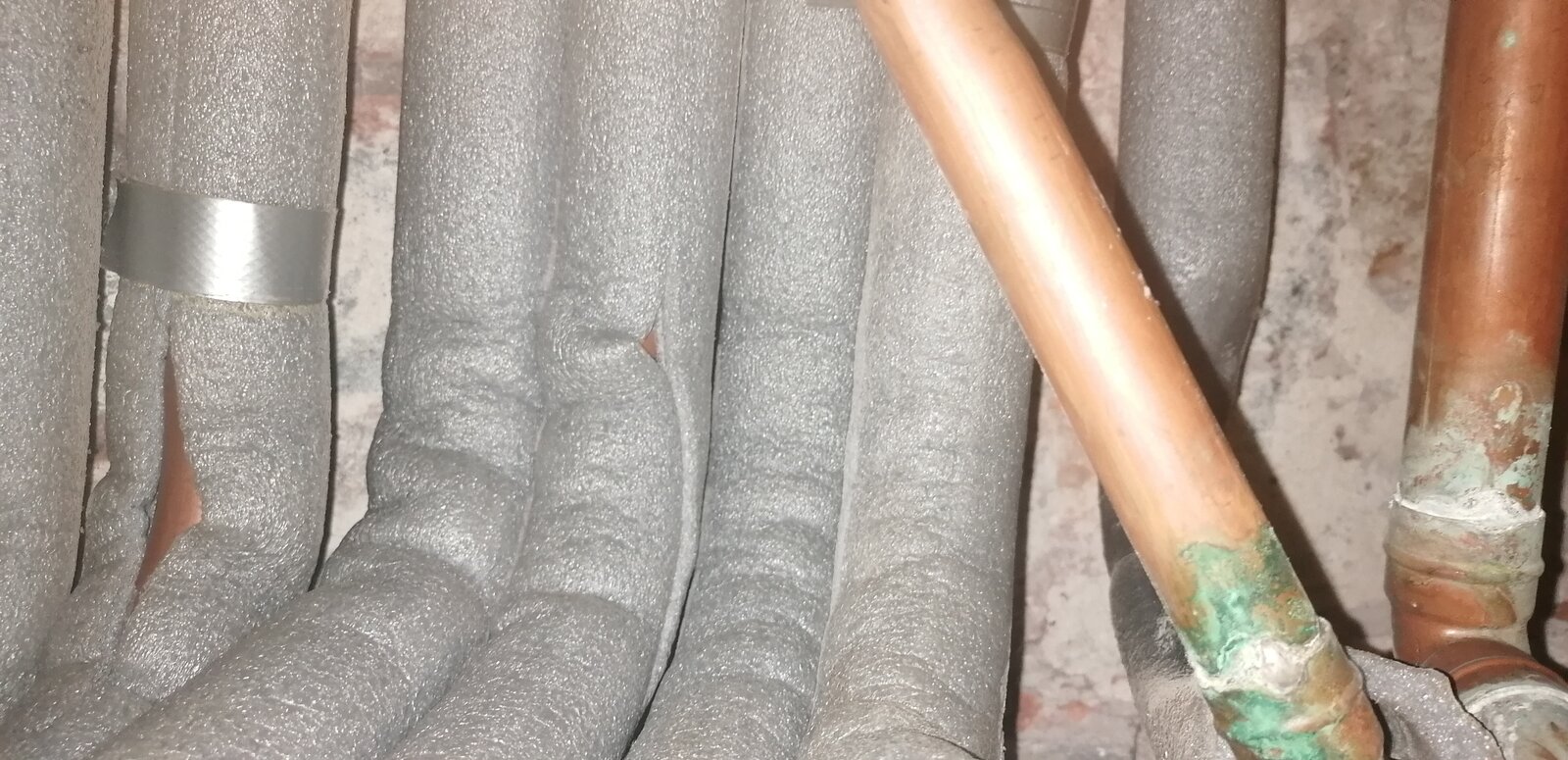

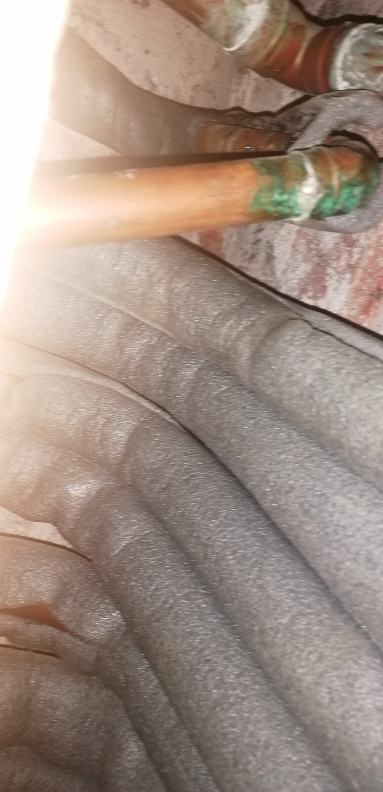

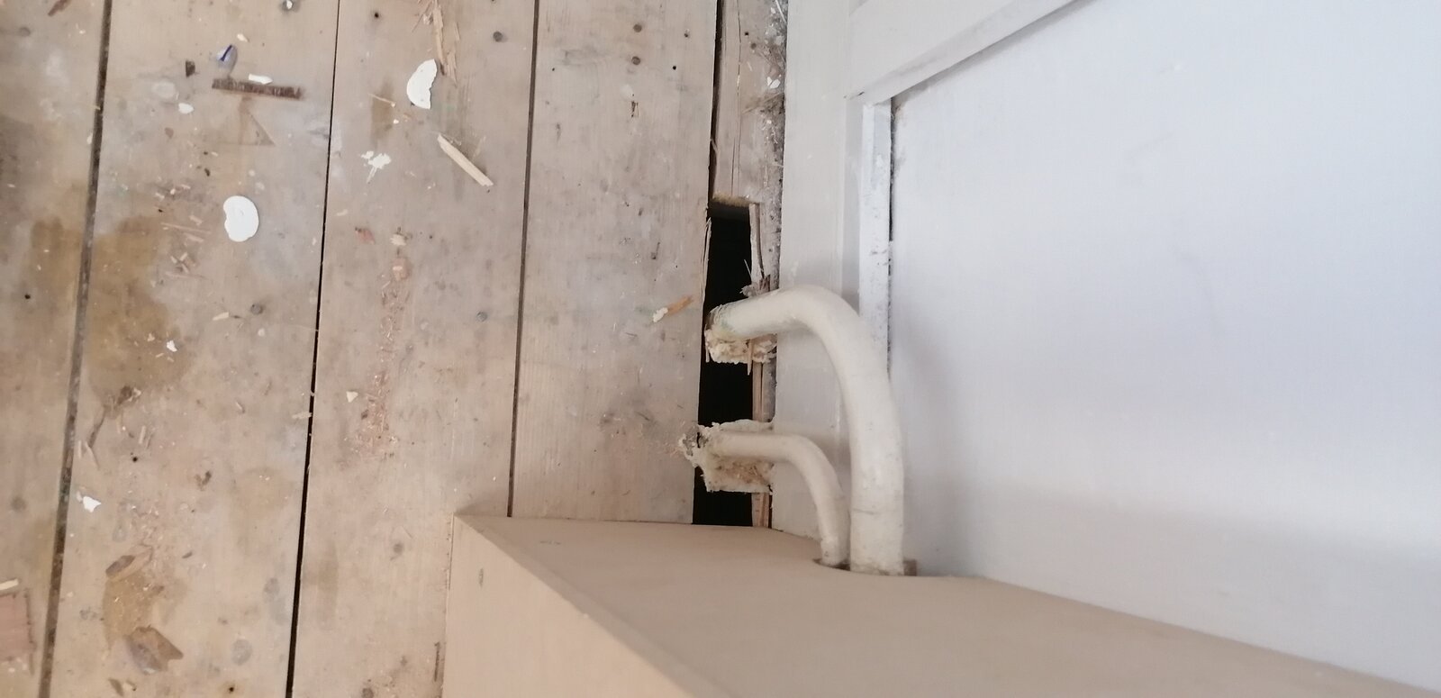

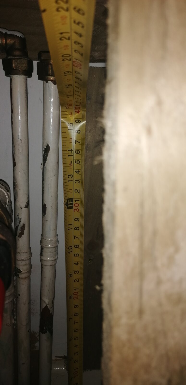

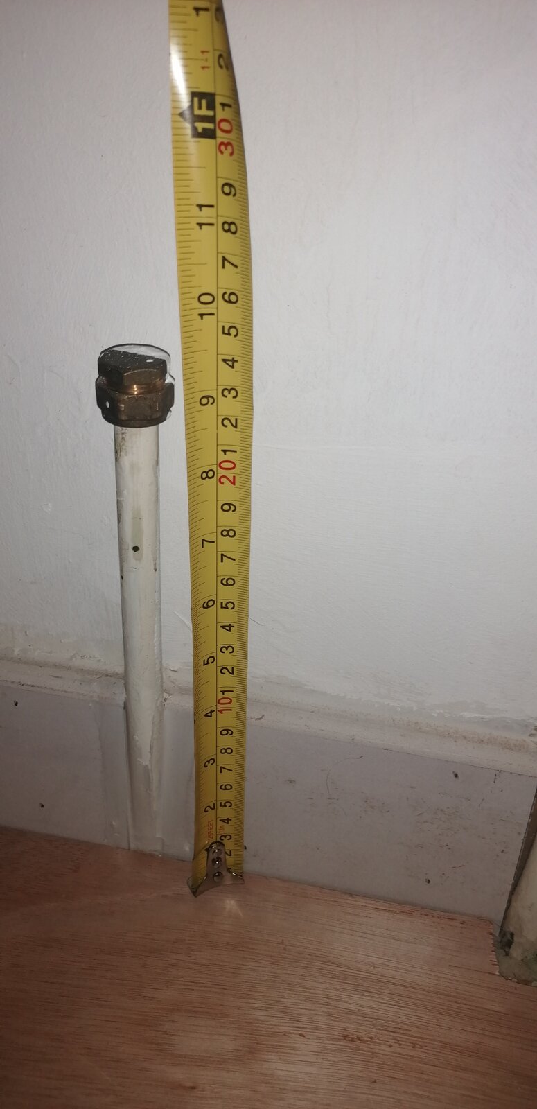

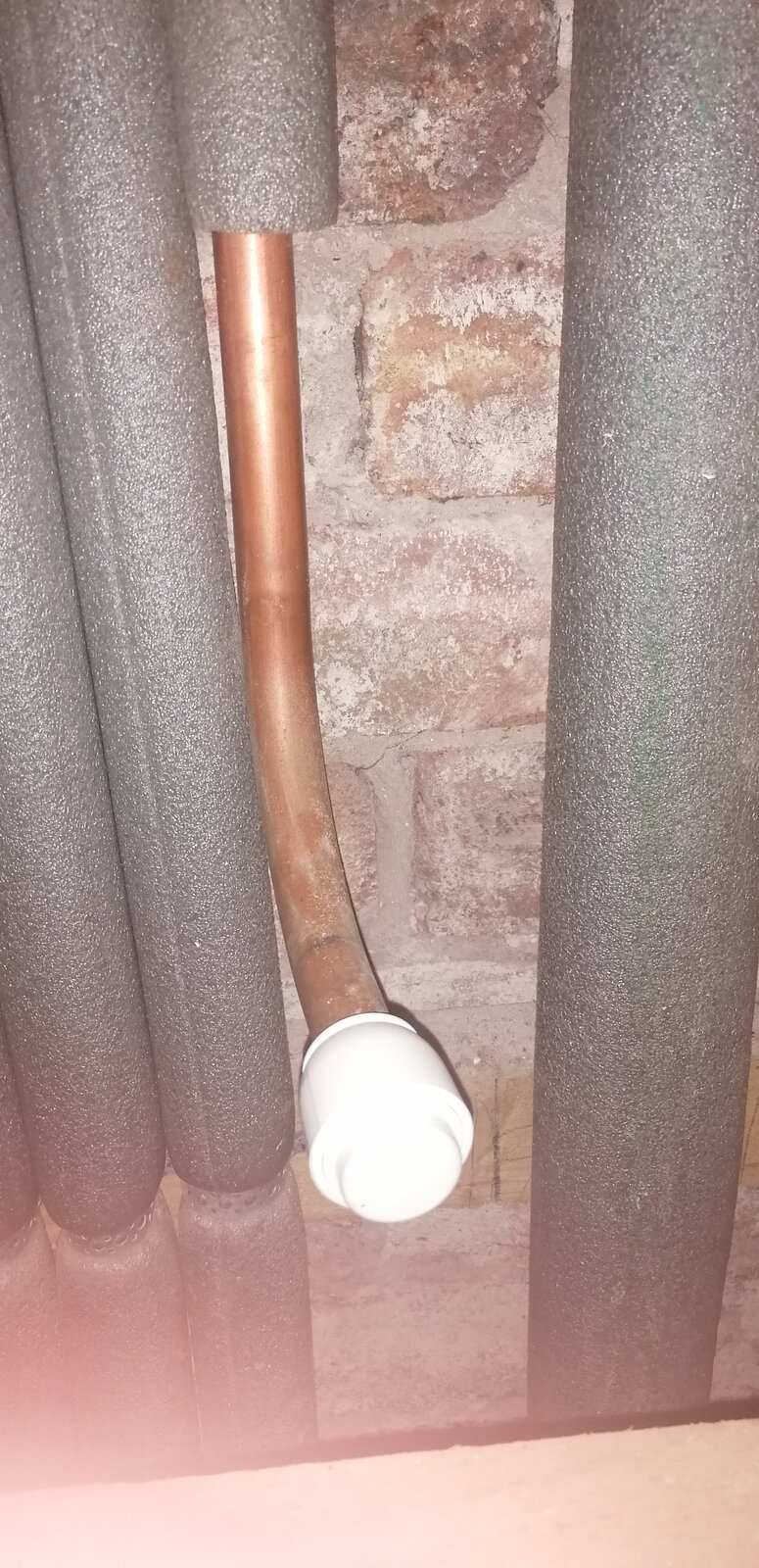

"In fact, the Water Regulations Advisory Scheme (WRAS) recommends that a dead leg must be no longer than twice the width of your pipe, for example, a 30mm dead leg for a 15mm pipe."
As you can see from the photos I have ones running over 15 inches
They lol ( landlord) I've been advised that according to them nothing needs to be checked but how they know this without actual coming into the property I don't know.

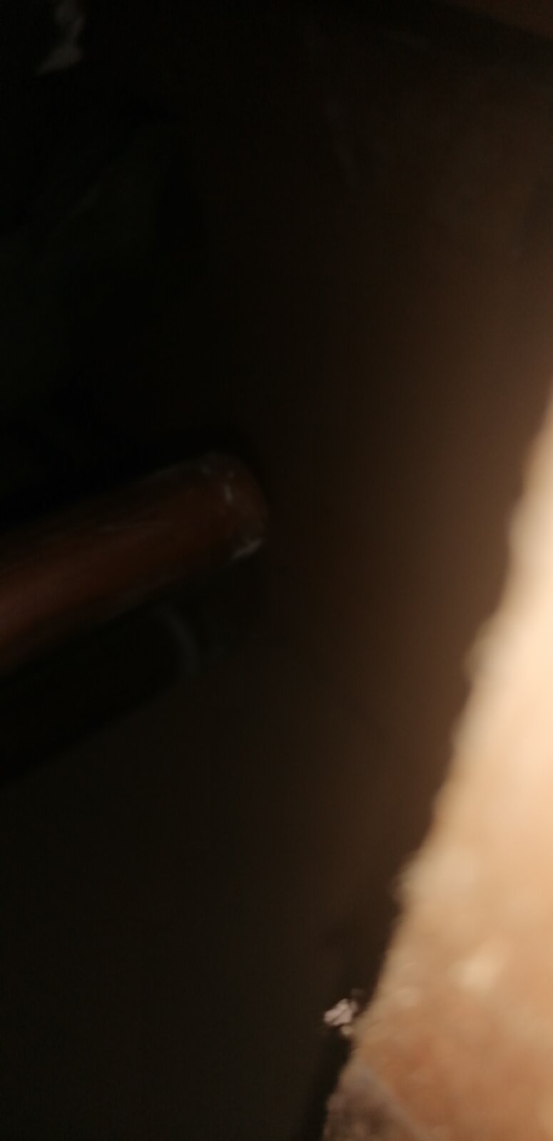

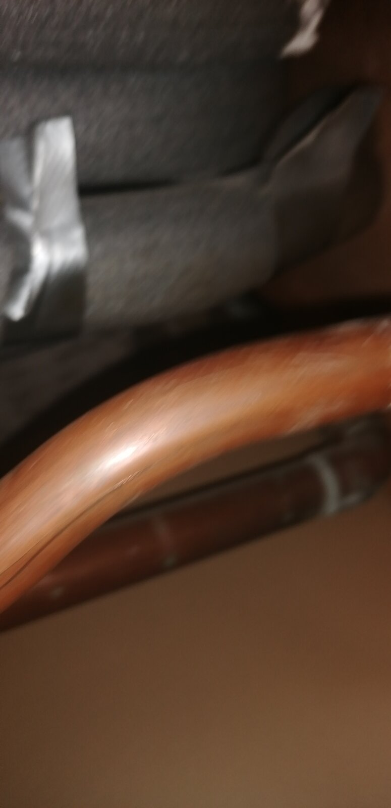

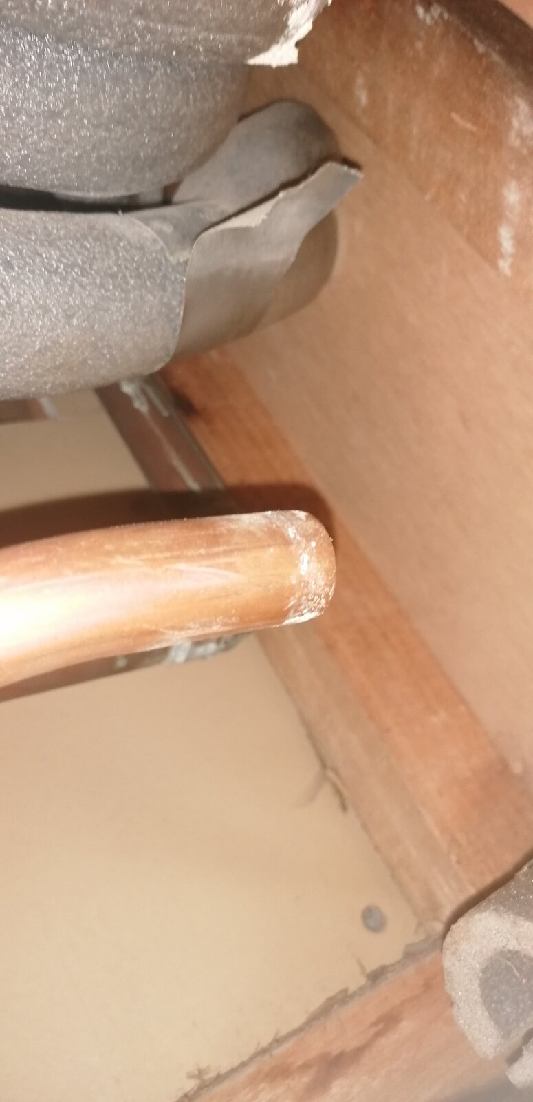

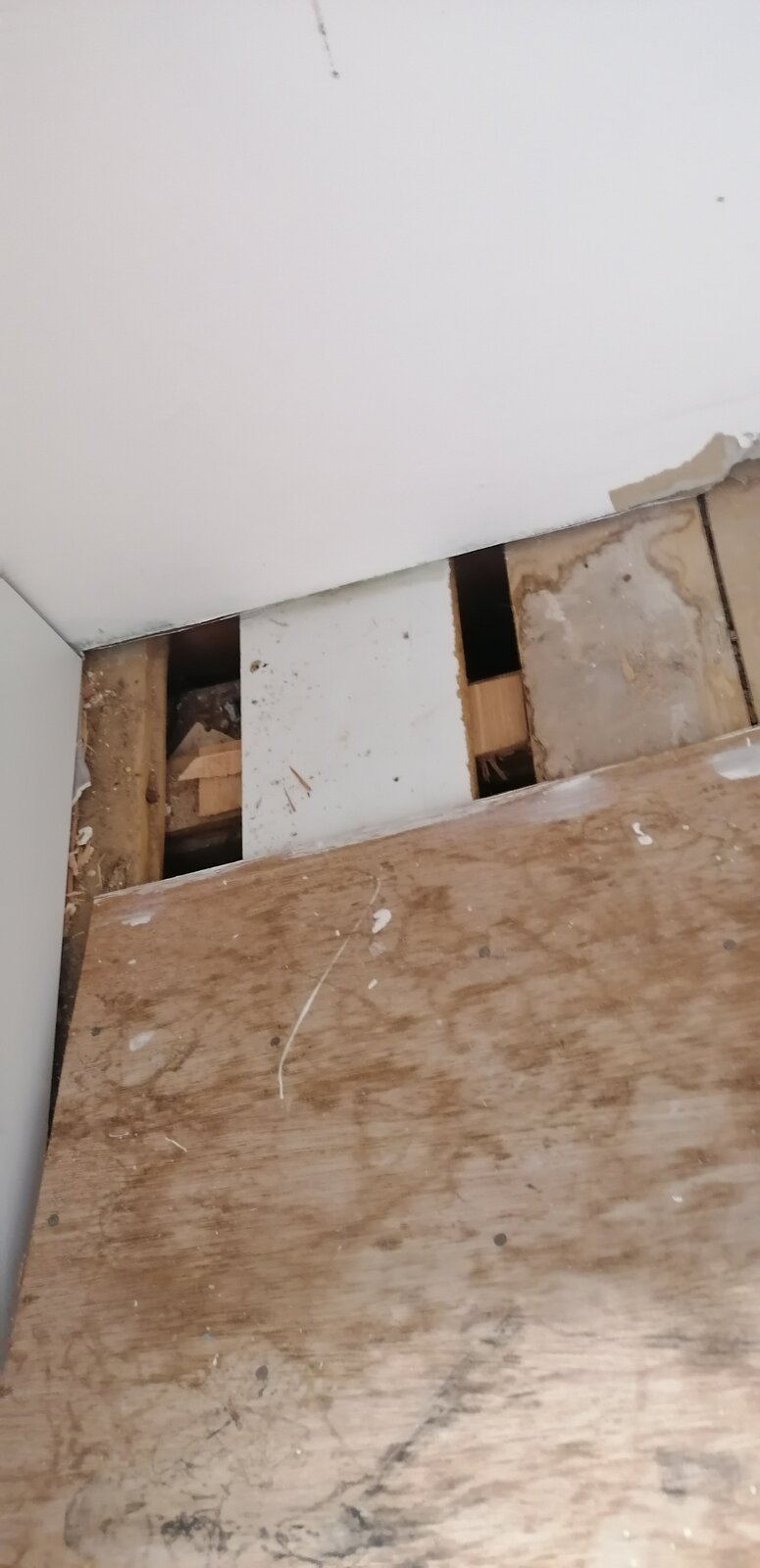

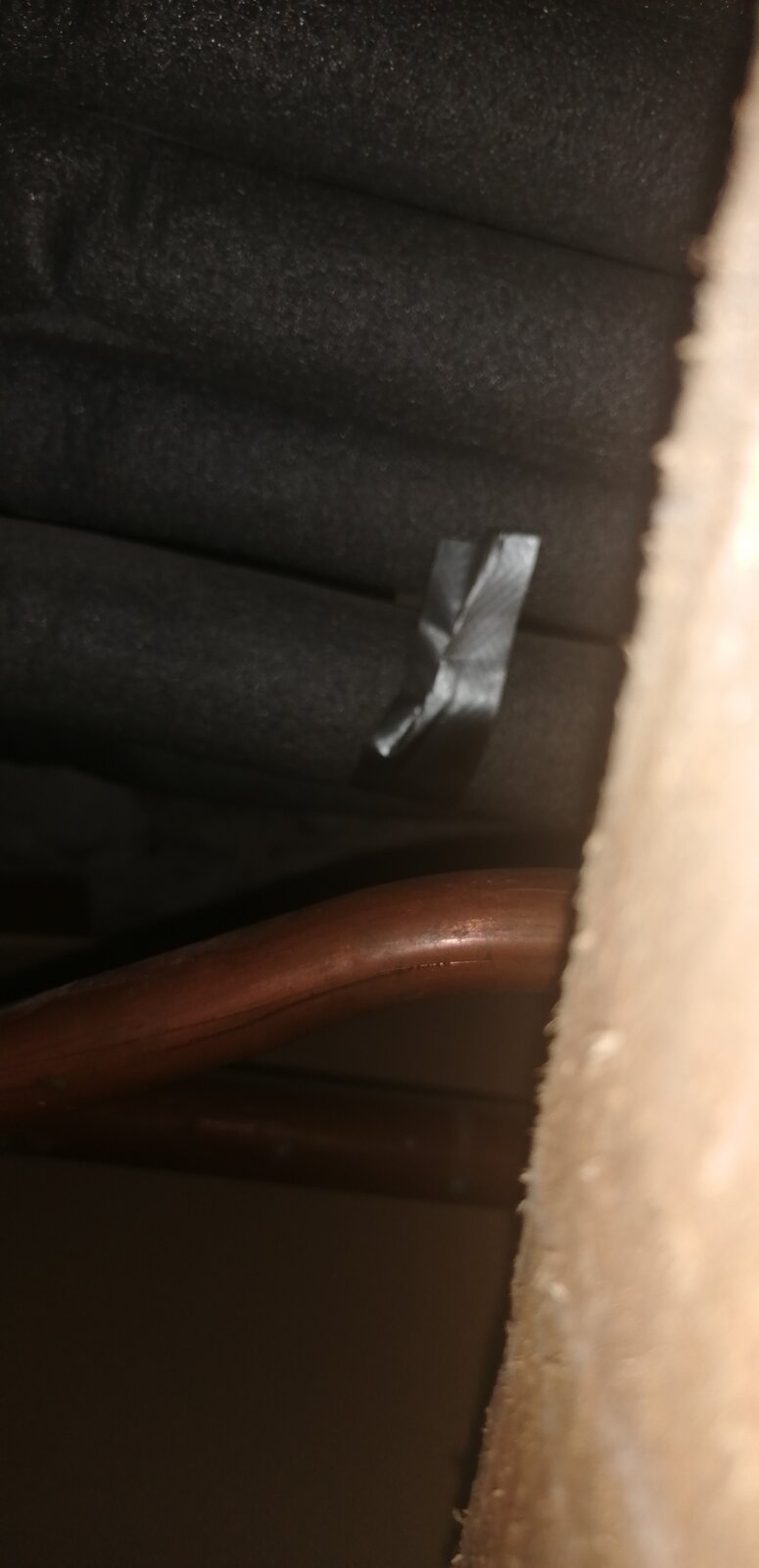

Very bad pictures the capped one and the one without any end have just been cut at loft levels and just left the rest redundant in my flat I'd assume they should have been taken out at the same time as whatever they were attached too. But as they are both cut each end no issue with legionella but the company only got orders to drain the old tank and switch my bathroom cold over to mains.
I would assume that by doing so all the other flats now have redundant pipe work also?

Yes the ABV needs to be set to open when the resistance through the pipework inceases when the system valves close. That needs someone that knows what they're doing with it. Yes it is a tamperproof type that needs unlocked to adjust. The boiler make/type would dictate whether it has an internal bypass or not and whether an external one was needed.
I assume they are open as I had heating on all winter and I'm not about to unscrew gas works u know...
What way should it be tuned but again if it was in use why didnt it get warm i assume its not used as if it was for flow rate to the radiators it would have got warm when they did...?

I have also been advised by a specialist that you would need to actually go into at least 20% the flats to test or all of them if pipework is different in each which it is.

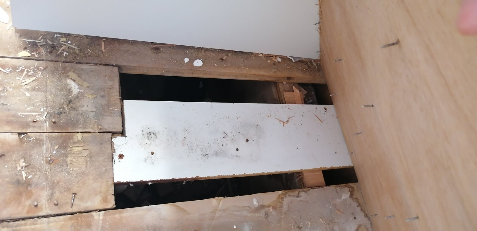

I have two visible pieces not connected to anything I don't know about the ones I can't currently see.
As pipe work is all in different places for each flat but you can see my capped work is above the 3cm and no one came into mine to check and take away the now redundant pipework after the drain. As they went told 2 by HA. Why not i dunno.

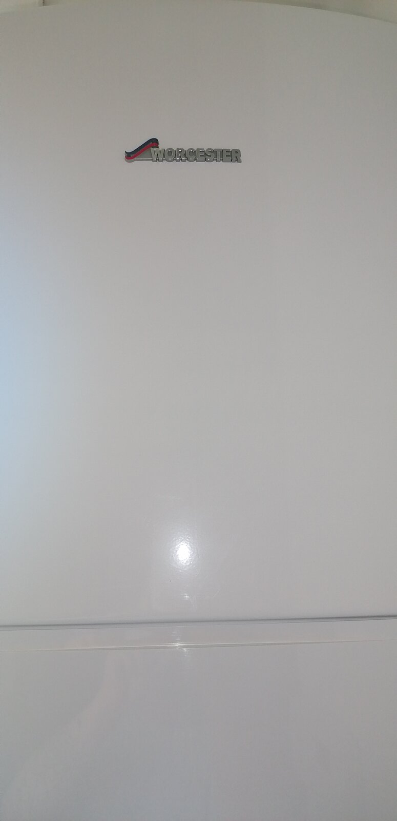

Worcester GREENSTAR 30i Erp my apologies I wasn't at home b4

As far as the boiler is concnered then the boiler you have has a bypass inside it that opens when the flow out of the boiler stops to look after the pump what it doesn't do though is move enough water out of the boiler to dissipate the heat properly to reduce the wear and stress on the boiler's HEX. Hence an external auto bypass is best practice to be fitted but this is all moot as it's an HA and it's their problem, so you don't need to worry about it.
