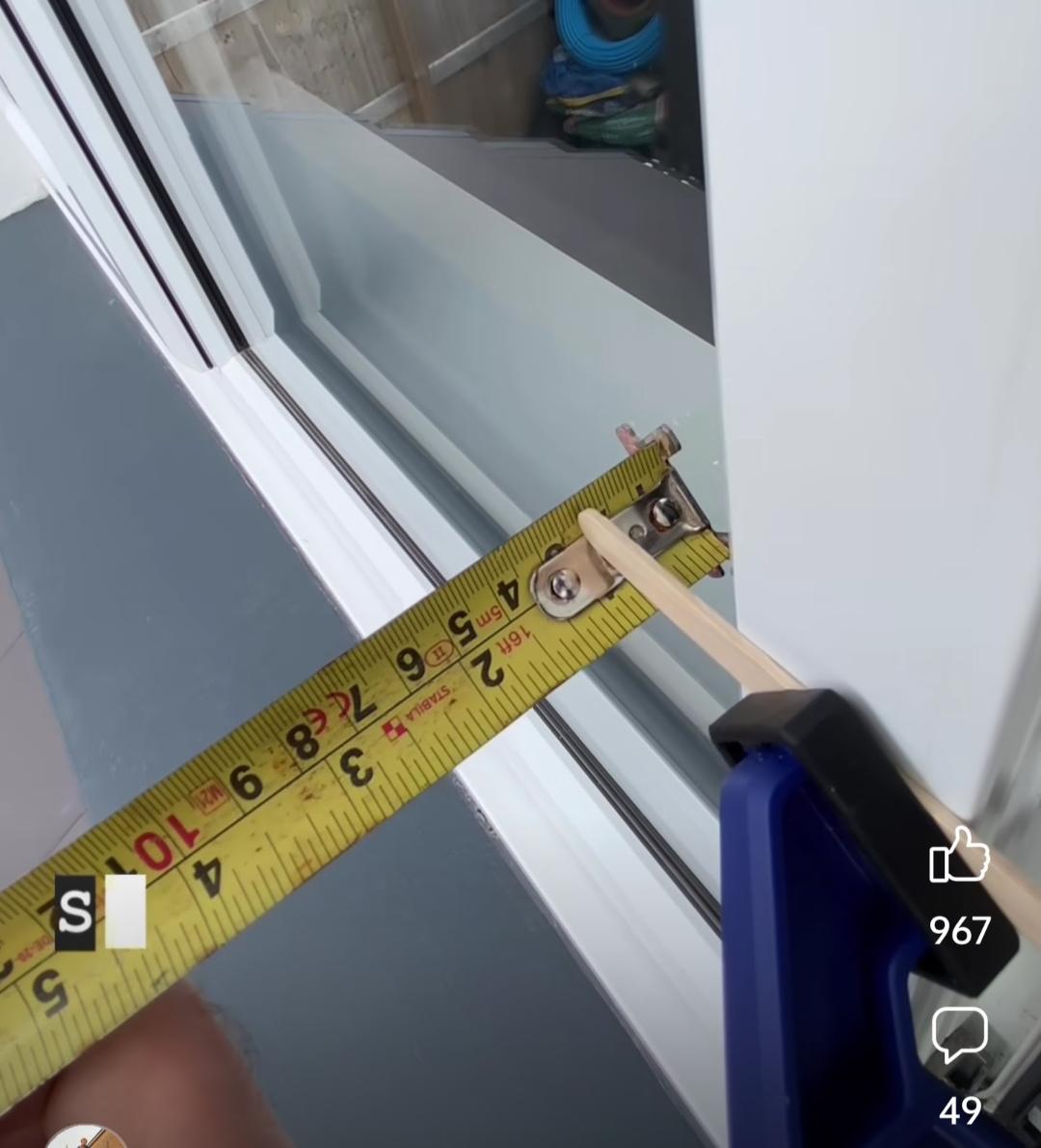

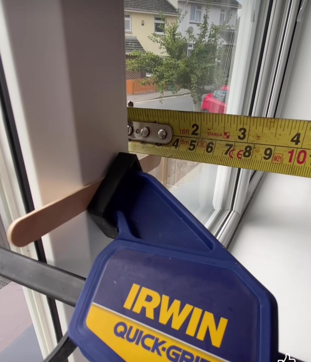

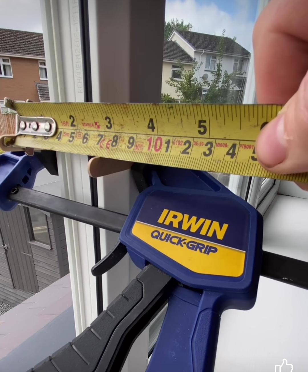

Follow up questions, how do you easily measure glass thickness? Hard to tell given the frame but I think it's thinner than 24mm.
Temperature guage doesn't show too much heat loss between the surrounding wall and glass pane when heating is off, only a few degrees. Few cold spots around edges so may put a bead of sealant to stop drafts.
without removing one or using a gauge ( or experience :giggle: ) you can't accurately. If its existing upvc , then it will be one of three , 20mm , 24mm or 28mm overall, but then depends if you have 6mm or laminate glass anywhere as that will then alter the spacer bar size too
Fair do, thanks for the reply!

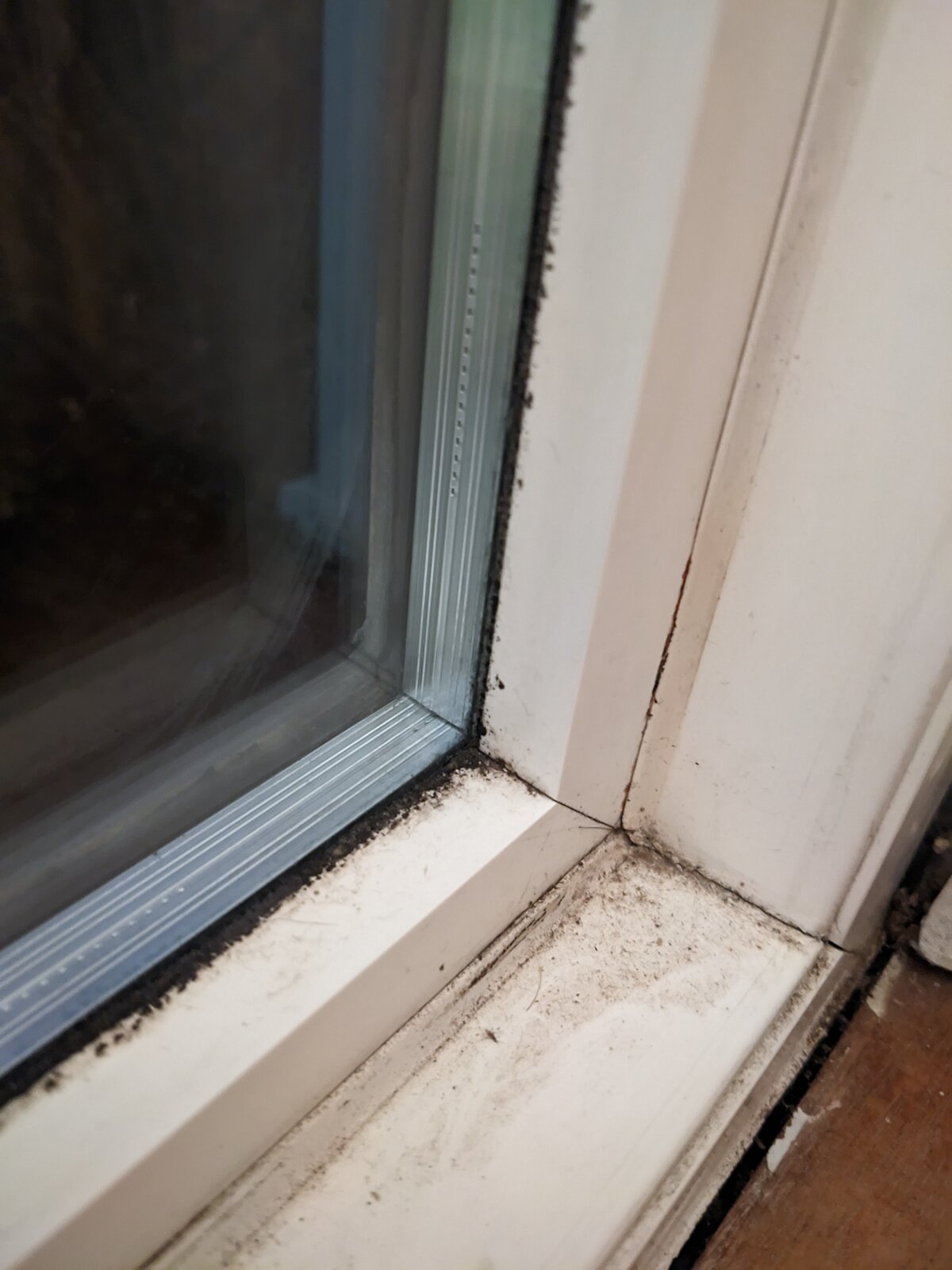

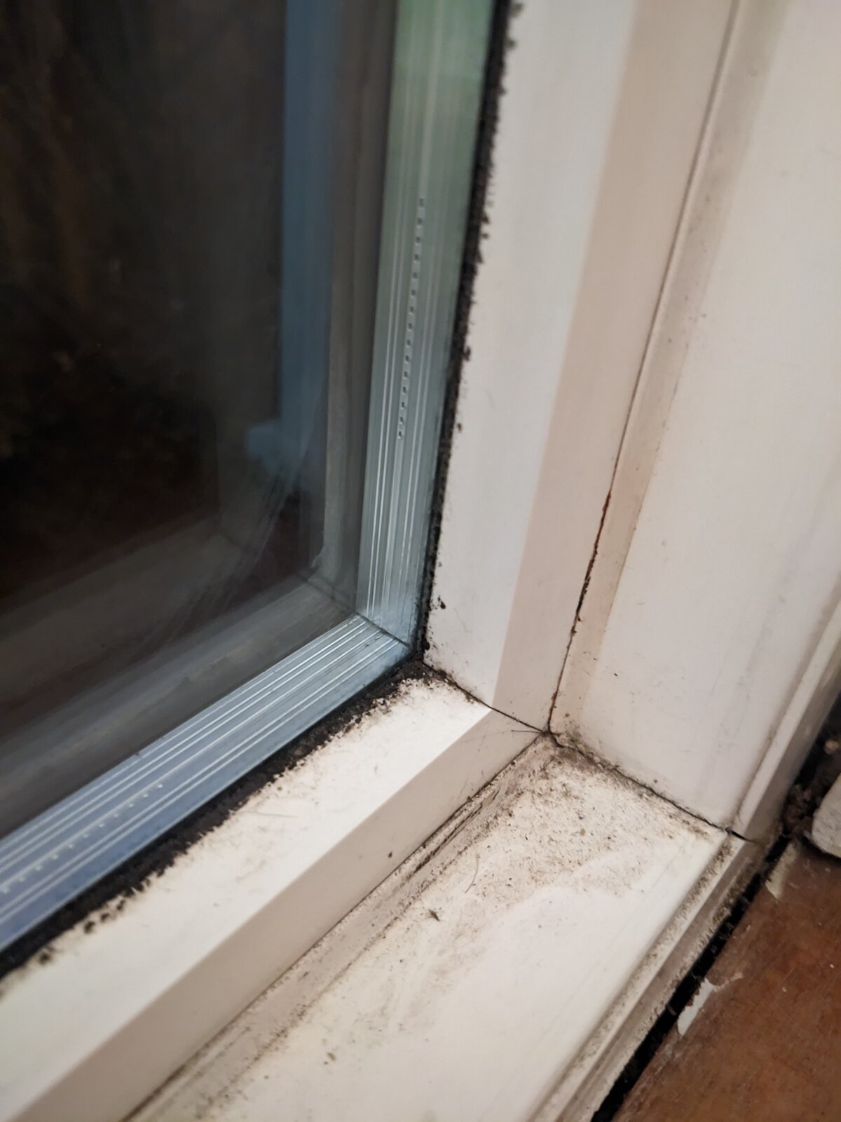

These are the worst ones. Thanks so much for helping out!
That looks like a 20mm spacer bar to me ( old sigma bar at that ) , so a 28mm unit.
Let me tag @crank39 , see if he agrees ( might take him a while to answer though)
