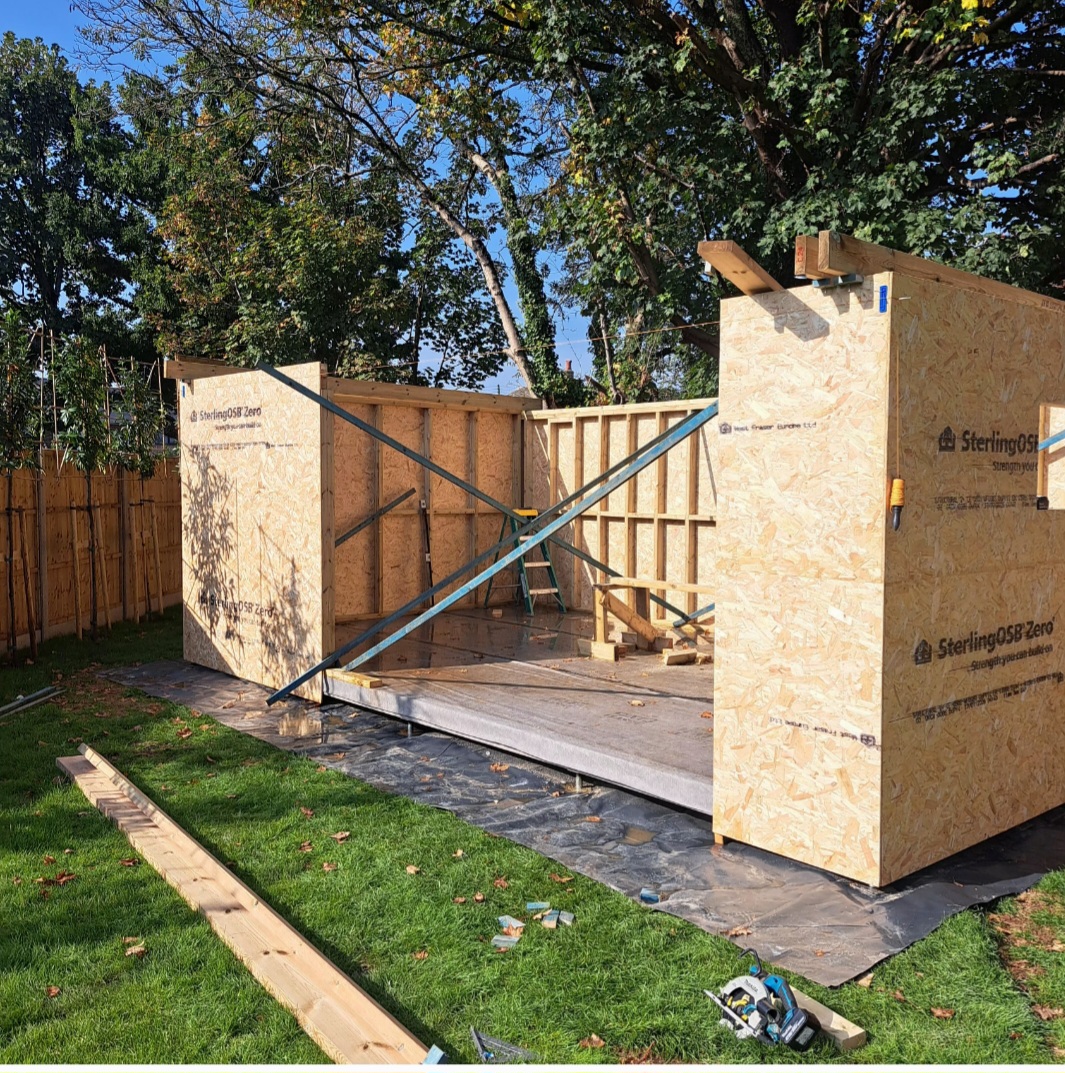

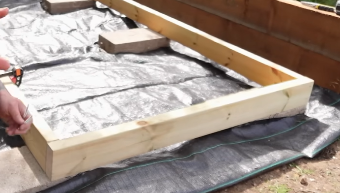

Struggling with the order in which I lay the above and wanted your thoughts please.
I am building a garden room with this type of floor and foundation system.
Initially, I was planning to lay the OSB floor and then crack on with walls and roof.
Practically, this will be challenge as I am likely to build this over a few months and it will get wet. Whilst all the timber is treated, the OSB board wont cope too well? Can I build the stud walls on to the floor joists and then out the roof on and finally, come back to the OSB Floor. Would this approach - or some other - work?
Thanks in advance.

You're splashing out on 6x2's for the studs and then skimping on the floor with some OSB? Bonkers! Use plywood for the floor as you know you should and cover it with a tarp until you can get the walls/roof over it.

Im building a summer house for a client as we speak.
The base is 6x2 on ground screws in filled with 100mm celotex. That arent any services in it as this is being built under permitted development, as soon as you introduce services you need planning permission.
The floor is Caberfloor or you can use P5 Moisture resistant tongue groove chipboard boards.
I have never nor will ever put OSB down as a sub floor, the building is external osb doesnt like moisture.
We have covered the floor in tyvek you can use dpm, it achieves the same outcome, protecting the floor, cut out after the plasterer has finished.
The roof is 6x2 c24 that will have OSB T&G then rubber.
The exterior is 11mm osb, building paper, batten and counter batten the vertical cladding.
Don't use osb on the floor.
The insulation will be resting on some tile battens but also jammed in tight!
In that case I guess you would need some battens between the joists around the perimeter to support the edge of the flooring.
