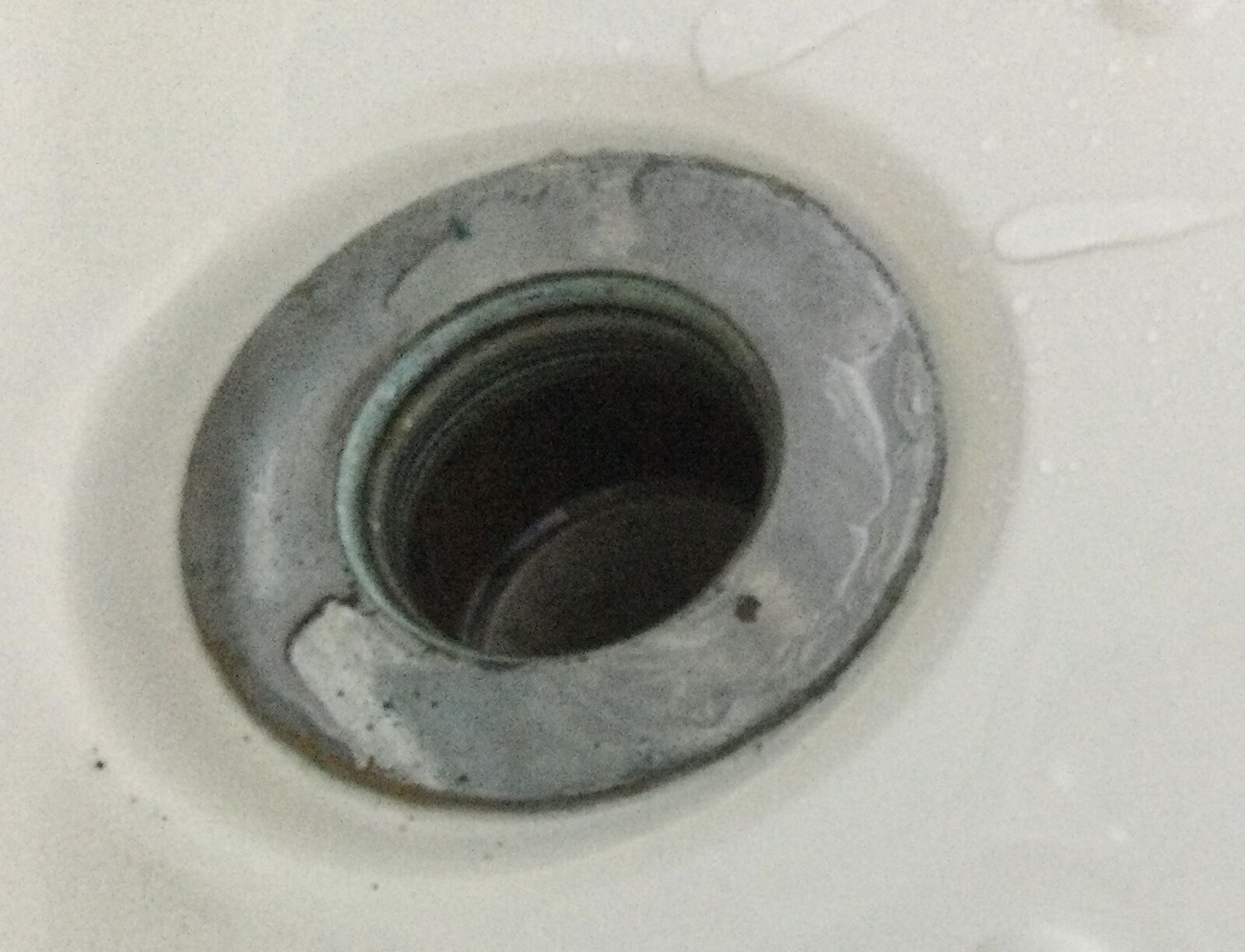

Hi. The drain in our upstairs shower has started gurgling and although I can’t access the p-pipe, I can see that it is clear. My next step was to check the venting but I’ve no idea where it might be. 158454E5-009A-4713-893C-B16CF07FAA6F.jpegHave checked other water facilities but the only gurgling comes from the shower drain. Any ideas??
Depends why it's gurgling. Does this happen during/or immediately after use? Could be the pipe is becoming partially restricted with soap/hair/detritus, and causing it to create slight suction as the pipe is now running full (available) bore causing a vacuum behind the water.
Or, does it gurgle when other appliances are used, e.g. the WC is flushed? That may indicate something is amiss downstream, and pressure in the system looking for a way out. Need to know a bit more about where the shower drain too please, and if there is no visible vent on the roof, you would then be looking for an Air Admittance Valve either in the loft or possibly boxed in in the bathroom.

Can’t see the actual pipe but can see from the drain shown in the pic above that the p-pipe part is completely clear.

Immediately after use suggests it just 'settling down' whilst it may be annoying, provided there is are no nasty odours causing offence then I wouldn't worry too much.
Air Admittance Valve (AAV) may well be concealed behind panelling, is there a boxed in section about 6" square in a corner of the bathroom, usually near the WC? That would most likely contain the soil pipe, AAV (if there is one) will be on the top of the soil pipe.
Gurgling has stopped completely. Thank goodness because I couldn't find an AAV anywhere. Thank you so. much yet again.
