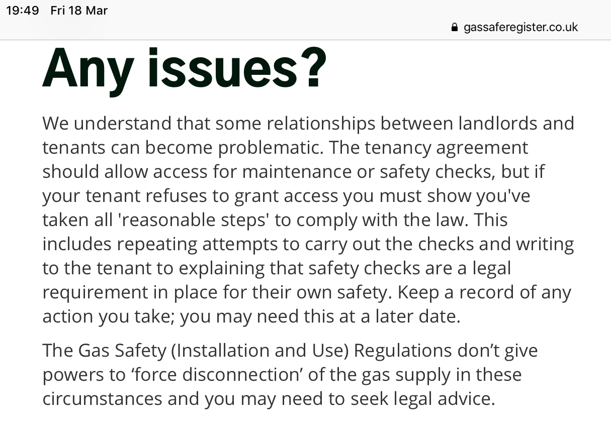

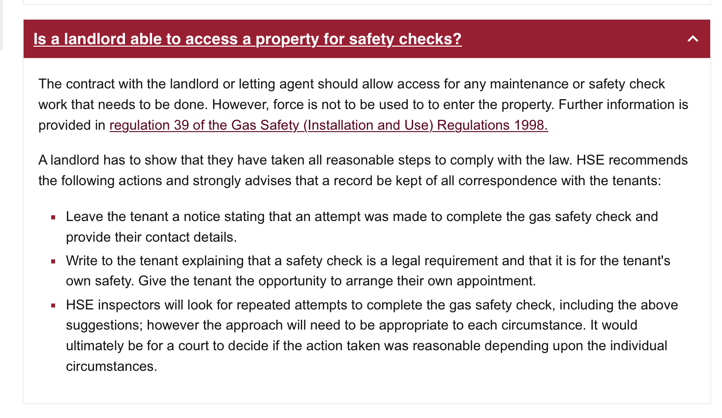

Gas bloke wouldn't have gone "to cap her off", he'd have gone to do a safety thing. Has she got hold of the landlord? They tried to get her, she DOES have to allow access.
There’s no mention of a legal letter, which, afaik, the landlord has to obtain prior to capping, especially if she has a valid certificate. We get it all the time. Sympathy lies with neither, as I work in housing.
legal letter ??? Explain what you mean
Afaik the reason they capped the gas is because they could not gain access to issue a valid certificate ???
Yes, they have to apply to the court to either gain access or gain access/cap it. It doesn’t matter if the certificate has expired, landlord has to apply to gain access.

I’m in agreement, and the landlord does have the law on it’s side, however, they still need to pursue the legal avenue. We also cap external meters, which usually gets us access, as going to the court costs money.
The only gas people with rights of entry afaik are the esp, eg Cadent.
Have a look at these attachments

It’s the same as turning off an appliance or gas escape, seek permission, but ultimately we as gas engineers do not have the power to cap, neither does the landlord.
At the end of the day if they went to court to gain entry into the prop they could have serviced / checked the boiler any way :confused:o_Oo_O
