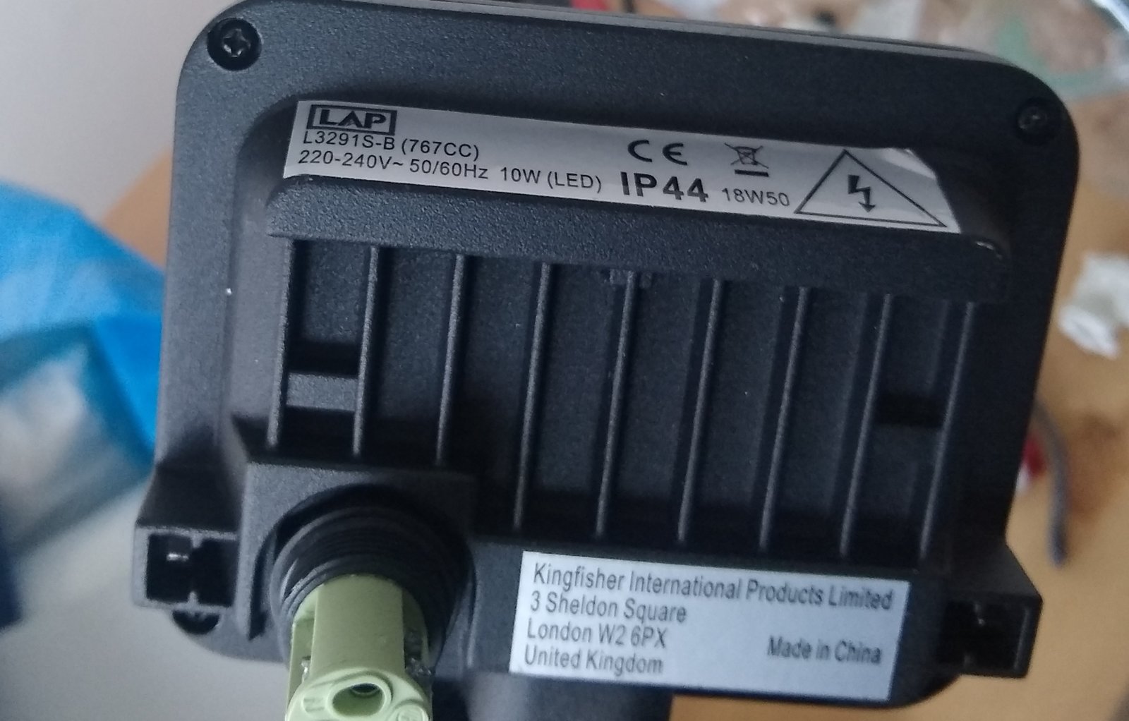

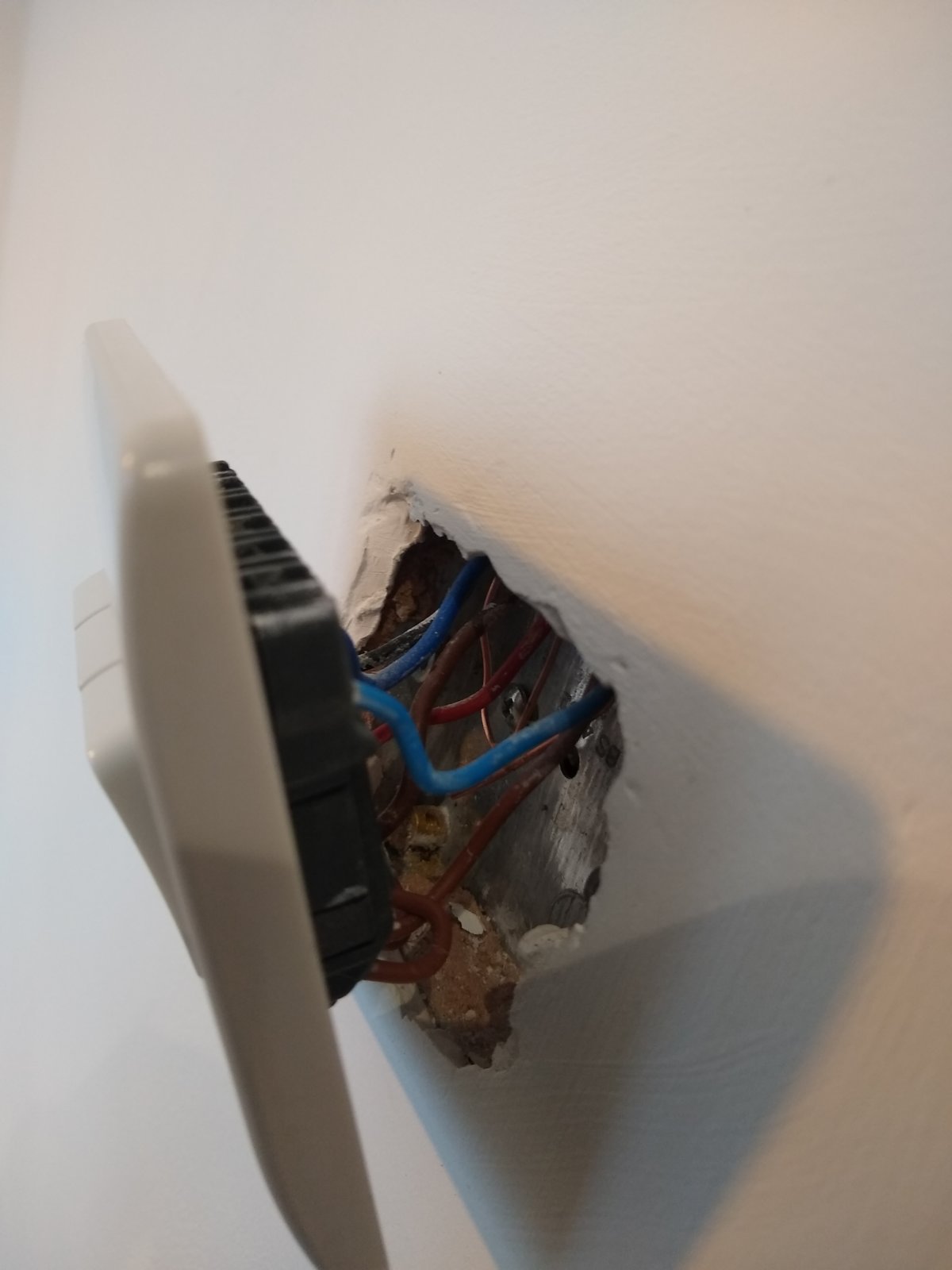

I am fitting an outside securty PIR light
The PIR light is wired directly to a 3 gang switch in my kitchen
I have connected the light as follows
The neutral is connected to L1 and the Live is connected to the COM. I then placed a tiny bit of brown (live) wire in between the COM from the other light fittings in my kitchen and the outside PIR security light
There is power going to the PIR light, but it does not light up..
I assumed that the actual light may have been faulty so I changed this, but still no luck
Any suggestions

Neutral needs to be connected to the neutral, not the switched live.
Are you saying that the brown cable (which is wired from the light directly to the switch) should be in the L1 terminal on the switch?
And that the blue wire, which i have placed in L1 should be in the COM terminal?
Please note that i have two other light fittings wired to the switch and the brown wires are in the COM terminal?

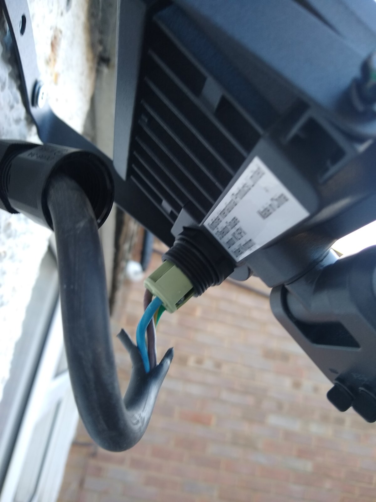

Just looked at picture 3, UGH. That cable has too much sleeving cut off, the clamp when you screw it up will never waterproof it.

Basically permanent live goes to com in the switch, connect L1 on the switch to brown on the light, that is switched live. Also connect blue on the light directly to neutral which may not be present in the switch. Connect green yellow in the light to earth.

Thank you. Just to clarify
L1 = Brown Wire
Brown wire = Live on Light fitting
Blue = Neutral on Light Fitting
My switch is a 3 gang and only has COM and L1 and L2. So what should i do with this blue cable in the switch?

If the blue cable is the light's neutral, and you don't have a neutral at the switch, then you'll have to find somewhere else to connect it.
Your lighting is probably loop at the ceiling rather than the switch, so the switches only have live and earth.
