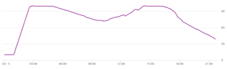

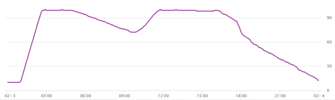

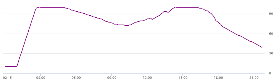

All in all, yes, the heat pump has been better than the vented, but not by a huge margin. Had the hole been already bored, when the first one failed, would have likely returned to vented. The main problem is selecting when to run the machine, mainly it is state of charge of the solar inverters battery 1738791378330.pngeach day I have 5 hours at off-peak at 8.95 p per kWh, then the battery starts to discharge, around 9:30 am on a good day shown here, the solar starts to come in, and by 11:45 the battery is full again, but by 16:15 the solar starts to reduce, and one wants to ensure the washing machine, tumble drier and dishwasher are all finished by then.
The shorter time of a vented drier and higher power use, means the 2.3 kWh I exported on the 3rd of Feb could have well been less.
So it is not just how much power is used, but when the power is used, today 1738791974073.pngI am sure I will run out of battery before midnight (10% held back for UPS power to central heating).

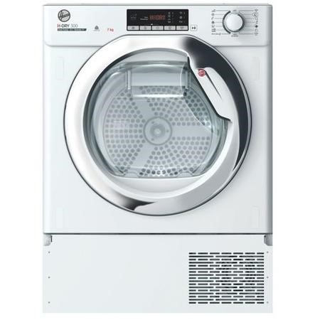

Integrated?
Hoover make an integrated heat pump dryer.
